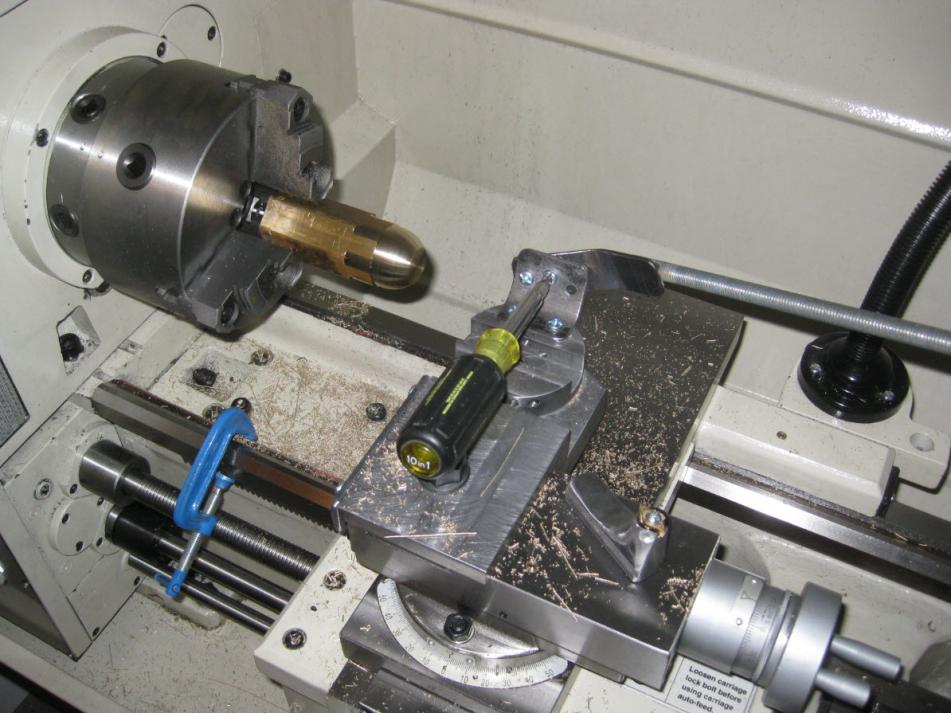

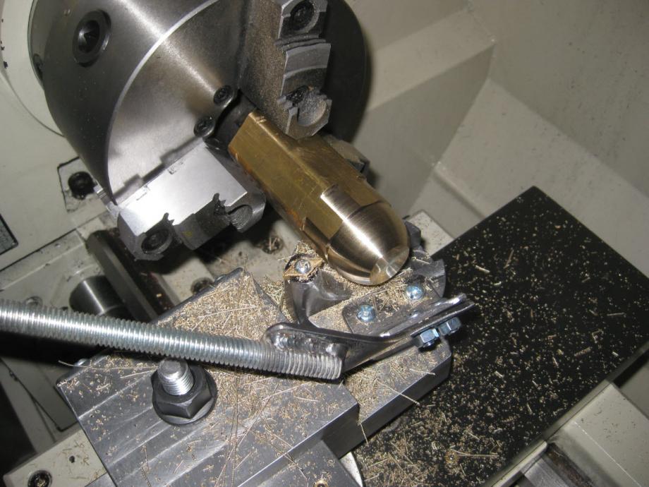

    I have seen Lathe Radius Cutting or Ball/Knob Turning units online and wished to make one for myself.
    Wanted one that was quick to mount ... and also quick to take off ... so I could easily use my lathe's normal quick-change Tool Post for some of the processes when making items.

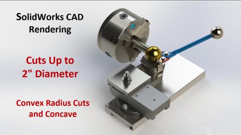

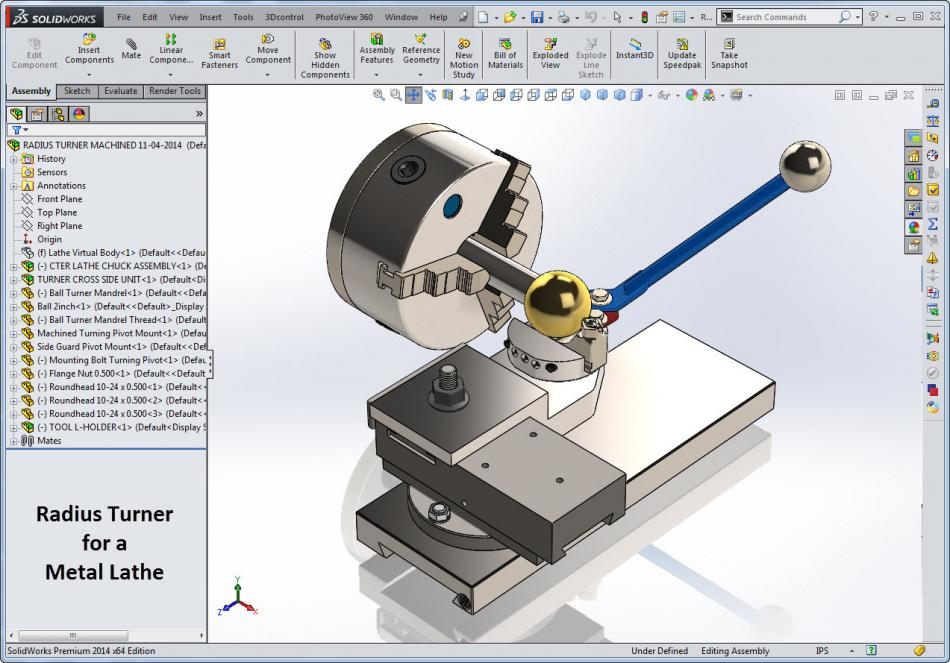

    Used SolidWorks CAD software to come up with a 'Mounting Design' that only uses 1 Nut to mount the Radius Turning Unit
    The Handle unbolts and flips around so Concave as-well-as Convex radius cuts can be made.

    The handle is temporary and I will use the first test part as the knob for the final handle. Probably will make other changes over time but this works for now.

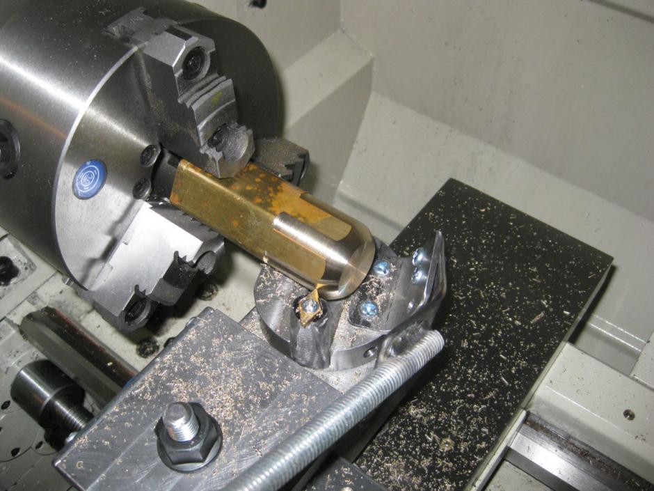

    One unexpected surprise was I found I could also make straight cuts fairly easy holding the handle steady and moving the carriage. Helpful for touching off areas and not having to mount my normal Tool Post tooling.

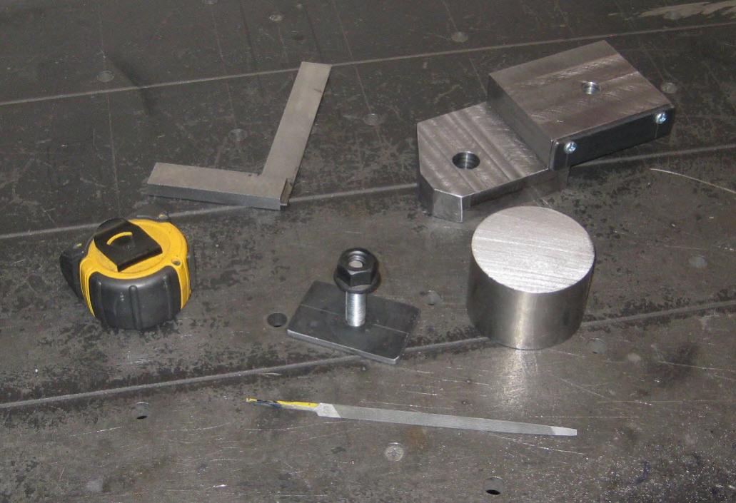

    With the single nut mounting design it only takes about 45 seconds to remove my tool post and then mount this Radius Turning unit with the one bolt. Very stable because it also locks around on two edges of the mounting area.

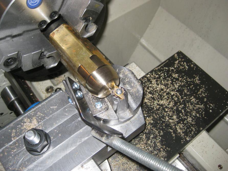

    Here is a Link to a Video that Shows the Concept and making of the first test part:
    It is certainly nothing Fancy, but good enough for my projects and what I could come up with by welding together (and then machining on the miling machine) some 1/2" flatbar I had in the scrap-bin.

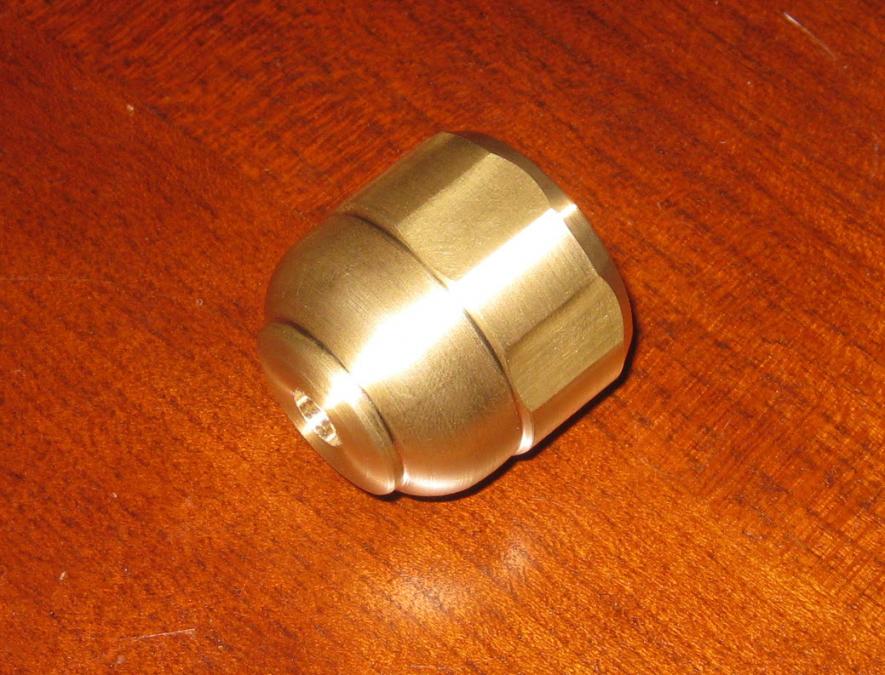

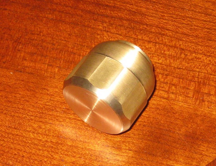

    Here are some close-up photos of the first Brass Knob created using the radius turning unit.
    Added the SolidWorks Files to GrabCAD.com
    https://grabcad.com/library/ball-knob-radius-cutter-1

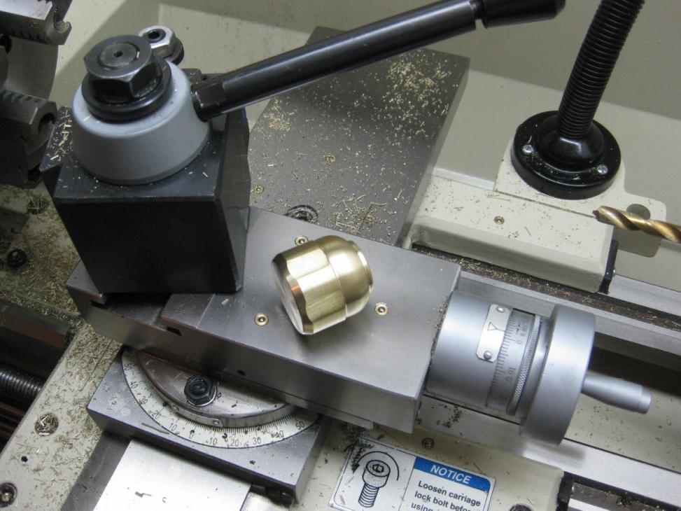

    Liked the first 'Test' brass knob so ended up putting it on my new Lathe's Tool Post handle.

    THANK YOU ... Usually the words "Tool of the Week" associated with my name refers to my attitude that week *grin* ... Will have to think about what color shirt ~ White? or Black?
    Ended up using the 1st test part Brass Knob on my Lathe's Tool Post Handle... Handle was metric thread, so I used the lathe to cut about an inch off the handle length and thread it for 3/8-16.
    The new image with the Brass Handle Knob on the Lathe can be seen at the bottom of the webpage Post at:

    Here is a Photo Link for the experimental Radius Cutters 1st Test Part brass knob on my Lathe's Tool Post Handle.
    (CLICK HERE TO SEE PHOTO)
    Certainly, not a new design for Radius Cutting on the Lathe, but a new personal twist of 1 nut/bolt mounting for my new lathe.
