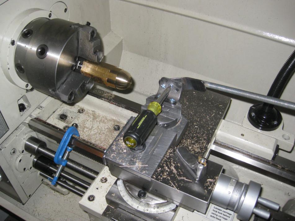

Wanted one that was quick to mount ... and also quick to take off ... so I could easily use my lathe's normal quick-change Tool Post for some of the processes when making items.

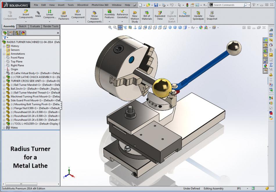

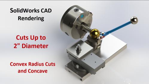

Used SolidWorks CAD software to come up with a 'Mounting Design' that only uses 1 Nut to mount the Radius Turning Unit
Attachment 2215
The Handle unbolts and flips around so Concave as-well-as Convex radius cuts can be made.

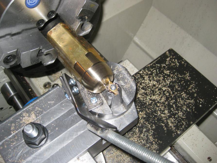

The handle is temporary and I will use the first test part as the knob for the final handle. Probably will make other changes over time but this works for now.

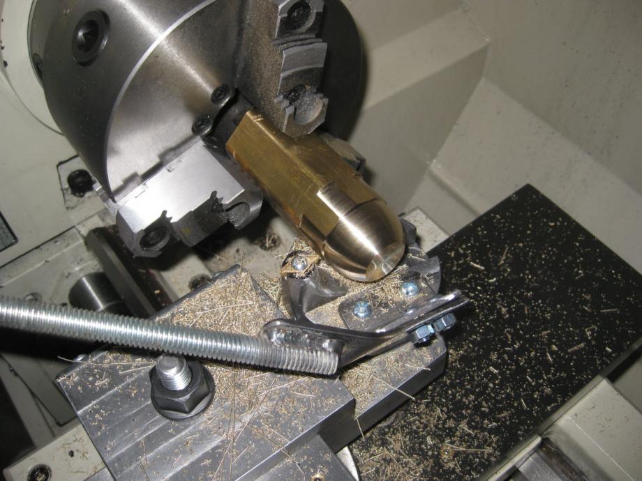

Attachment 2217

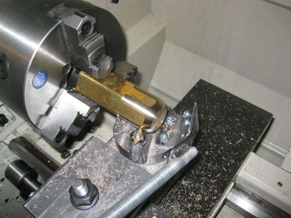

One unexpected surprise was I found I could also make straight cuts fairly easy holding the handle steady and moving the carriage. Helpful for touching off areas and not having to mount my normal Tool Post tooling.

With the single nut mounting design it only takes about 45 seconds to remove my tool post and then mount this Radius Turning unit with the one bolt. Very stable because it also locks around on two edges of the mounting area.

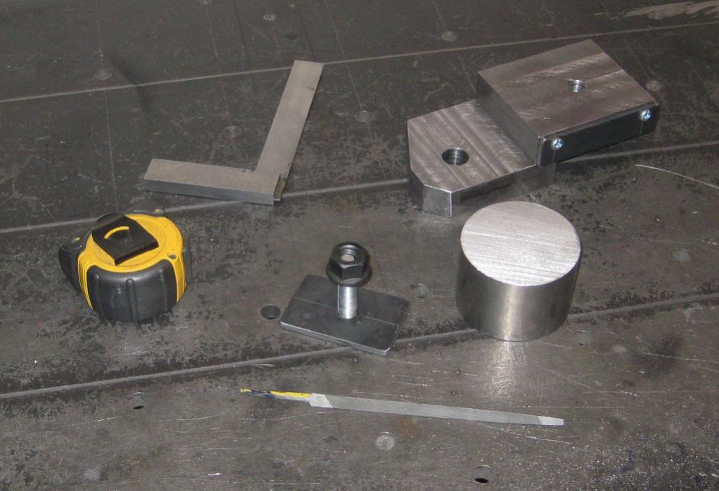

It is certainly nothing Fancy, but good enough for my projects and what I could come up with by welding together (and then machining on the miling machine) some 1/2" flatbar I had in the scrap-bin.
Attachment 2219

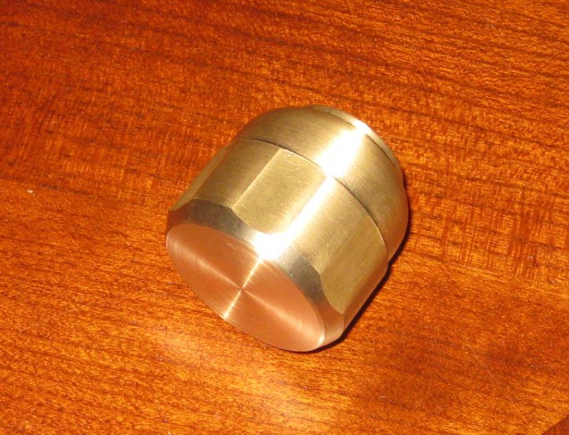

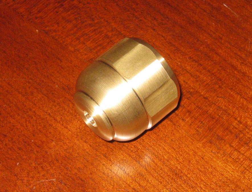

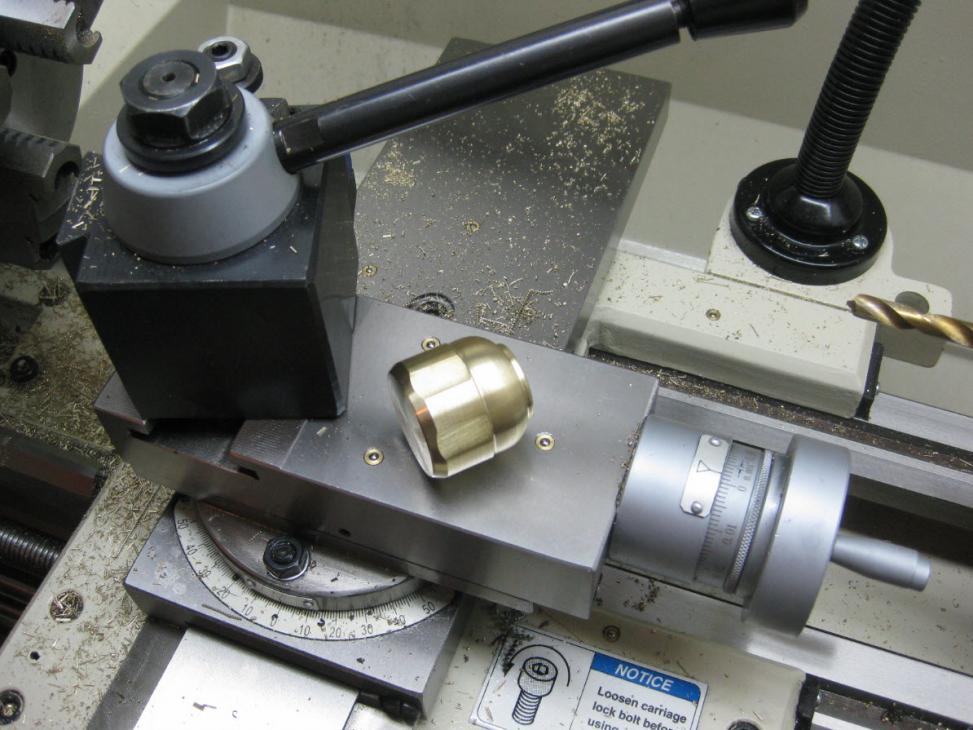

Here are some close-up photos of the first Brass Knob created using the radius turning unit.
Attachment 2221

Liked the first 'Test' brass knob so ended up putting it on my new Lathe's Tool Post handle.
Click Here to See Photo
