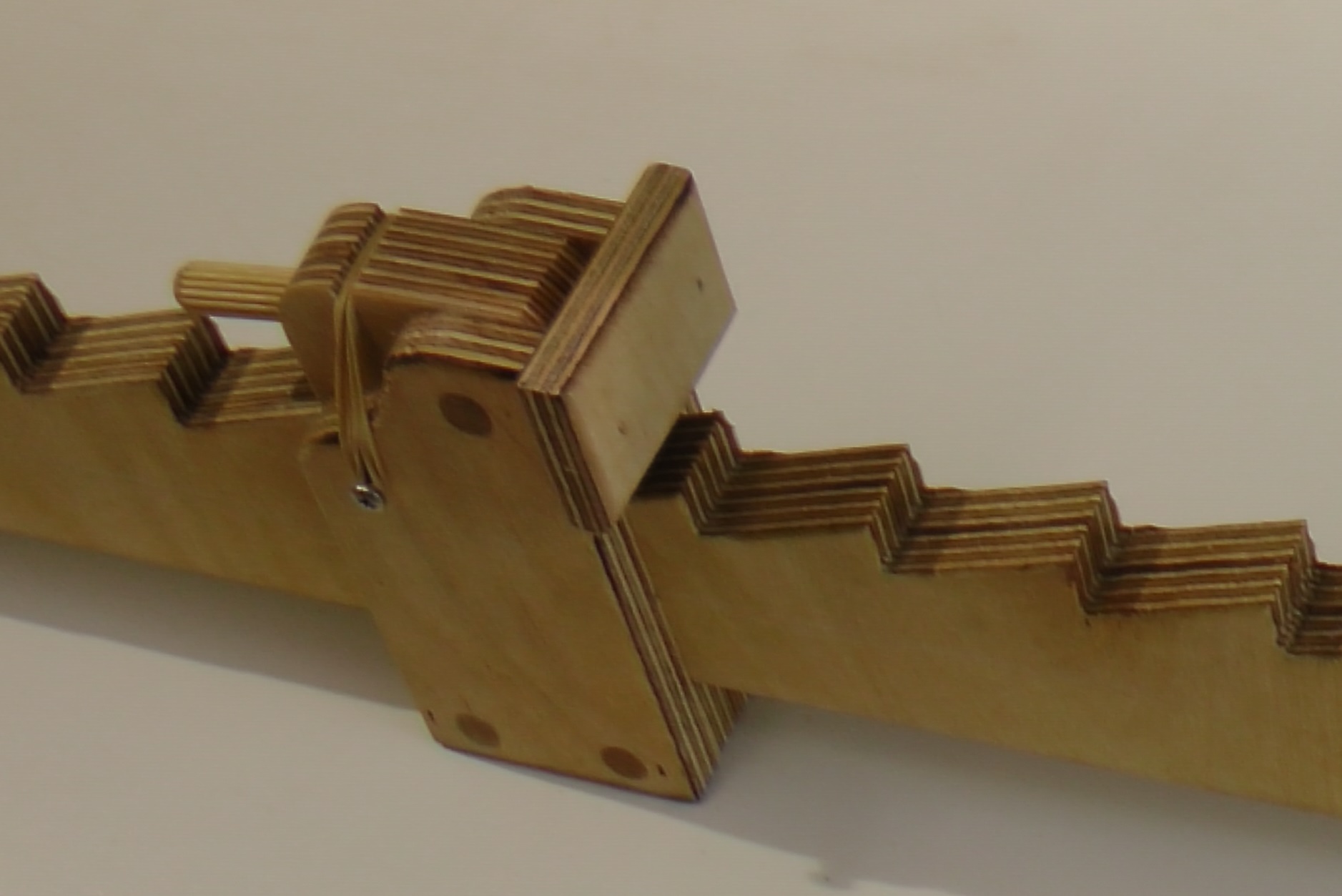

    I wanted to try to make a clamp from mostly wood (except for the threaded rod of course)
    So I made this Ratchet Bar Clamp from a 3/4" baltic birch plywood bar, and notched it like a sawblade.
    I could then make the sides of the sliding tail stock from 5/8" baltic birch plywood, and a lever for a movable stop.
    The stop lever for the notches are spring loaded with a rubber band.

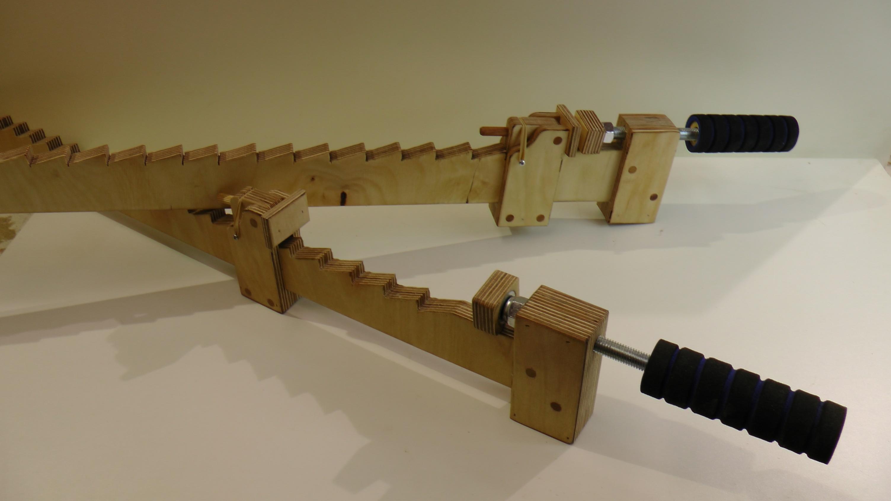

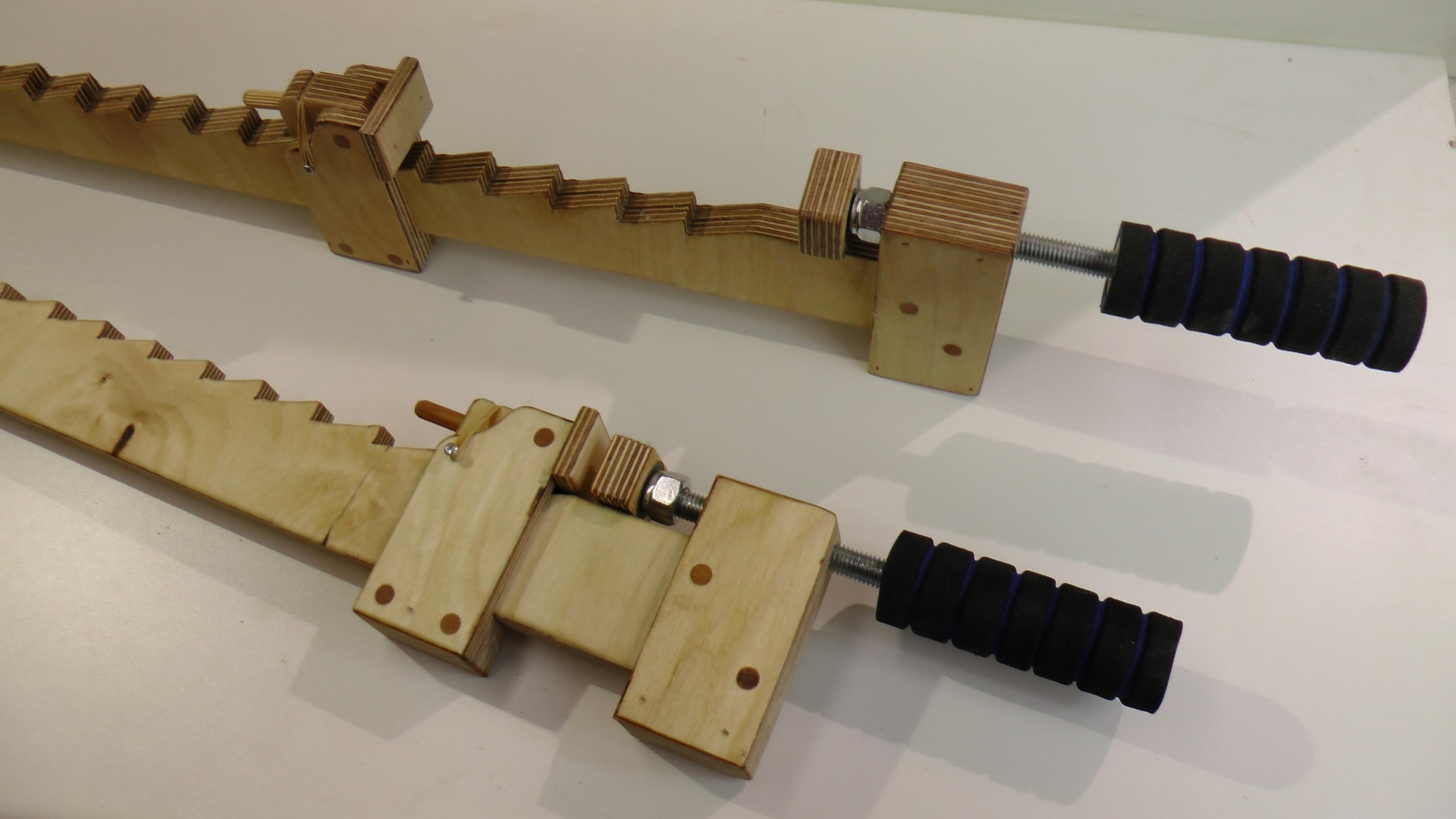

    The head stock (with the threaded rod) is also laminated from 5/8" and 3/4" BBP, and pinned with dowels
    I tapped the threads directly into the wood, and this far it still works great after plenty of use.
    I lubed it with some candle wax. If it strips, I just insert a T nut.
    The handles are made from 1" wood dowels with foam bicycle handle grips on it.
