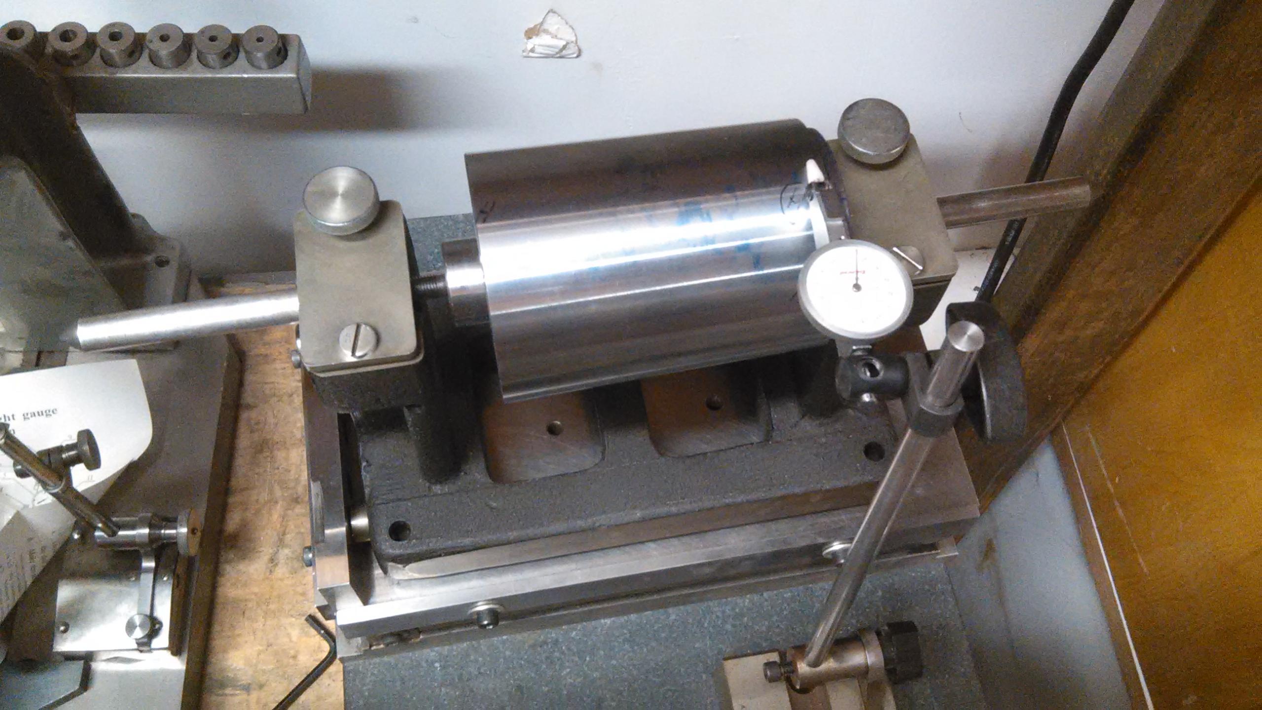

    I also got a short 4MT drill chuck arbor, and was able to mount the sleeve between centers of my newly acquired bench center on a sine plate (also newly found). As the assumed angle was a 1:20 taper, I put a .25" gauge block under the bar of this 10" center sine plate. 1:40 would be the tangent angle, which solving for sine was a 0.249919 gauge block, I figured .250 is close enough.
    Counting the clicks difference between the 2 ends of the taper sleeve, I found an error of 0.0057". This explains my 0.0045 runout of this sleeve installed in my lathe spindle.
    I had to make a tool for this setup (the gauge block spindle), as the gage block (purchased used recently with no spindle or snug) has a snug for 1/4", and my indicator snug wanted 10mm, so I cut off a piece of 10mm O2 drill rod (just happened to have that bastard size), and turned down 3/4" of the end to 1/4" diameter. Which I don't count as tool making for real. More cobbling for lack of tools.
    Runout measurement was 0.01mm or about 0.0004".
    Next is to put this sleeve in my lathe, and be able to drive torque to either tool bit cut, or easier to tool post grind. But .005 grinding of material removal is several passes.

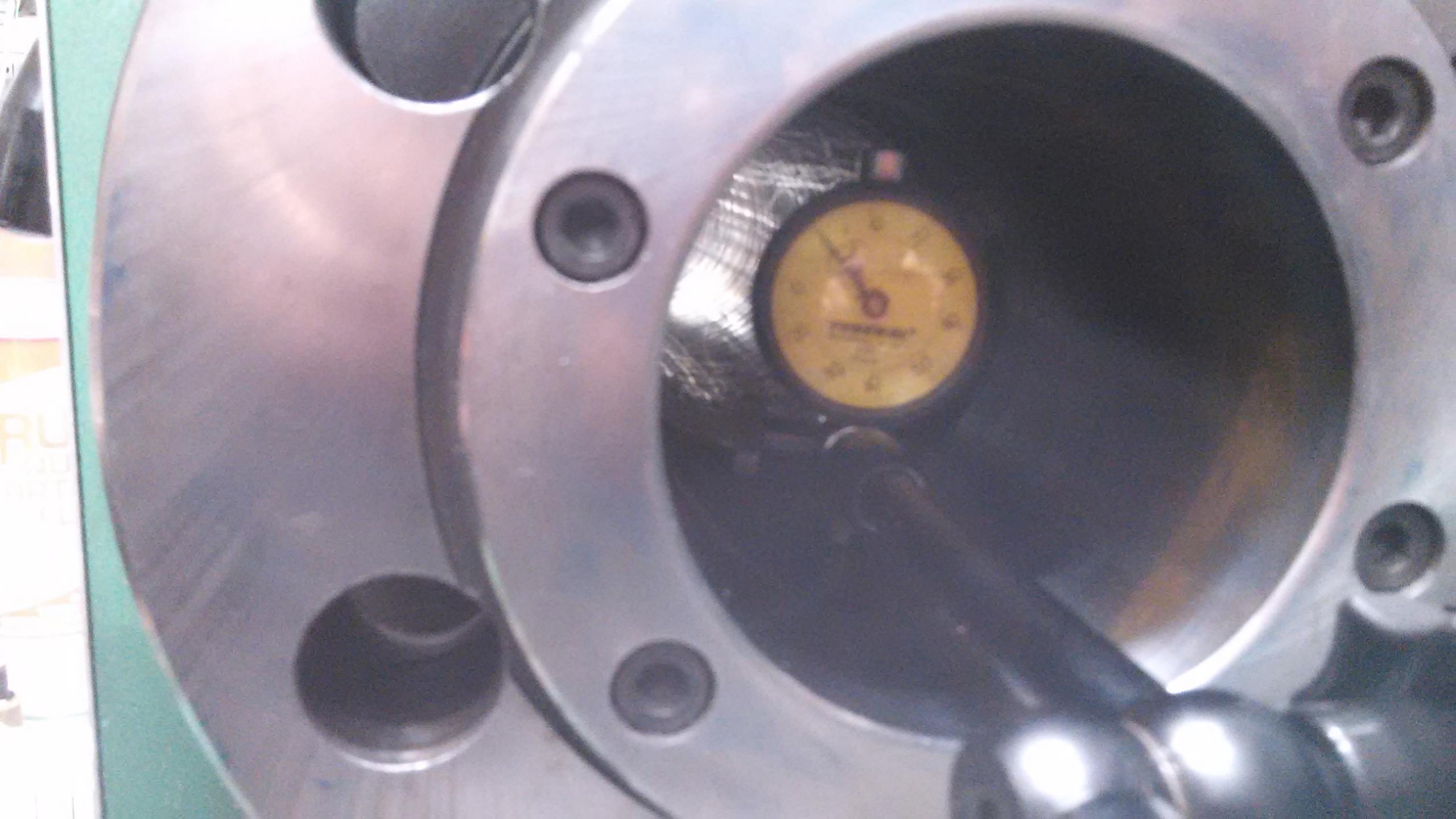

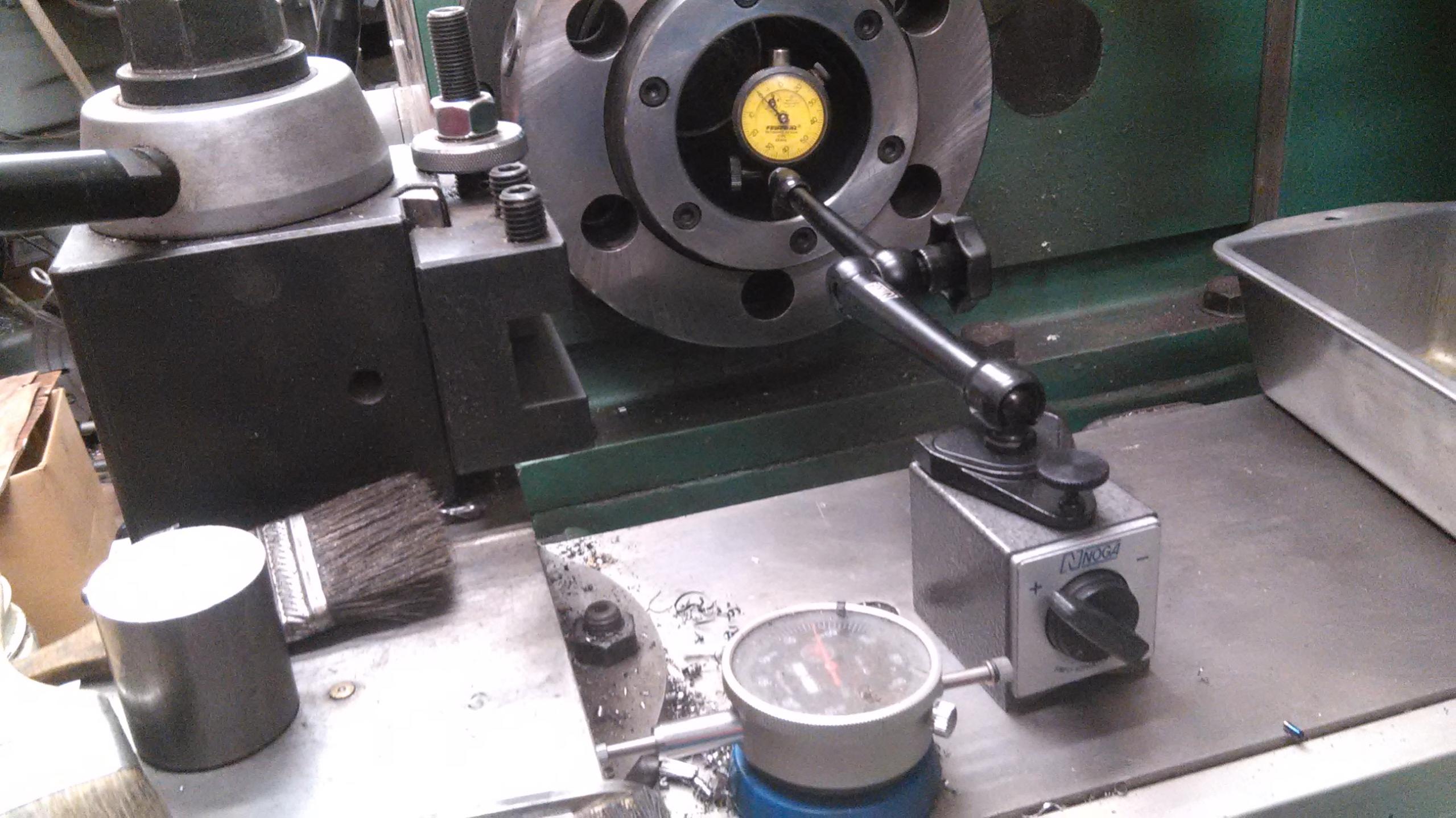

    I did not like the accuracy and repeatability of measuring the taper angle of the lathe headstock. Also the snug was in the view of the dial. After reading a few reviews of indicator holders. I sprung for a Noga. It makes every other holder now junk in the shop. This thing is rigid. I have 2 different size knockoffs of this, and they are too compliant just from the indicator spring forces. As well the magnetic block is so poorly made they rock on a flat surface. The Noga with zero adjust at the base just made the setup quick and non irritating.
    Repair guy-2017-03-29-noga-indicator-holder-014.jpgRepair guy-2017-03-29-noga-indicator-holder-002.jpg
    The lathe has a DRO on the carriage and cross, so I was able to reference the indicator location, with it's taper measurement.
    As I believe the head stock taper is a 90mm gauge line, metric taper of 20:1, I found that at 40 mm, the indicator shown 1.008mm, and at 80mm, 2.020mm (which are half angle measurements). The indicator is .01mm resolution, but my eye can interpolate a bit better. So the headstock taper is off by just a tiny bit, as it should be 1.000mm per 40mm travel. I probably will leave that be.

    I was able to make the measurement of the lathe spindle taper, and this sleeve. The sleeve has a consistent taper angle, it needs to have this angle corrected for the lathe. The lathe taper is off by 0.01mm/40mm (it should be 1.000mm per 40.000mm). But I need to verify that using a different dial indicator, as the one I used may have error.
    For sure, I need to fix the sleeve to match the lathe taper, as it sits with 4 inches of mating surface. Too many other projects in the que (hanging drywall, so I can hire a finisher on a 10 year old project, and I'm not getting younger).
