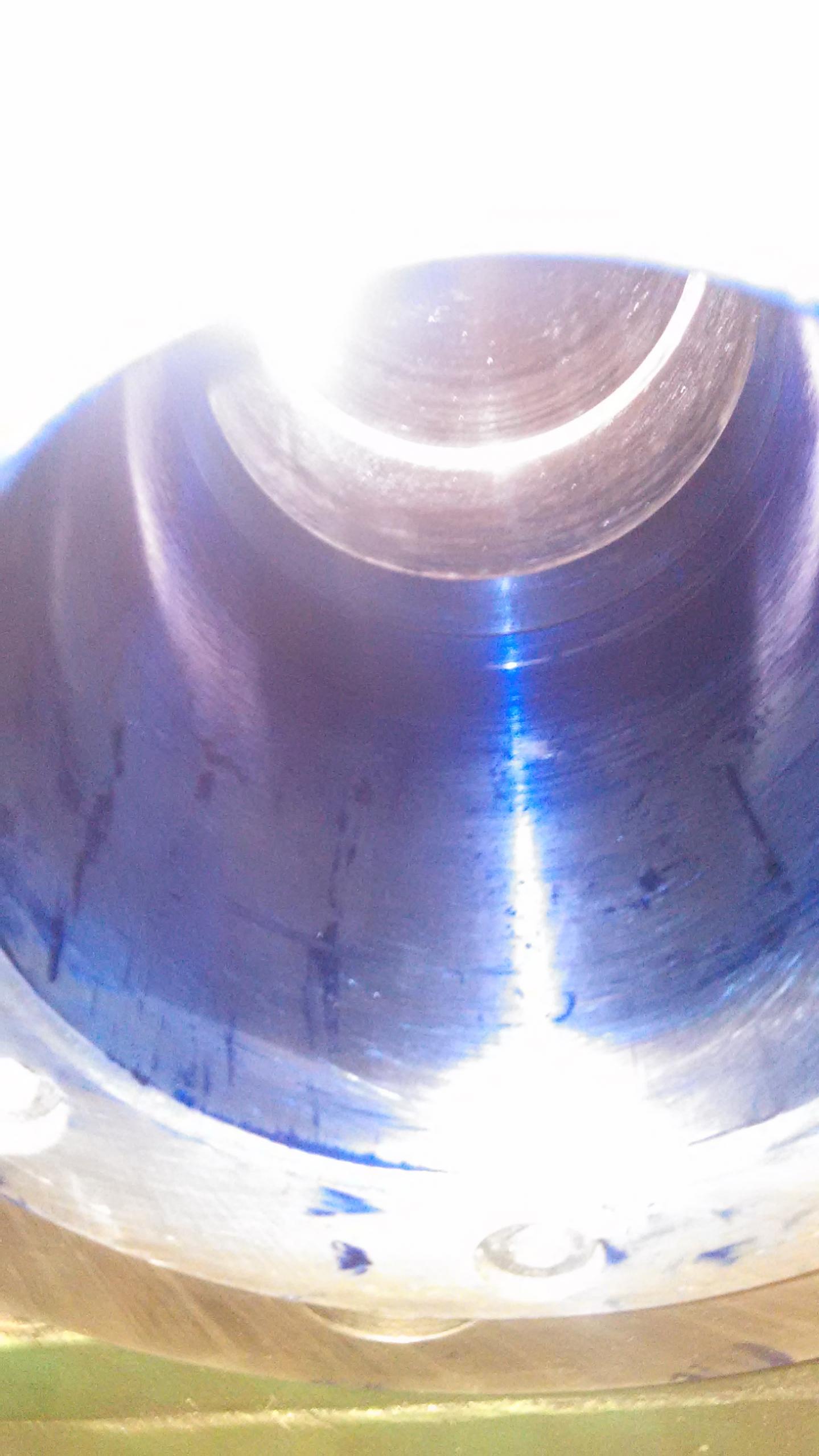

Photos of lathe spindle hole and center adapter sleeve
The lathe does have a taper attachment, but it needs some gib and other adjustments to work smoothly.

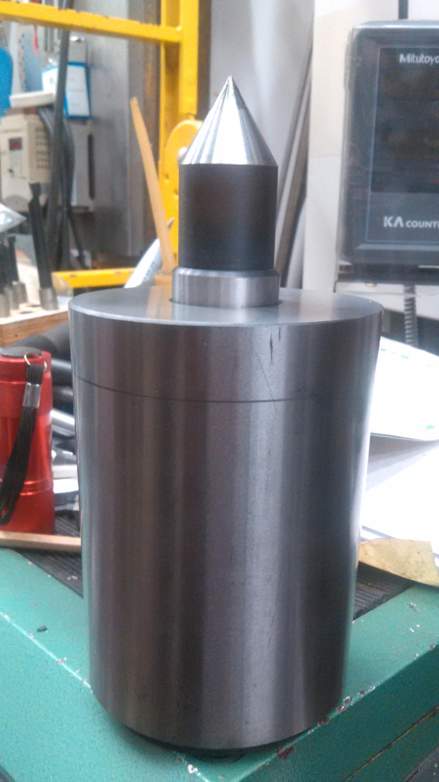

The existing sleeve that adapts the 4MT center to the lathe spindle
Attachment 17047

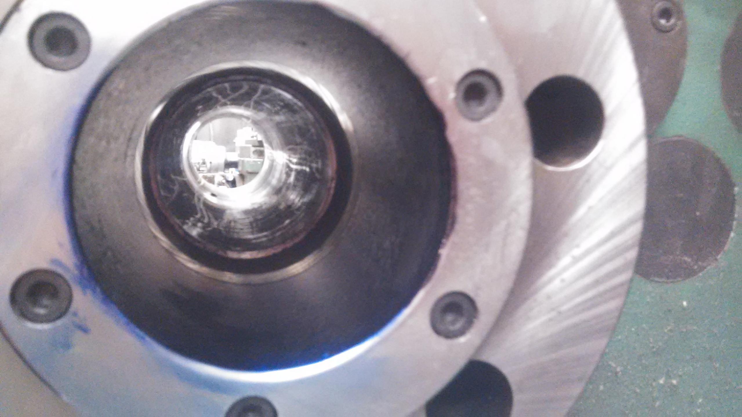

This spindle is a D1-8 chuck mount.
Attachment 17048

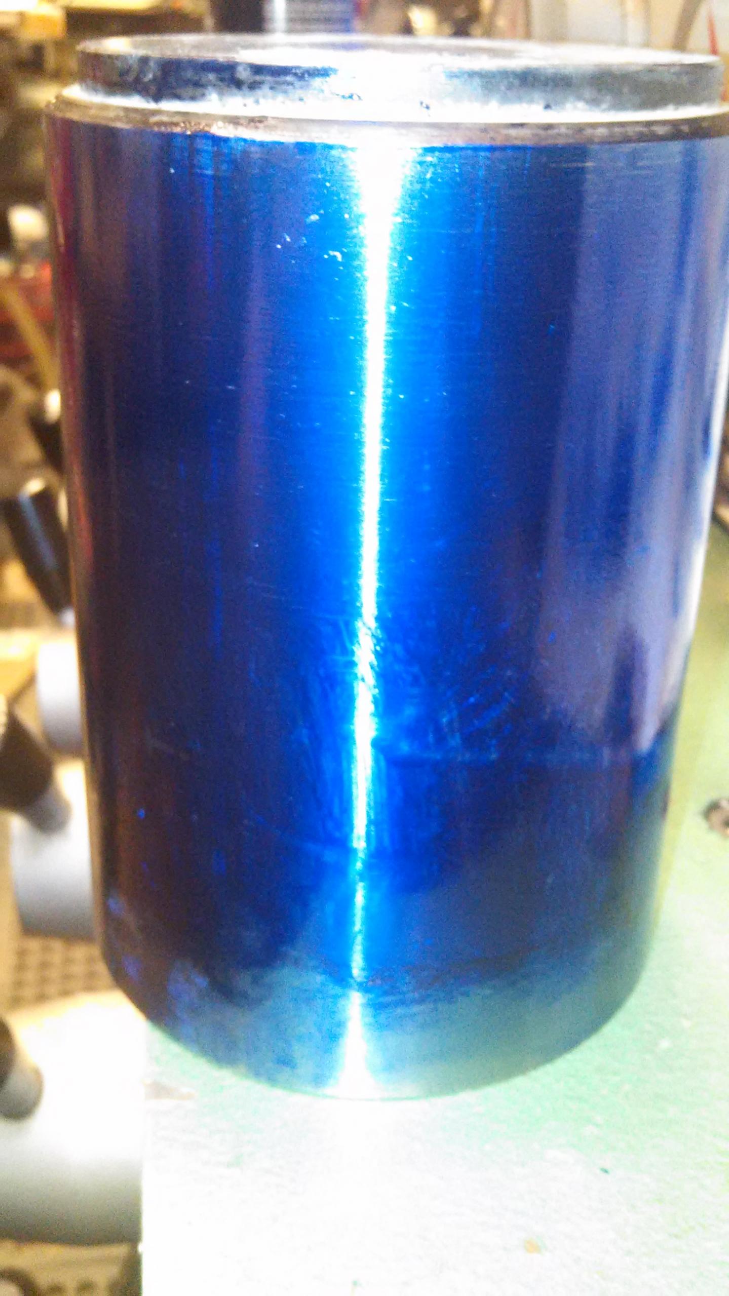

I over applied the Dykem Hi-spot, but the sleeve was only contacting at the bottom of the taper.
Attachment 17049
The sleeve. I did over apply the hi-spot, to where it acted like a grease and prevented the taper from locking.
