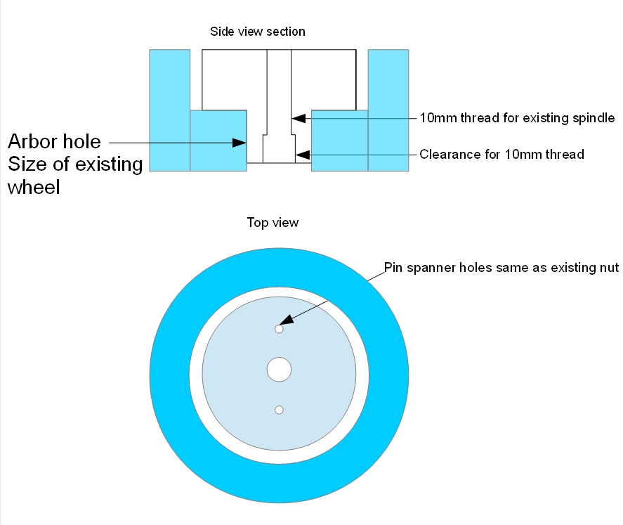

I can't find any metric wheels for this. But I can make a simple adapter nut to use a straight cup recessed wheel with a SAE arbor size. Something with a 5/8 or so hole, just needs to be bigger then the 10mm to allow enough annulus for a 10mm thread, 1/2" or bigger (too close to 3/8").
The blue color is the grinding wheel, the nut can stand proud of the wheel, and have flats vs the pin spanner wrench holes. Either one requires milling machine work.
Attachment 17064
Sorry I'm using OpenOffice Draw to make this diagram. I do miss AutoCAd from work, but to pricey, and I don't do much line drawings outside of pencil sketches for my use. I could not figure out how to do shading of a line drawn area. So the side view the nut is white, but the top view it's blue gray. First time I've tried to use this tool. The tool lets you fill a hashed color for the donut object, but not a box, go figure.

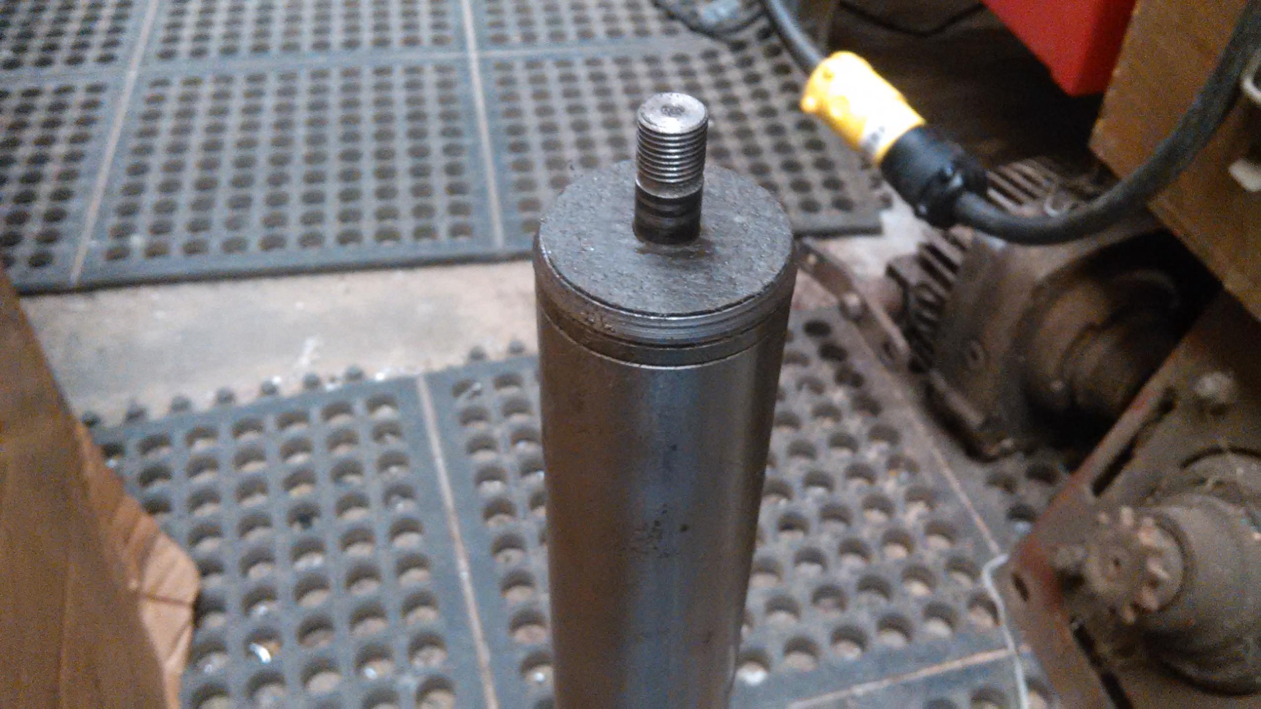

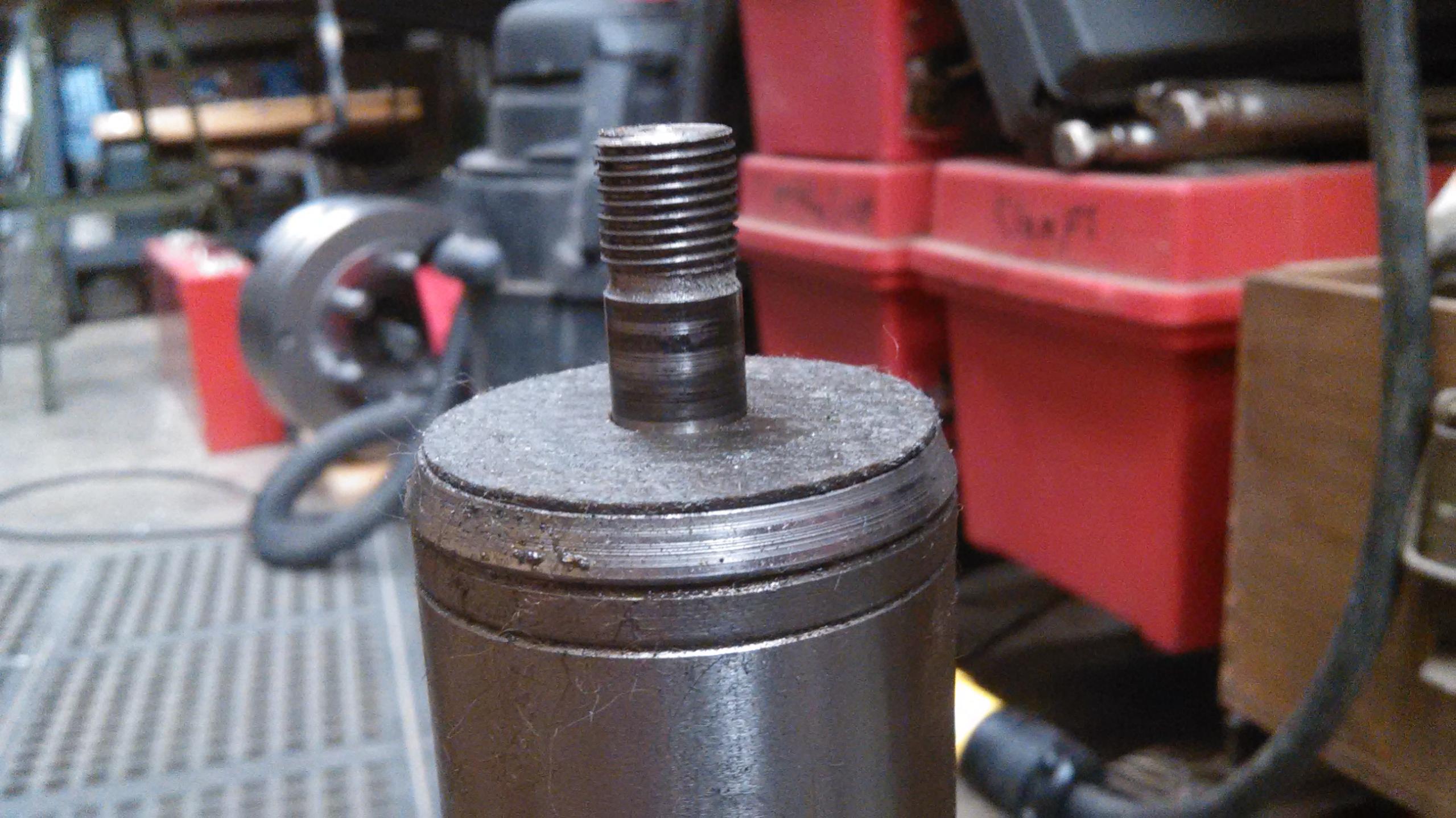

A photo of the ID TPG arbor:
Attachment 17072
This arbor is 10mm diameter.
Attachment 17073

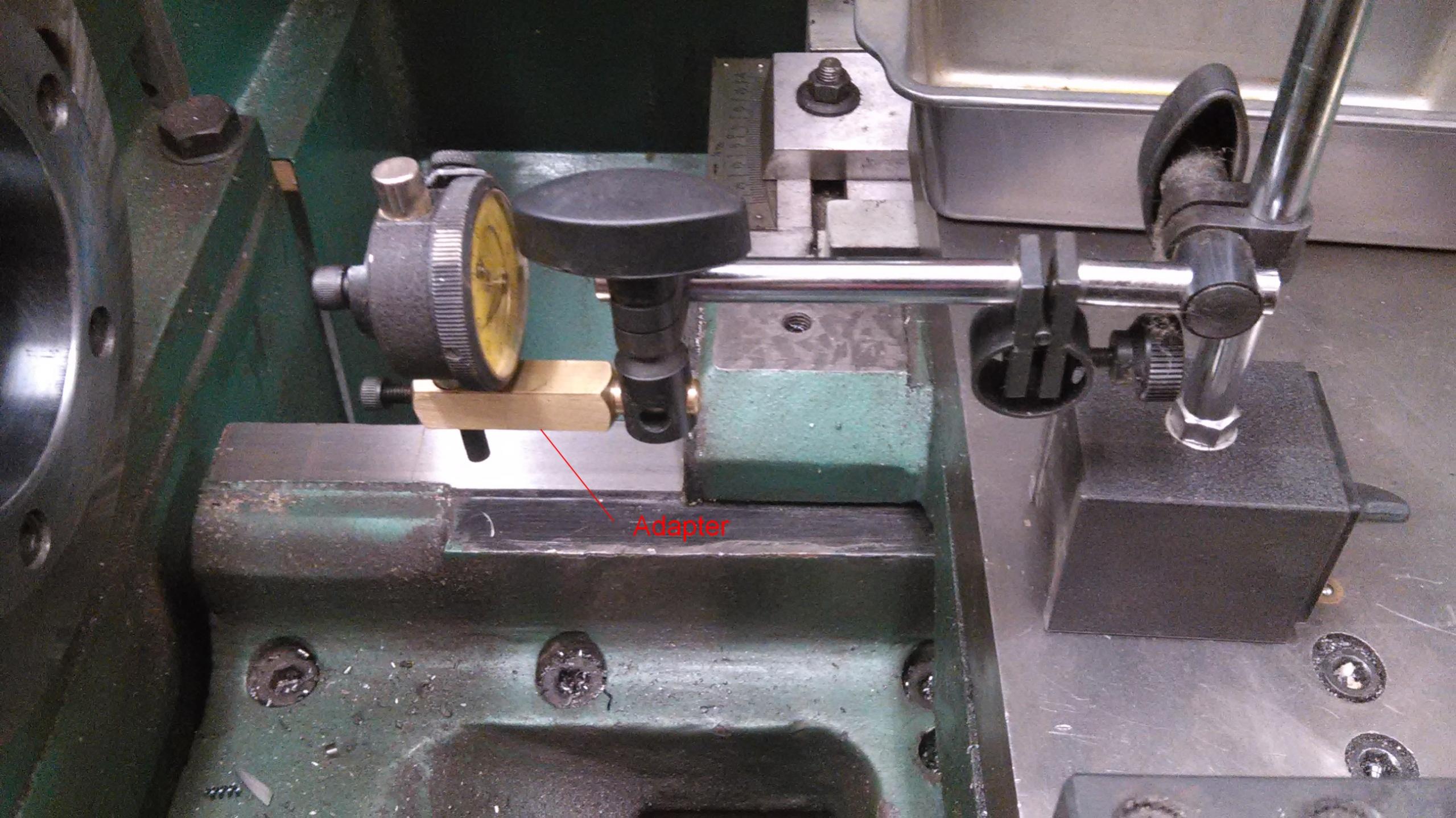

I didn't get much done today, but will spend the evening making an indicator holder to see if I can get an accurate enough measurement of the spindle taper (I have a 1" size dial, Federal indicator .01mm resolution, short travel, that is short enough to fit inside the hole).

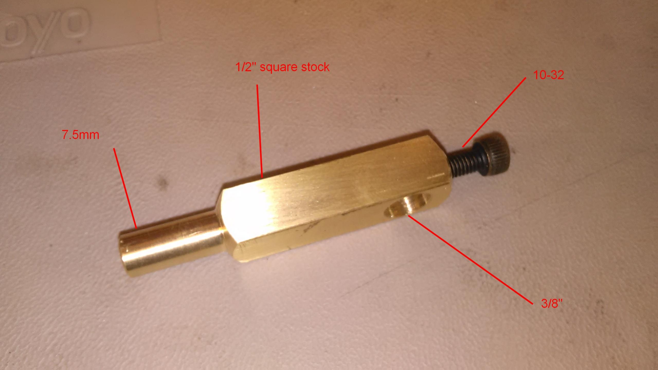

One of the tasks in fixing this was to measure the taper of the spindle. I have a Federal AGD 1 .01mm 6mm travel, that was small enough to fit inside the lathe spindle hole. I picked this indicator off eBay some time ago, but I never had any means to install it on any of my import DIN mag bases. All my AGD 2 indicators have a lug back, and so I can use the adapter that has a 7.5mm stud for attachment to the DIN holders. In this case these indicators have a snug between the 10mm extension arm and this indicator stud. I've tried to see if a snug between 3/8" and the 10mm exists, and had no luck. If I did find one, I would spend 3x what the cheep import holders cost me (or more).
So I made this adapter:
Attachment 17181
So here is the adapter setup to measure the spindle taper:
Attachment 17182
I was able to measure the spindle taper as 1:20, which is the double angle.
My measurement was at 40mm of carriage travel, 1.008mm indicator, and at 80mm 2.020mm. So I'm convinced this is a 90mm gauge line 1:20 metric taper. It may be off by a smidgen, or the setup of the cheep holder and angular cosine errors, as well the tip of the indicator not optimal for the surface.
If anyone here has a similar design for a AGD to DIN adapter, I could not find any examples by searching for DIN, AGD, indicator on this site.
My snug was in the way of the indicator, but I don't have any better snug then the one that came with this holder. I probably should have kept the brass square stock longer, but didn't want excess weight hanging out on the indicator arm.
