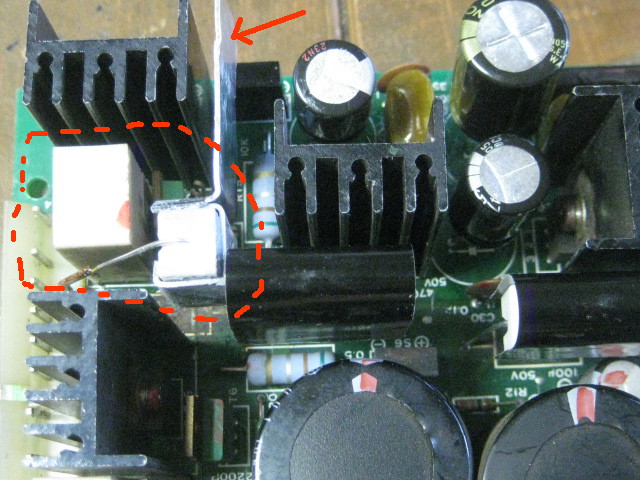

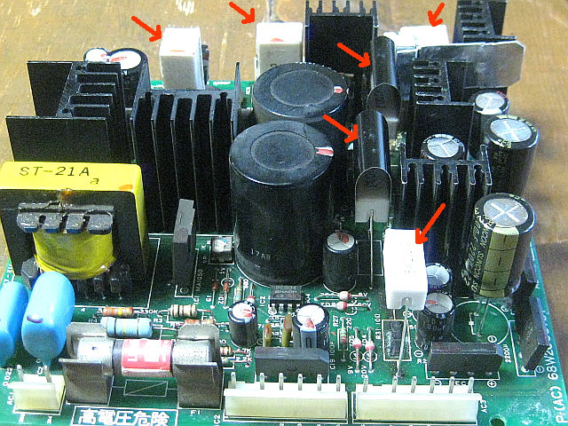

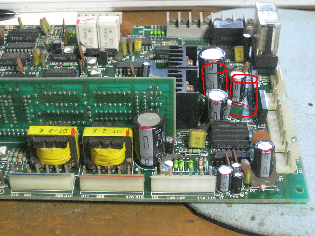

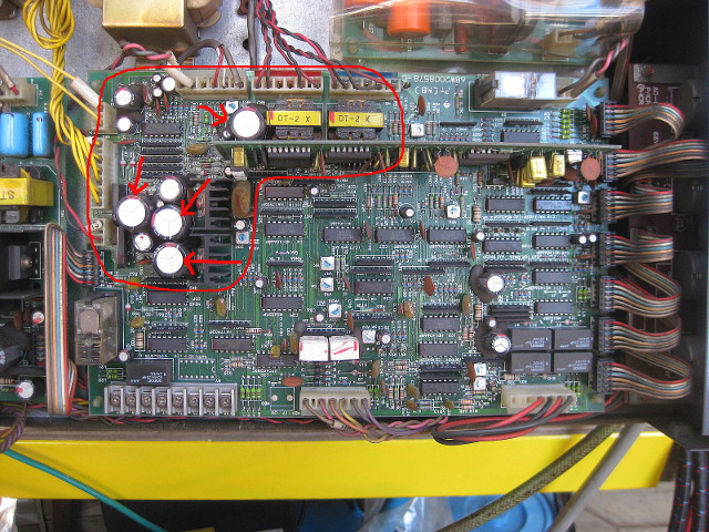

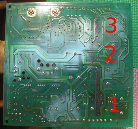

He said in the early models of this set-up, he encountered several cases of issues on a set of capacitors on the very limited area of the circuit board, the power supply board.
Attachment 23094
Area with red marking in above, and the said capacitors are the larger round stuffs with red arrows. He said these capacitors tend to get a lot of electrical stress when we use the welder in excessive duration of time with higher amperage, while others around them are not like that. Actually he showed me some data he has got when he has made examination on other capacitors, that tells the other stuffs have been working all right on this model.

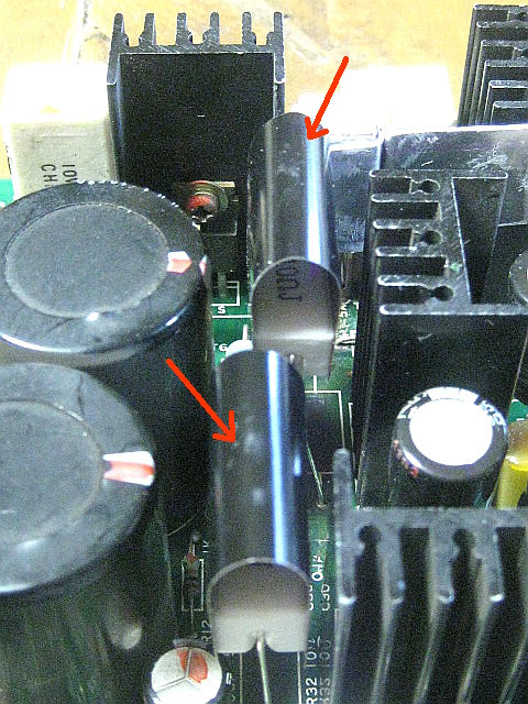

Attachment 23095
When I saw the top surface where you see the 'Y' marking above, these marking show no sign of distortion. (Incidentally in some bad cases this Y mark shows some rise upward, tells this part gets pressure inside. )
So I told him this fact, but he replied that still there is some possibility of deterioration in the capacitor which causes oxidation to the brazing area of the board.

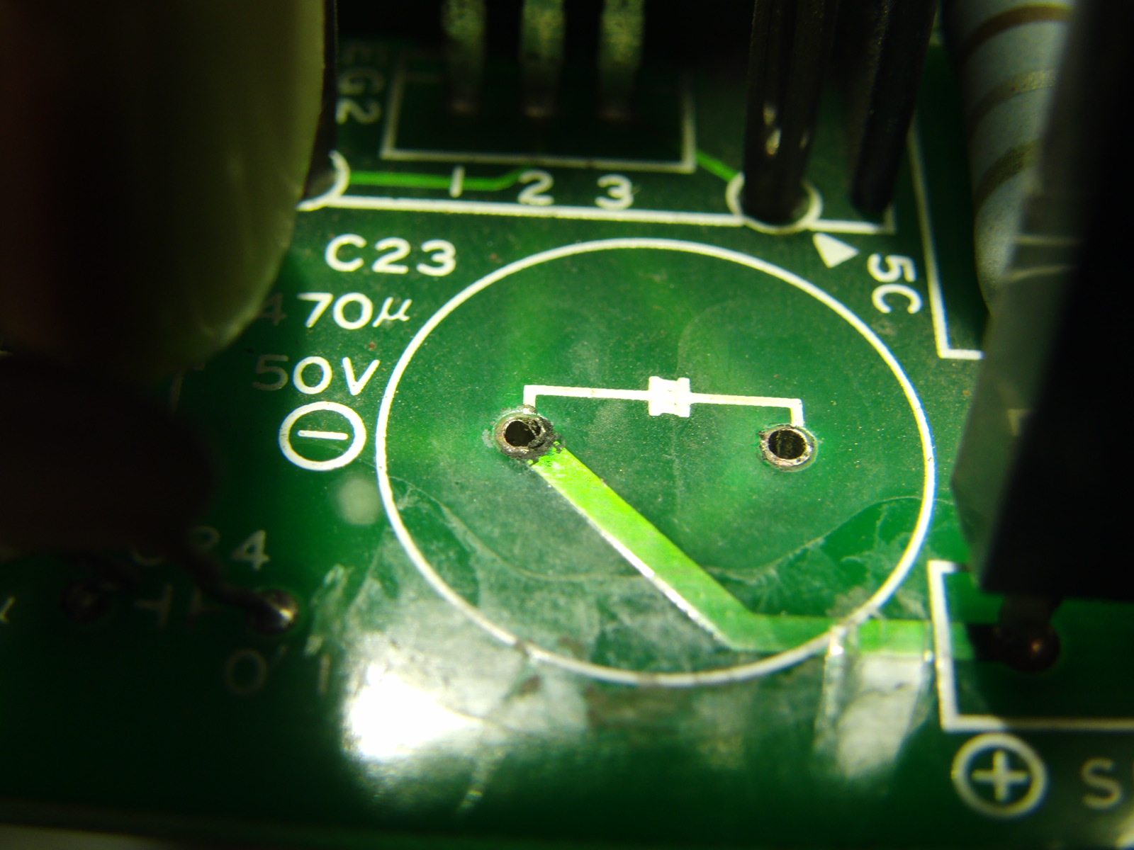

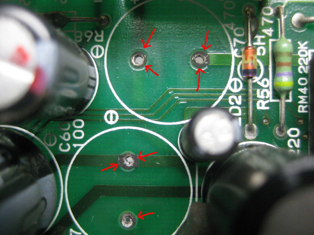

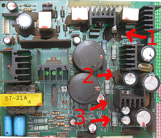

So this words of his led me to the next attempt to remove these capacitors as below,
Attachment 23096

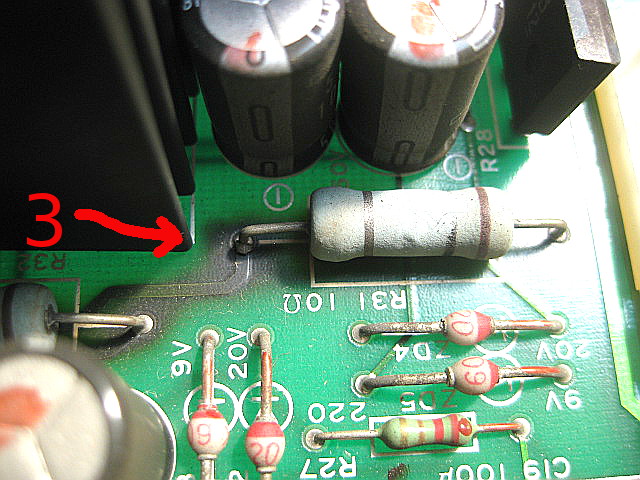

and see how the colors of the 'land'.(they call the small holes with copper plating on any circuit board 'lands/land')
These lands, especially where I marked with red arrows has got some dirt around them.
Attachment 23097
In the worst case, if we keep these untouched, these oxidation go farther deeper to the copper plating of the board, and finally invite disconnection to the part. Yet an examiner/user may not be able to find out where to be repaired, since the issue is undermined at the foot of the capacitors which looks pretty good at glance!
Attachment 23098

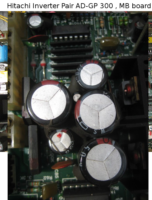

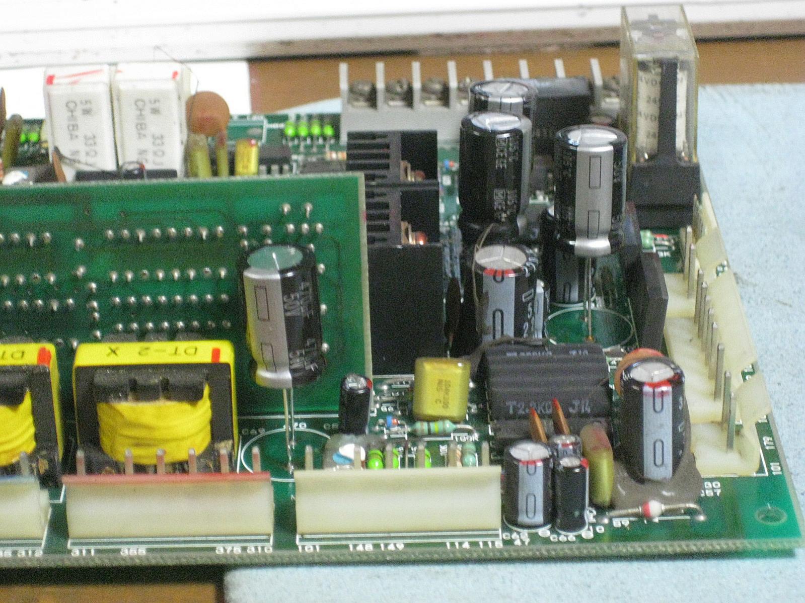

Could you guys tell what are the new capacitors I replaced, they are all a tad smaller than the old. Small but has better durability to the load, the old bears 85 degrees Celsius, new 105 degrees.
