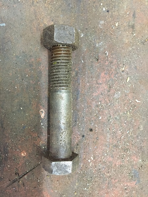

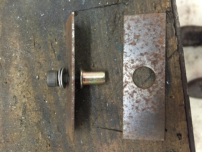

Had to fit a few riv nuts to my kit car chassis. So dug out the old one...home made...very simple.
Attachment 27357

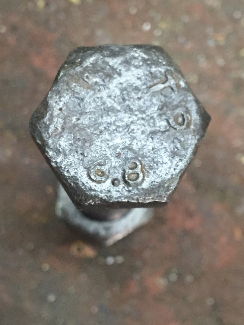

Then I remembered that I did not like this one very much as you were actually using the "nut's" threads to collapse the shoulder.

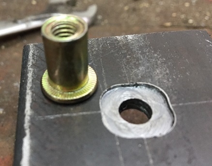

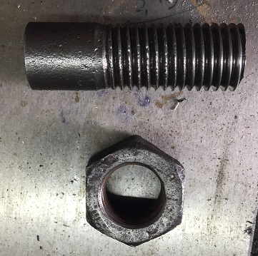

I had an idea in my head since the day I made the old one. So a quick dig in the Scarp Bin and this old timer was found.
Attachment 27358 Attachment 27359
Nice soft M16.
The idea was to drill it out to accept a M6 cap screw to butt up against a shoulder at the bottom and then use the M16 nut to collapse the riv nut shoulder. the bits I wanted.

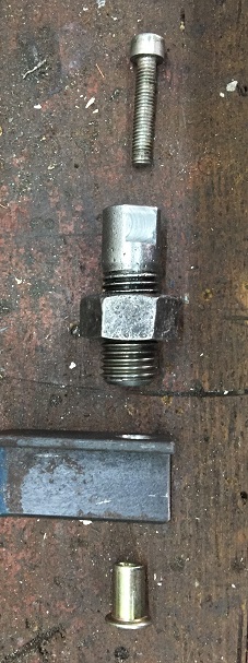

Attachment 27360
I ended up making this modification after the first try with the new tool. A small recess for the riv nut's flange.
Attachment 27361

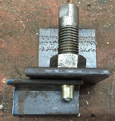

The complete assembly before tightening the M16 Nut. The friction was more from the M16 nut to the angle iron base plate so I ended up turning the bolt part of the tool. I machined 2 flats on it to accept a 14mm spanner.
Attachment 27363 Attachment 27364

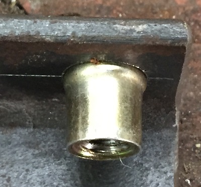

And to show it works...Take note of the number of turns required for the desired end result. Turn toooooo much and the whole thing just collapses in a skew mess. This was after 2 full turns.
