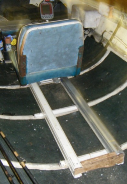

a Rolling Rowing seat for a small boat.
I guess it could be for any size boat over 12' long.
I got some Awning struts after a Tornado came through here.

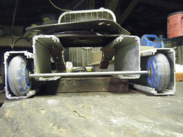

From some Roller Blades, I got some nice durable Rubber (quiet) wheels with Roller Bearings inside. That's important, because you want this thing to be drag free.Attachment 1007

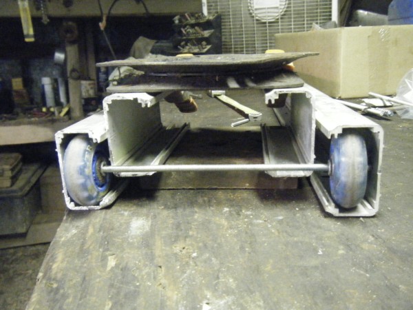

From the Barn I got an old Lazy Susan for Boat seats. I mounted that Metal part on a couple of Axles made of 'allthread' and put that Carriage inside two lengths of Awning strut.
Attachment 1006 Attachment 1008
Perfect those wheels just fit perfect!Attachment 1005
