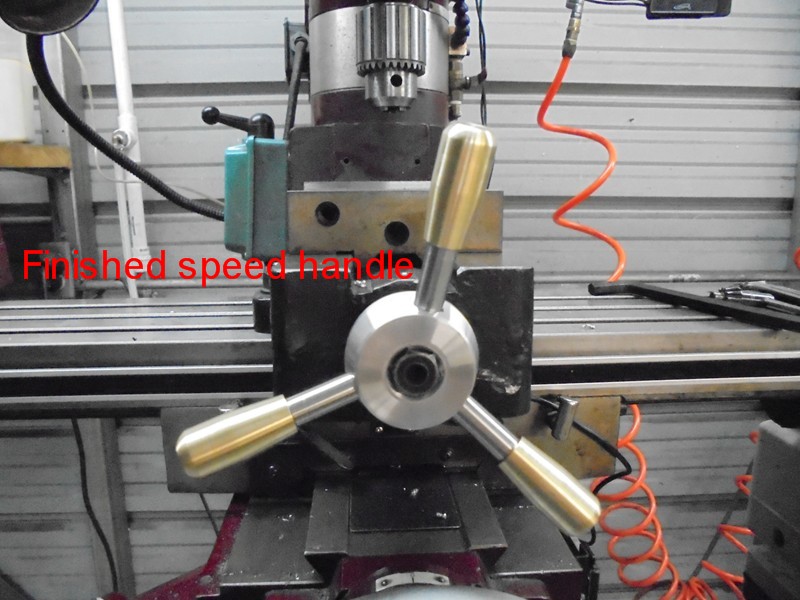

What inspired me to make this tool was I wanted to make a speed handle for my mill vise, I have never been fond of any milling machine vise handle, while the original handle is satisfactory I still like things to be a bit more user friendly, the original handle is to awkward when having to open the vise up more than an inch or so, they have a tendency to fall off and hit your big toe nail, while speed handles are readily available I still prefer to make my own tools, store bought tools today aren’t what they use to be, there is very little quality anymore,

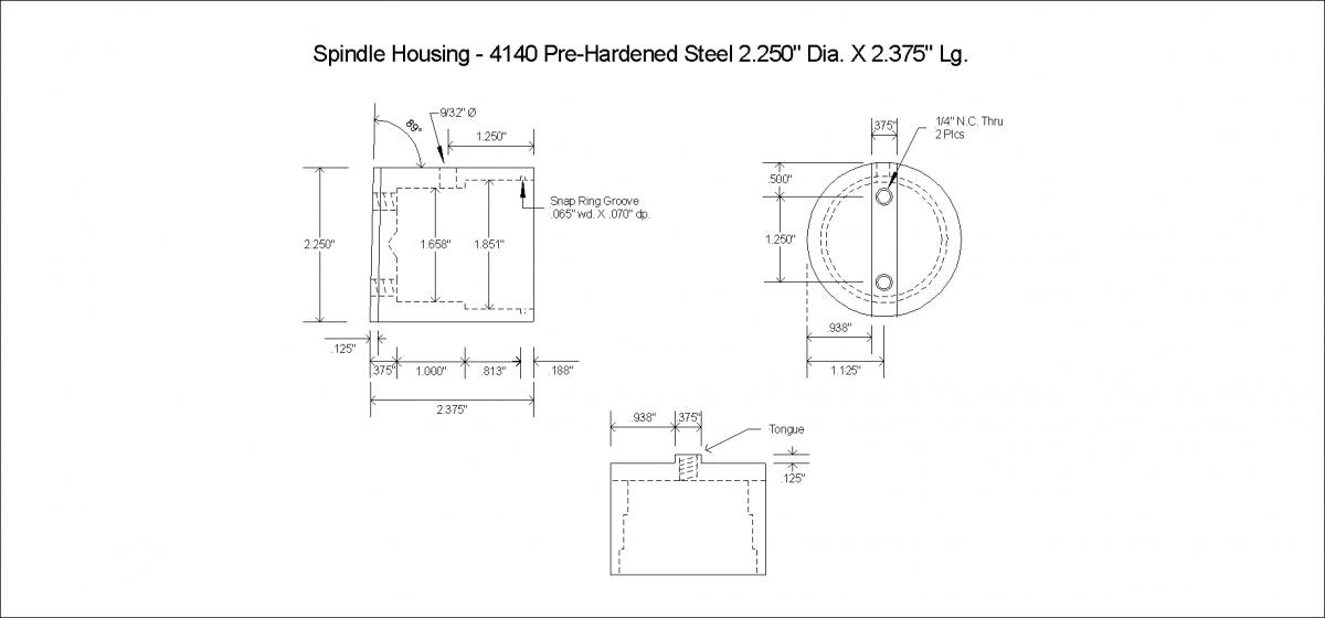

The concept of how the tool works is simple, instead of pushing straight down on all six points of the broach at one time like a punch press would do the broach’s axis is tilted 1°, as the broach rotates it only makes contact on one point of the hexagonal broach at a time, making it easy to push the broach thru a predrilled hole, I ran the lathes spindle at 600 RPM’s

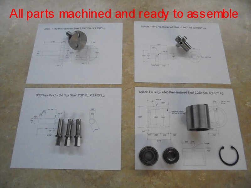

There are only four parts to make, the arbor, bearing housing, spindle and broaching tool, the spindle rotates in a SKF-5204 double row angular contact bearing and end pressure is absorbed by a NICE-607 thrust bearing, the three main parts were machined from 4140 pre-hardened steel, the 3/8”-1/2” and 9/16” hexagon punches were made from O-1 tool steel hardened and ground, square punches and form tools can be made as well.
Below you will see some photos of the machining steps of the tool being made and a video broaching a 9/16” hexagon hole, along with 4 drawings at the bottom of this page for anyone wanting to make this tool.

Attachment 18791
All parts made for the Rotary Broaching Tool

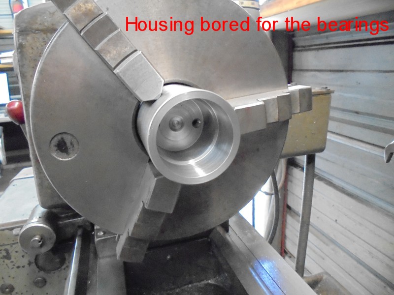

Bearing housing bored for the angular contact bearing and thrust bearing
Attachment 18782

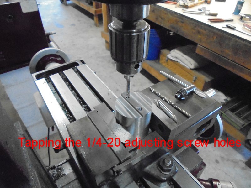

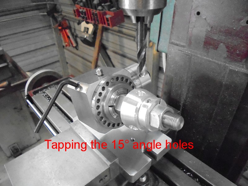

A 1° angle has been milled on the backside of the bearing housing along with the tongue and two 1/4"-20 holes

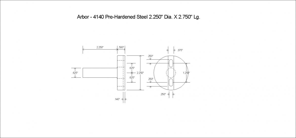

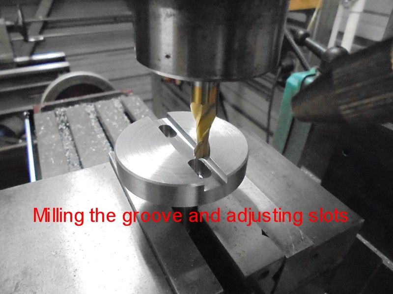

Attachment 18783
This is the arbor with two adjusting slots and a groove for the tongue on the bearing housing to mate
Attachment 18784

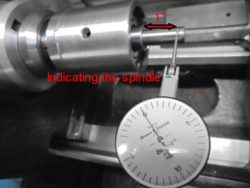

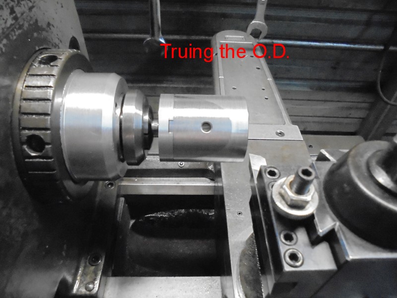

This photo shows the unit assembled and installed in a collet on the lathe, a 1/2" dowel pin is protruding 1" from the face of the bearing, this is where the it has to be running true, all punches were made the same length so indicating was only necessary one time, make the punches the same length no matter what size they are and indicating will only have to be done one time, it's just a matter of changing punches
Attachment 18785
This photo shows the unit held in a 5/8" collet on the lathe and being turned true after the indicating

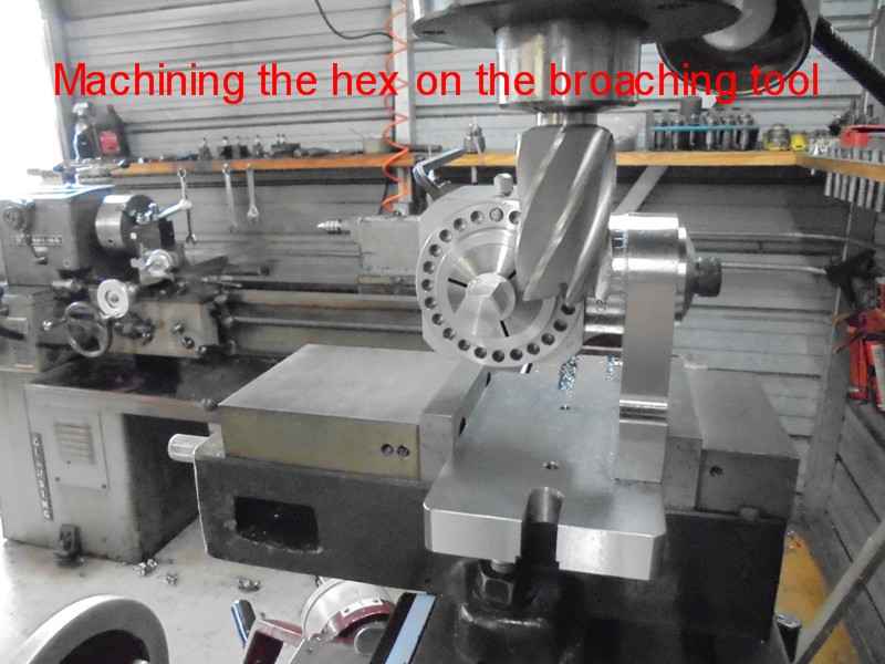

Attachment 18786
This photo shows the hex punches being made
Attachment 18787

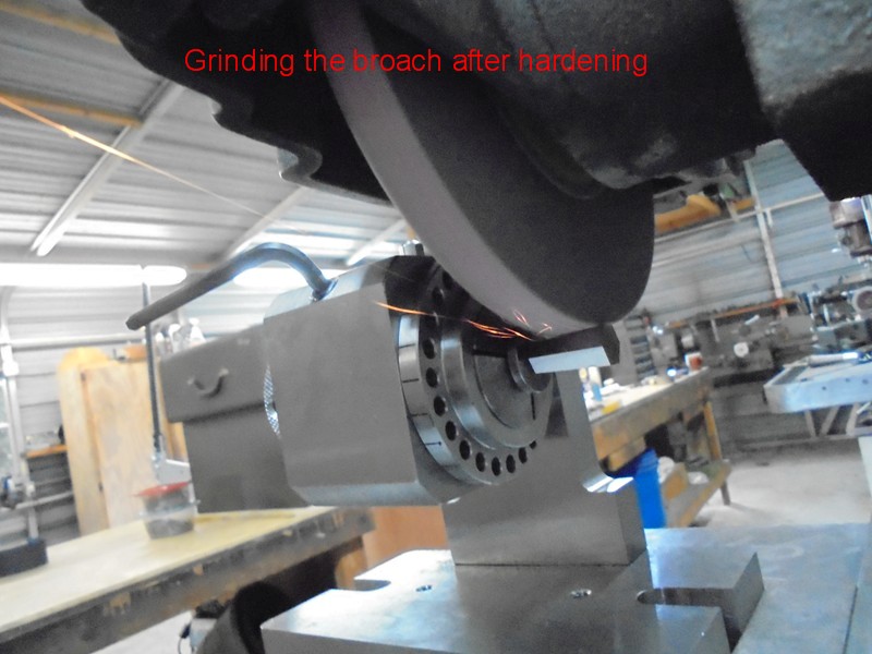

This photo shows the punches being ground after heat treating
Attachment 18788

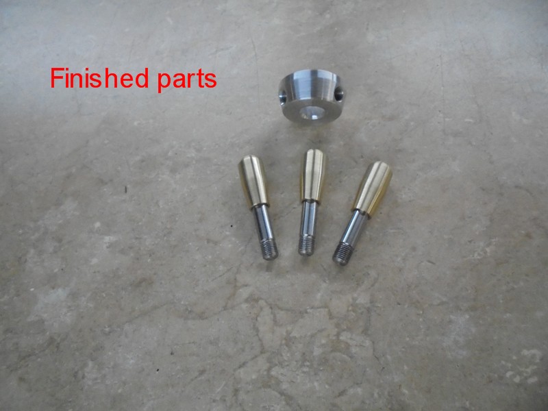

This photo shows the hub for the mill vise handle being drilled and tapped for the three spokes
Attachment 18789
This photo shows all the parts made for the speed handle
Attachment 18790
Speed handle complete and install on the mill vise

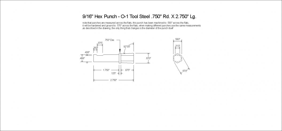

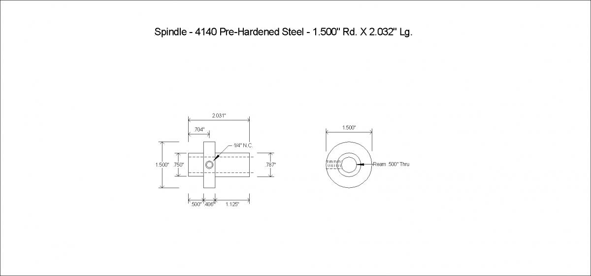

Below are the 4 drawings to make this tool, good luck, and post your completed tool !

Drawing of Arbor (above)

Drawing of Spindle Housing (above)
Attachment 18799
Drawing of Spindle (above)
Attachment 18800
Drawing of Punch (above)
