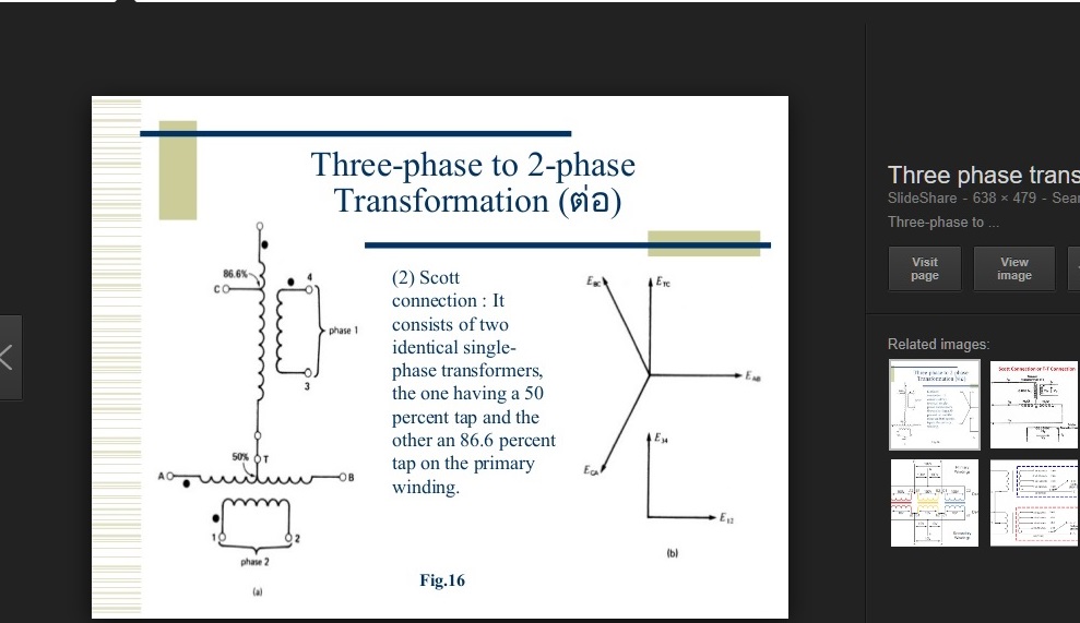

    This is three-phase to two-phase transform
    I have only seen this in books and was uses around 1900
    I was told by a old electrician is use for 115 volts for offices and last time he ever saw was in build built in the 1920's
    Dave

    Quote Originally Posted by smithdoor View Post
    Dave
    Why would anyone want to go from 3-phase to 2-phase?
