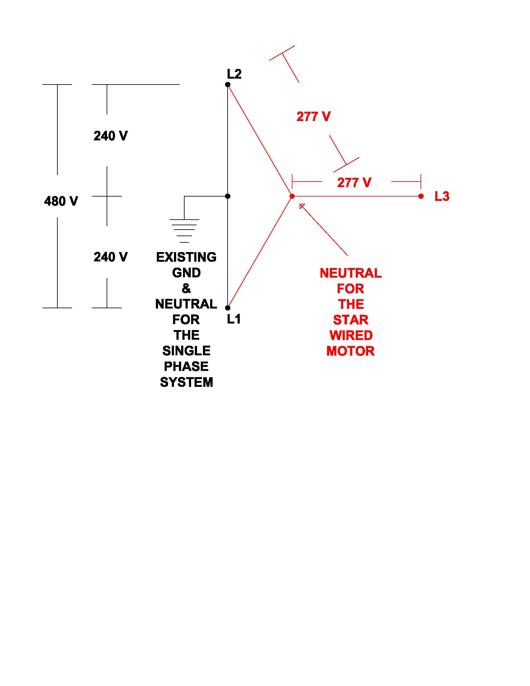

    Here is the vector diagram when you apply 480 volts single phase to the L1 and L2 terminals of a three phase 415 volt star wired motor.
    Rotary Phase Converter (Create 3-phase power from a single phase source)-480-v-applied-415-v-star-motor.jpg
    Please note that you have 277 volts across each motor winding while the idler motor is running.
    It has already been suggested by Frank S that you would need 415 volts.

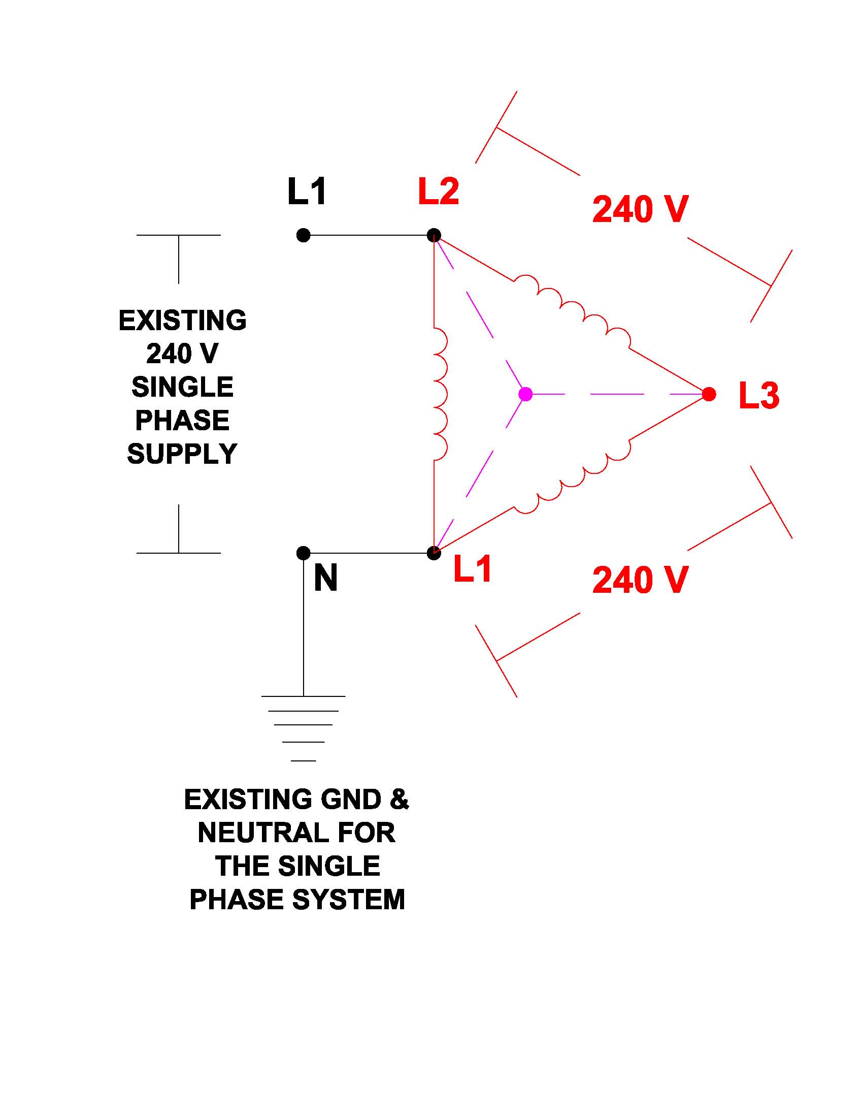

    Your cheapest alternative is to re-wire the 3 phase idler motor and the 3 phase load equipment to accept 240 Volt 3 phase delta. Then you will not need a transformer. There are multiple videos of this scheme in operation on you tube.

    The reason you can't make it seem to work, is because your circuit schematic is wrong.
    The ground between the two 240 volt "phases" should be connected to the junction point of the star. What you are trying to do is connect the circuit up delta, and you can only do that with a rotating supply (genuine 3 phase 120 degrees displaced), at which point you will find 415 between any two phases.
    The question of "my maths" is one of terminology. All phases in Australia are 240 volt between hot and ground, therefore, 3 phases are 3 lots of 240 volt 120 degrees apart. In the instant of the welder, name plate amps are "10 amps per phase" and since the welder does not require a rotating supply it is in effect a star wound device (each phase 'pulls' 10 amps) giving you 30 amps across all phases. However all three phases after transformation, ultimately feed into a full wave bridge, thereby giving the result of one big transformer producing DC output.

    It is obvious you do not understand 3 phase power systems. The welder does require a three phase "rotating" power supply to function correctly at name plate rated output. The correct power calculation for a three phase system is "volts" times "amps" times "square root of 3" times "power factor". So if the imaginary "welder" nameplate data states 10 amps at 240 volts at three phase it would consume 10 times 240 times 1.73 times some unknown power factor that you can not specify since you have no clue what a "power factor" is. The absolute maximum consumed power for the welder would be 4157 watts. The current does not flow from the 240 volt point of the star to "ground".
    In the 480 volt single phase diagram I uploaded previously, if you connect the single phase ground to the neutral of the 415 volt star wired idler motor the rotary phase converter will NEVER function correctly. In the first place you need to apply a 415 volt single phase voltage. The mechanical placement of the star wound motor windings are 120 degrees apart on the stator of the motor. The neutral of the star wound motor has to "shift" relative to the existing ground of a 415 volt single phase system while the idler motor is rotating. If you hardwire the existing ground to the neutral of the idler motor you are electrically exciting two of the motor magnetic pole pairs with a voltage that is 180 degrees apart.
    For your enjoyment I have attached a diagram for a 240 volt delta connected idler motor setup. The magenta colors show the "virtual" neutral point that does not actually physically exist (this was explained by Paul Alciatore assuming you can understand the electromagnetic theory involved).
    Rotary Phase Converter (Create 3-phase power from a single phase source)-240-v-applied-240-v-delta-motor.jpg
