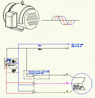

    All the parts for a static cost from Amazon is around $35.00 for 5HP FYI you need a potential relay I like APR5 works the best
    Now if find a old use 3 phase motor star wound now you have rotary converter
    You can add oil run cap make look better but that all
    Dave

    Attached Thumbnails Attached Thumbnails Rotary Phase Converter (Create 3-phase power from a single phase source)-three-phase.jpg

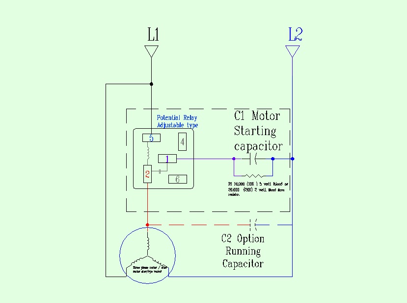

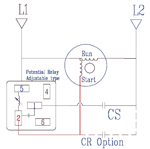

    The relay turns the start cap off after the motor starts
    The potential relay APR5 is adjustable for voltages (130-370Volts)
    You find this type of relay use in AC and deep well water pumps
    I replace centrifugal switch found in single phase motors
    The first drawing below shows a typical single phase motor use a potential relay
    Note the start winding is 90° to then main winding this give the motor the direction to turn
    For three phase the winding are at 120° The second drawing shown how it is wired for three phase
    Dave

    Look the Single to three phase converter in Australia converting single phase power into 3 phase power web site
    It use a potential relay with a starting cap and run cap as shown in my drawing
    They did add a step up transform to 415 volts
    Odds are you can buy all parts from a AC supply or pump supply company for around usa $35.00 and add a transform if need.
    Dave
