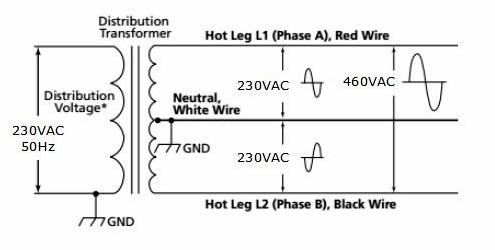

You would connect a single, SINGLE PHASE line to two of the motor terminals (A-B OR B-C OR A-C) of a three phase motor. It doesn't matter if it is a star wired motor or a delta wired motor as long as the applied voltage corresponds to the motor rated voltage.
All the RPC designs I have seen are similar with respect to one thing. After the idler motor is brought up to speed they all connect a single phase voltage of an RMS amplitude that corresponds to the motor nameplate voltage rating to two out of the three idler motor terminals. If you have a 3 phase, 240 volt rated idler motor you apply a 240 volt single phase voltage and can generate a 3 phase 240 volt supply. If you want to generate a 415 volt three phase supply you would need to apply a 415 volt single phase voltage to a three phase idler motor wired for the 415 volts. If you only have a 240 volt single phase voltage available you could step the 240 volt single phase up to 415 volts single phase to generate the 415 volt three phase supply with the 415 volt three phase idler motor. For some reason old kodger and nhengineer believe the 415 volt single phase needs to be 480 volts single phase to apply to the 415 volt idler motor. You could also take the 240 volt three phase output of the 240 volt idler and use a three phase transformer to get a 415 volt three phase supply but transformers cost money, especially three phase ones or three single phase ones wired in a three phase bank.
The first diagram I uploaded:
shows the error in applying a 480 volt single phase voltage to a star wound 415 volt three phase idler motor.

Junker2,
I guess I was referring to the diagram in your post #146 where you clearly show two 240V phases with a ground at their common point. You show these two adding up to 480V but you do not show any transformer. And they are connected to two terminals of a three phase motor in that diagram. My point was that if a building had only single phase, 240 Volt service, as a person in Australia would typically have, then there is no way to get 480V (or was it 415V?) from that without using a transformer. And those transformers apparently are prohibitively expensive. Perhaps I misunderstood, but you seemed to be suggesting that a single 240V, single phase feed could be hooked up in that manner to produce 240V.

Here is where nhengineer realized there needs to be two hot leads (out of phase with each other) with reference to earth ground for his present design to work.
Somewhere around here is where old kodger suggested using two phases of 230 volts 180 degrees apart.
And here is where nhengineer confirmed that old kodger would need two phases of 230 volts 180 degrees apart.
Now why would you want to buy an expensive transformer to get the two 230V outputs a half phase apart that would create (kind of) a 230V 3-phase (supply) suitable to run your 230V, 3-phase motors with reduced horsepower output (83.3% of the nameplate rating) when all the other RPC designs use a 230 volt (240 volt) idler motor to generate a "full" power 240 volt 3 phase supply?

Yes, the 480 volts is generated from a transformer configured as they are discussing above. I uploaded the diagram in post #146 to show that if the 480 volts was connected as shown in the diagram the actual voltage across the motor winding would be 277 volts, NOT the 240 volts that the motor windings are rated for.
This post:
shows how to connect a 240 volt single phase system to generate a 240 volt three phase supply WITHOUT THE NEED FOR ANY TRANSFORMERS.

The one thing that caused this thread to travel down the road top perdition is the fact that there are folks all around the globe with differing electrical power services available to them, plus the fact that not everyone understands that when something is written up or explained it can mean the nominal voltage, as with the term of single phase. In the USA single phase 220/240 volts requires 2 hot lines of 120 volts (nominal) in other places this is done by a single hot leg and the neutral. In many places such as Europe or in particular the Middle east 3 phase power is supplied to many homes in the form of 415v across any 2 of the phases
While I was working in Kuwait we often installed overhead doors made in Denmark that were powered by small 3 ph motors but only used a single hot leg and the common. this was accomplished via a very compact box which contained a small center tapped transformer and a couple of capacitors and not a whole lot else except for maybe a few resistors and a 5 amp fuse and a reversing switch.
