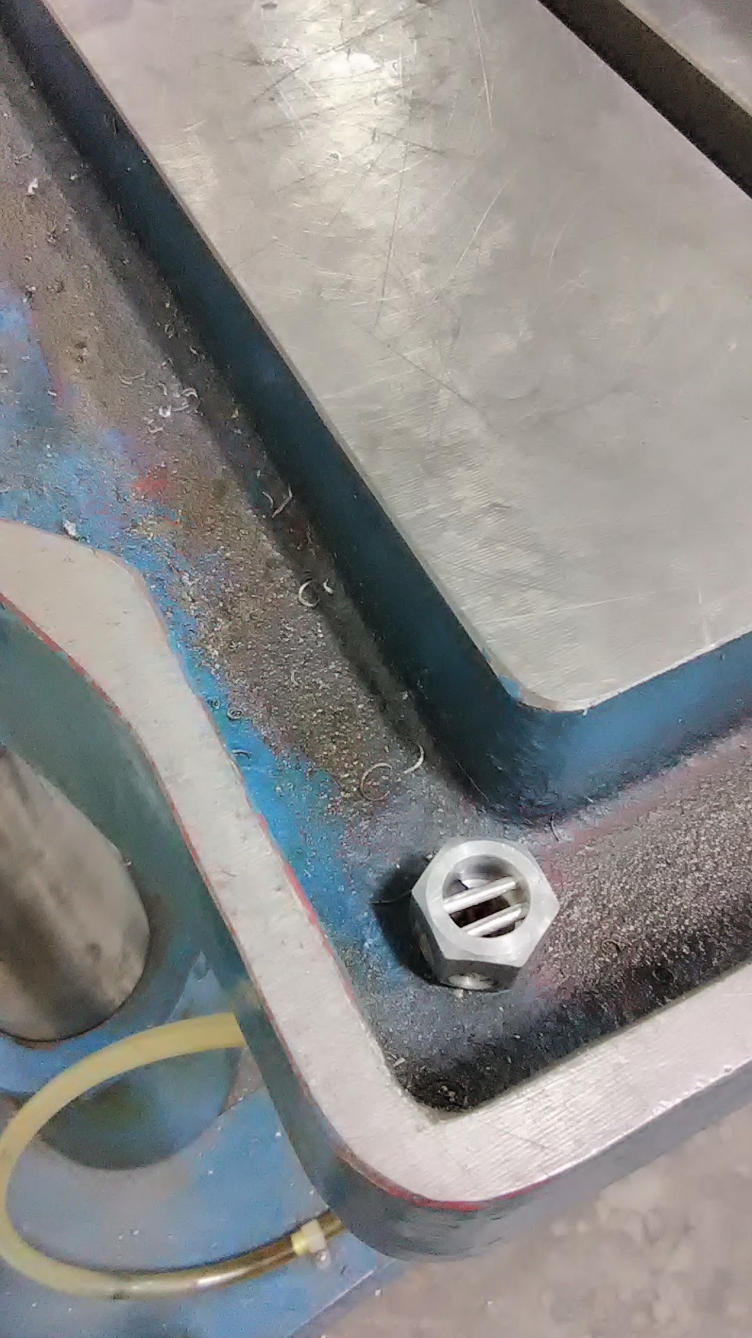

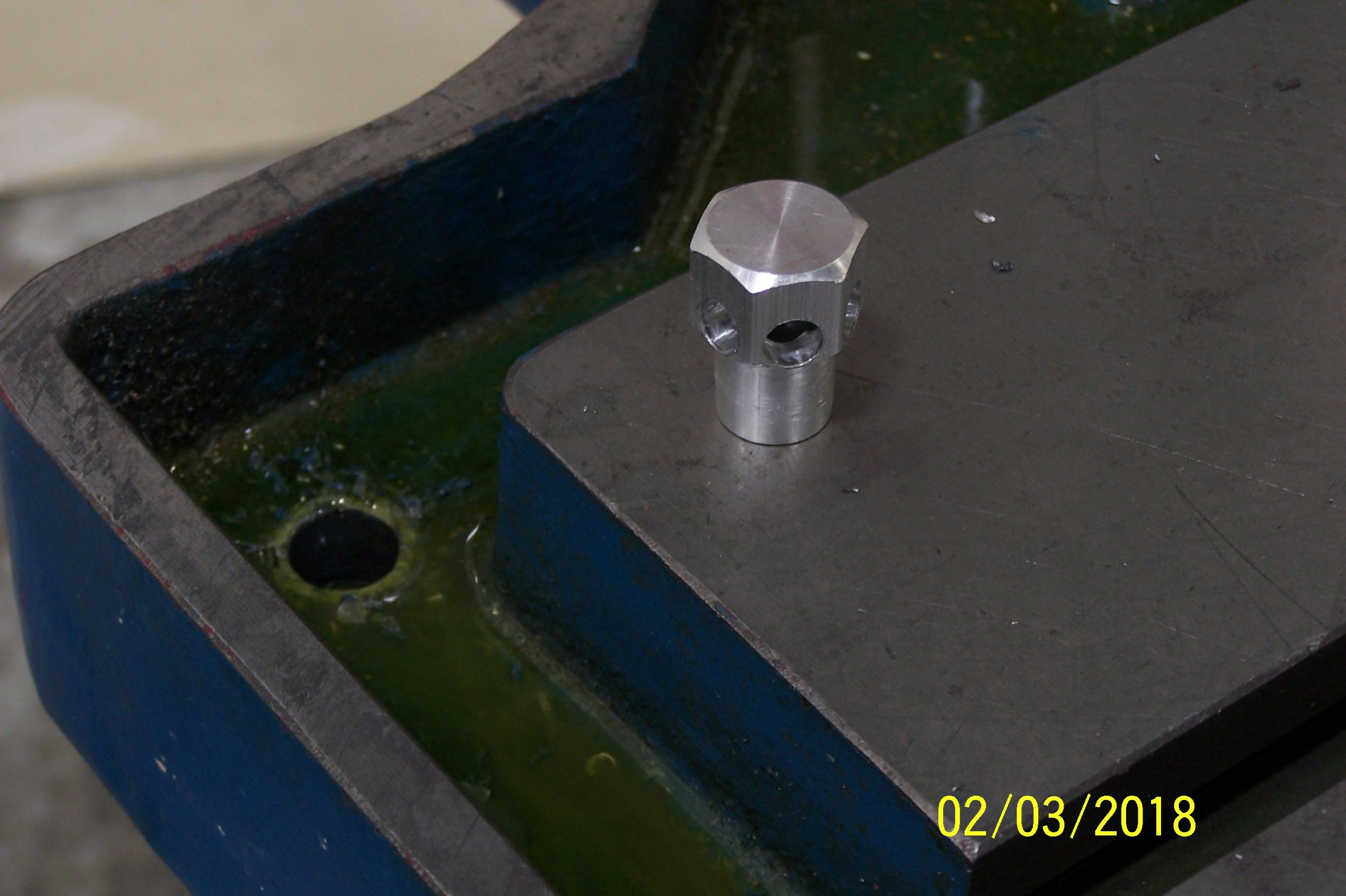

1] Trough drain opening was vertical and wide open. Machined a simple un-threaded hollow plug with side holes. It's sealed with a bead of plumbing putty.
Attachment 22798 Sizing of holes and plug ID restrict already marginal flow. A tiny ball valve controls volume fed. Takes 1/2 an hour at full volume to reach point of over running the trough. Calculated [I thought] enough surface area of holes to drain equivalent to feed rate.

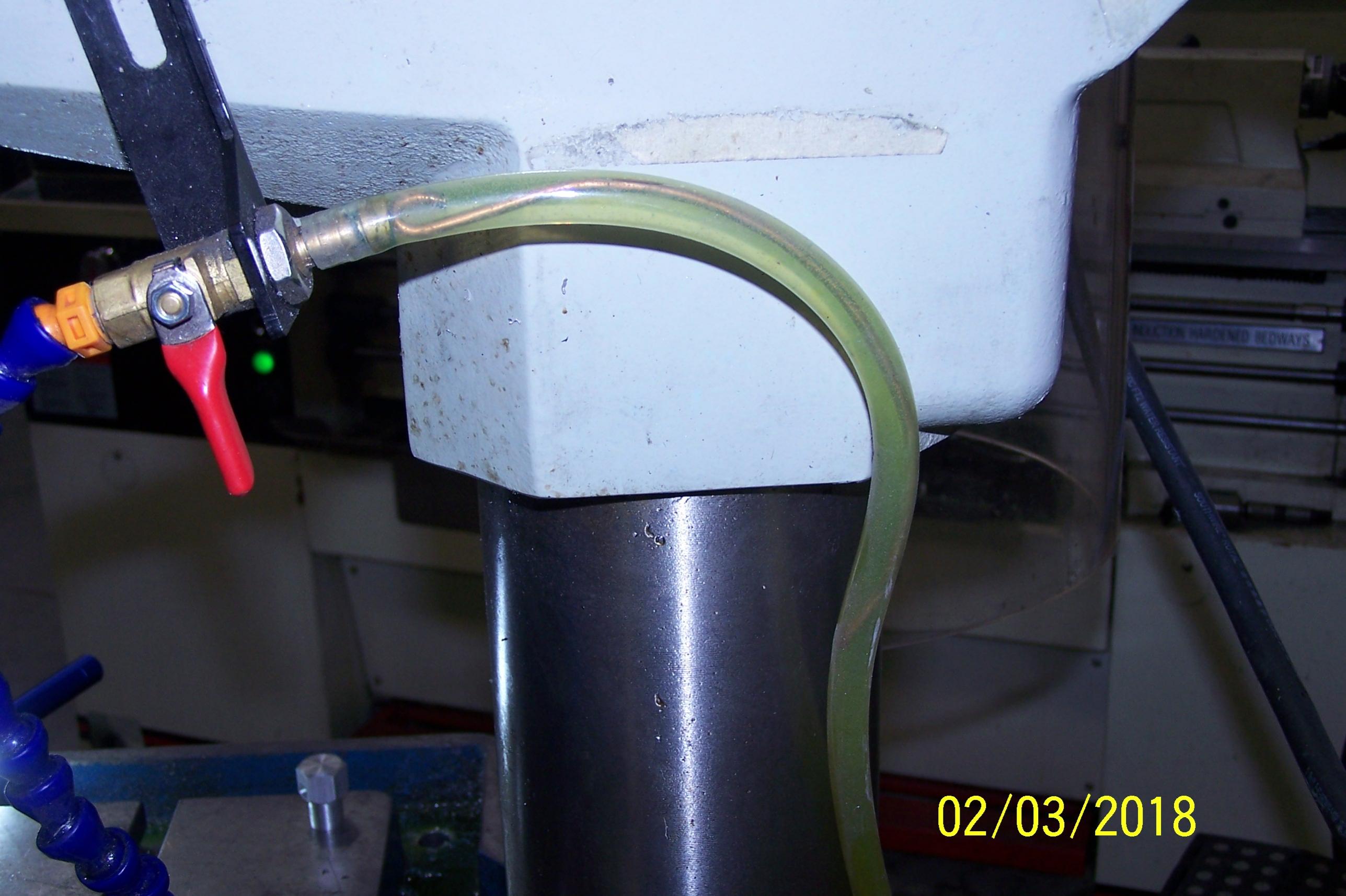

2] Both pressure and drain hoses curl uncontrollably. Alleviated with welding wire, formed to suit desired shape inside the clear vinyl hose.

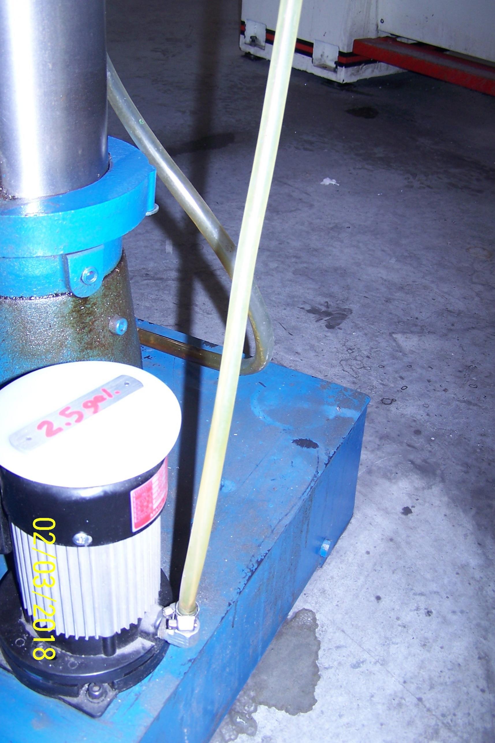

Attachment 22799A flattened loop in one end, barely larger than ID, secures it fine. Most important one is hose of table drain into sump of machine base! Unless you prefer mopping up...

4] Calculated sump volume, that quantity is marked on the motor fan shield.
