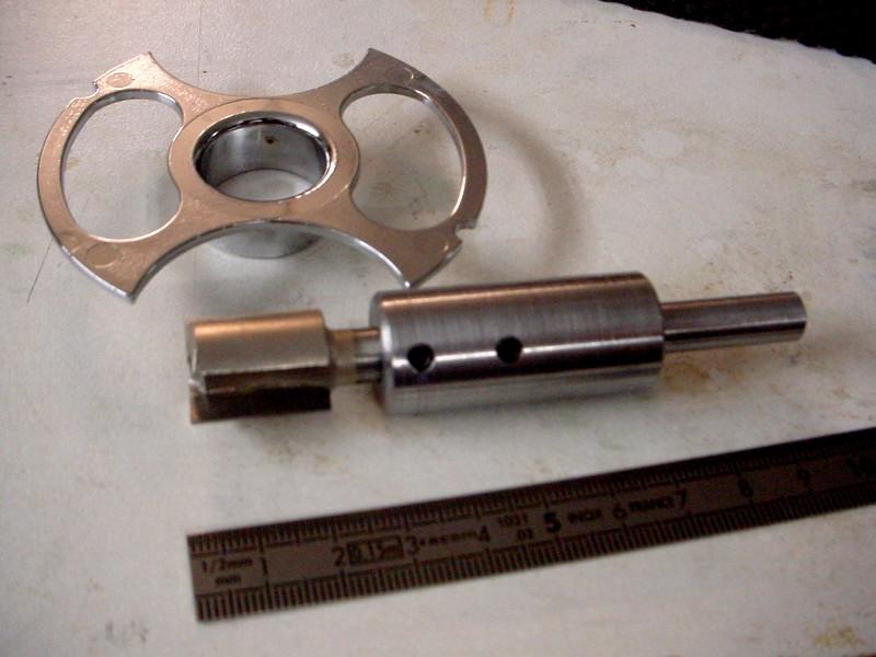

This is a homemade router bit extension :
http://www.labellenote.fr/photo/gal_...0-DSC00232.jpg
http://www.labellenote.fr/photo/gal_...0-DSC00235.jpg
Sorry, the photos are not so good.

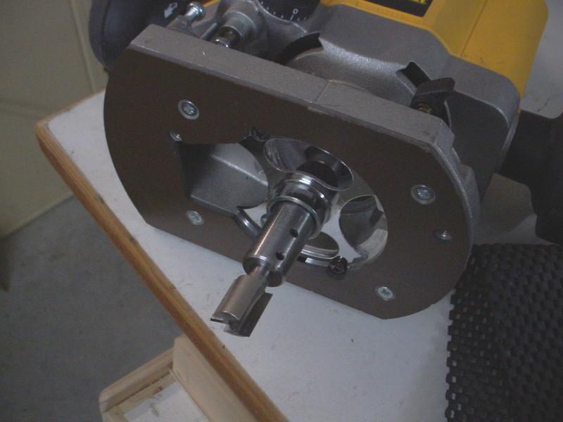

It was for making a neck pocket in an electric string instrument I was doing.
I needed to reach a deep bottom while using a template and a copying ring.
My router bit was too short, so I quickly did this extension on the lathe, and it actually worked well.
I was fearing it would have not turned true enough, but no, I had no problem and did the job.
I hope the router bit shaft has a Weldon-like flat under those setscrews. I would be scared to trust setscrews, flat or not, to hold a router bit at typical router speeds.
