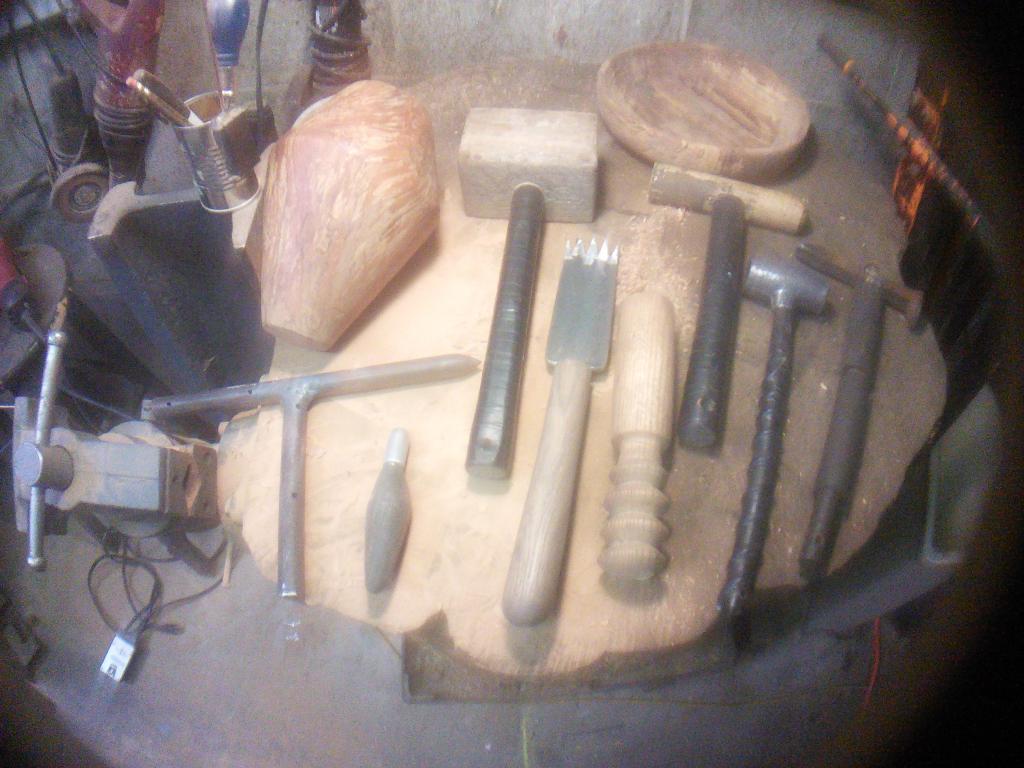

    From left to right, lathe tool rest from a string stake, exacto knife carving handle (only made the handle the original was cracked when i got it), larger oak head hammer, lathe chisel for beading (like the next thing over and file handles, thrown in a later photo), small oak mallet, another oak hammer (for sheet metal dents), lead hammer on metal tube wrapped with vinyl tape and paracord ( I didn't make this hammer but hope to learn how to cast the lead), railroad spike hammer on a metal tube ( for stretching sheet metal)

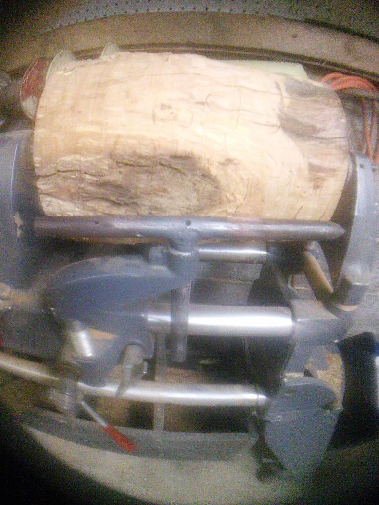

    String stake/lathe tool rest, the original cast one was small and snapped off.

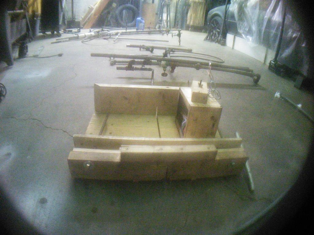

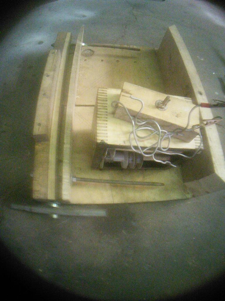

    Tablesaw finger joint jig/sled, it is all thread/ screw advanced. It and the half box/soldier station on it are a test run, made from scrap wood/pallets
    Another angle of the same things

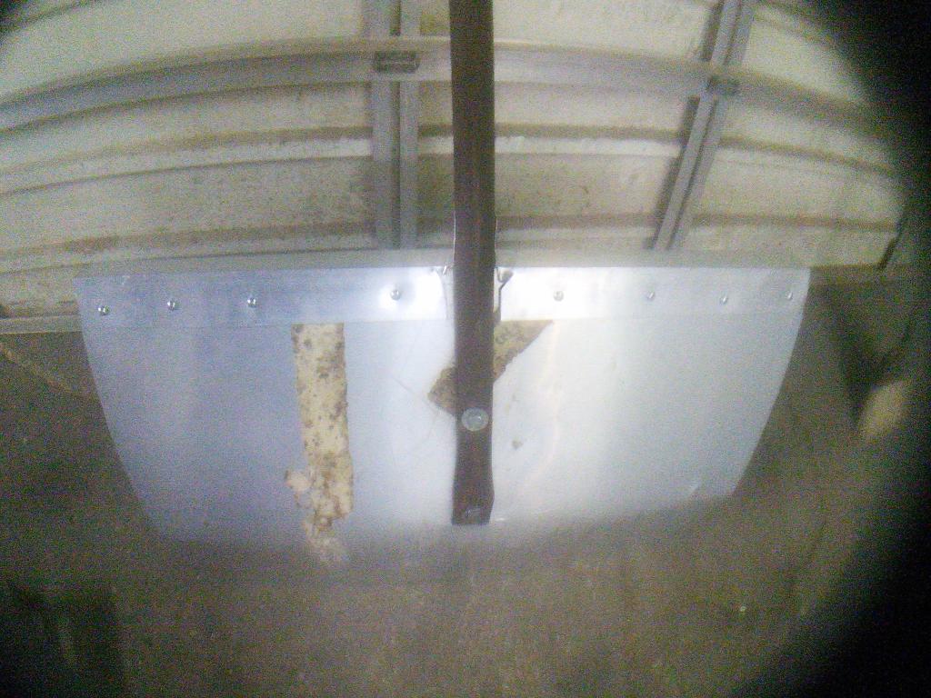

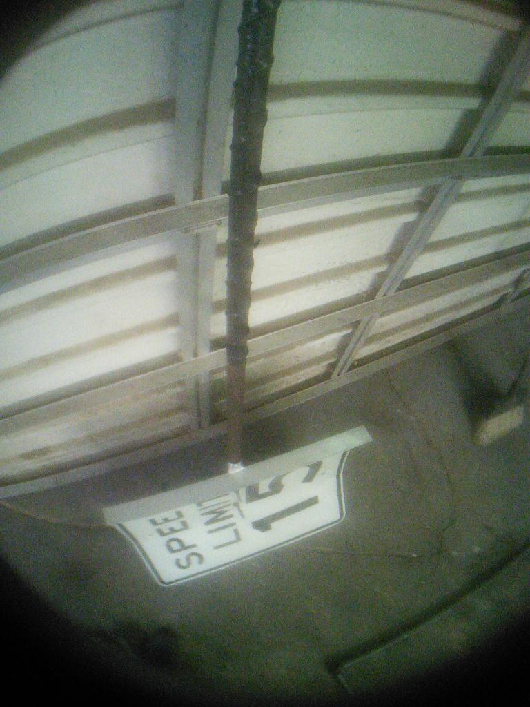

    Large simple snow shovel/plow from a speed limit sign, angle aluminum and fence tube. The handle is wrapped in vinyl tape over paracord
    Same thing other side, shovel clears 80% of the side walk in one pass generally. I just keep the shovel low and walk, no scooping/lifting required. The angle aluminum keep the snow from spilling over the back.

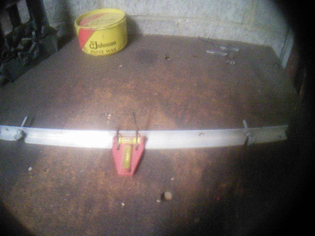

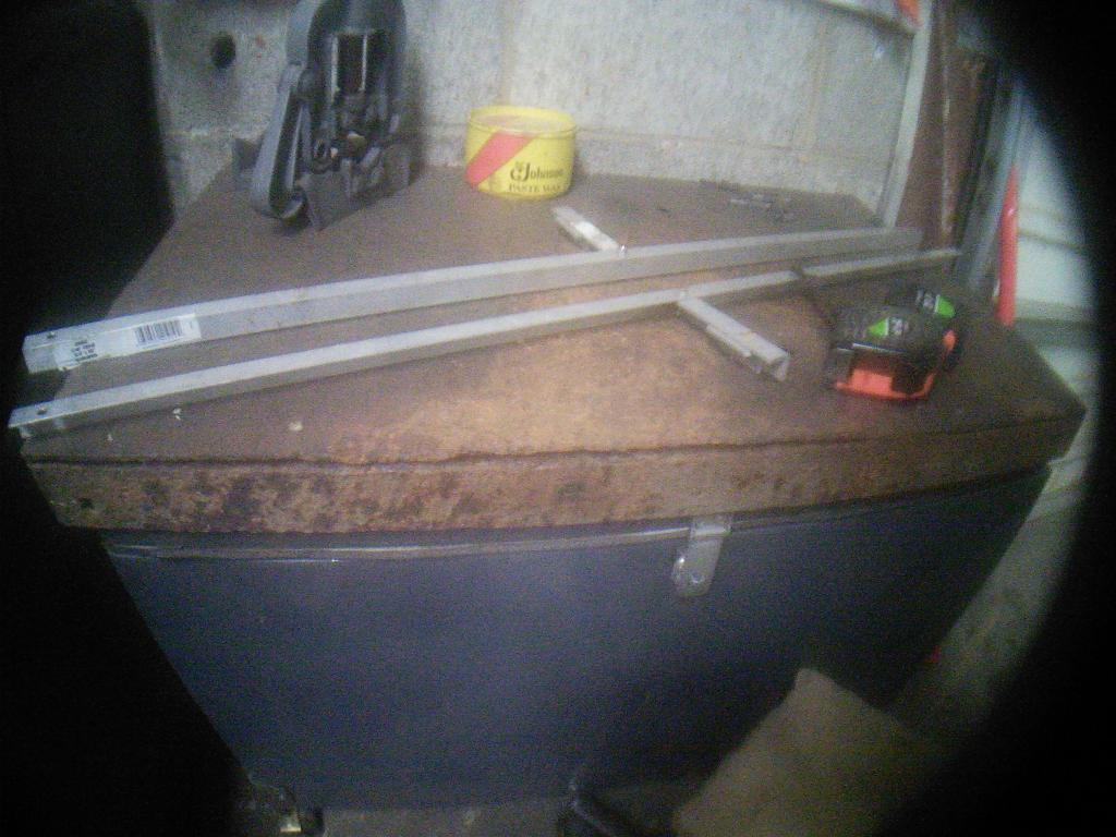

    Simple camber gauge for car alignment

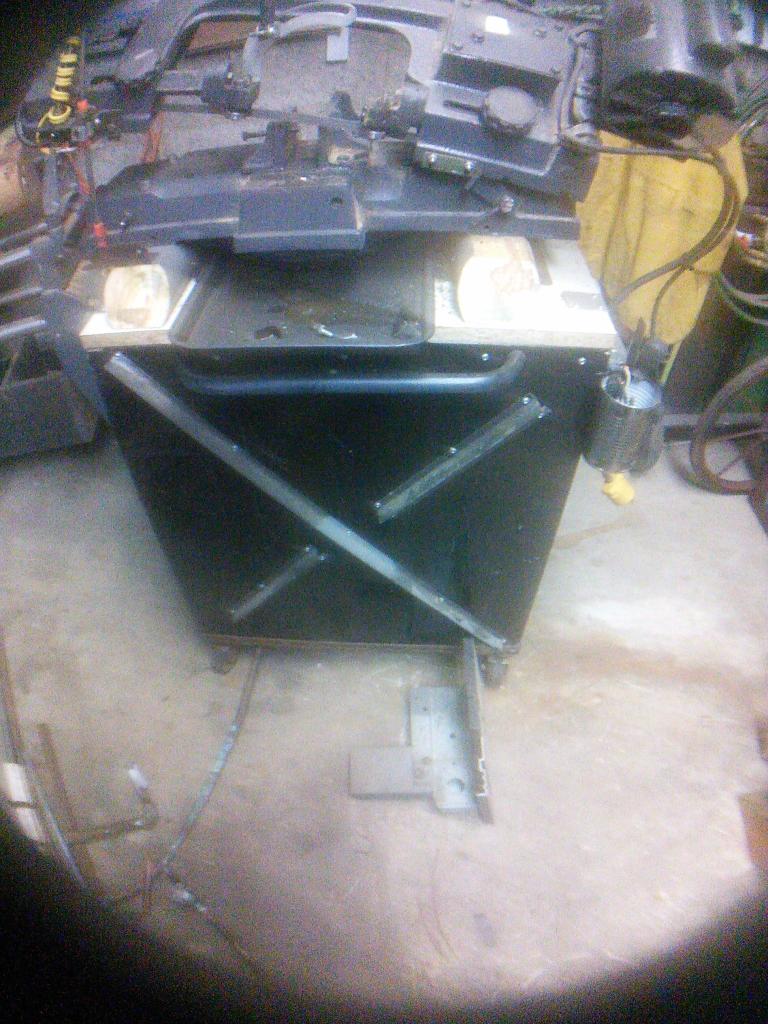

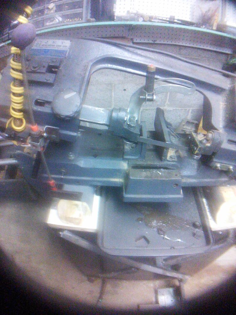

    4x6 bandsaw mods, not sure if these are very interesting to anyone. Its cart is a filing cabinet, on a dolly from a food service rack, reenforced sides with some sheet metal screws and "V" strips from a pingpong table. On the floor is a table for when the saw is locked upright from scrap metal.
    Laser blade guide, from scrap, a broken circular saw HF laser, rubber hose and odds n ends. The rod to the left with the purple foam ball is a simple junk made blade lowering control. This saw will be cutting up that junk plumbing pipe all over the floor I found tonight too

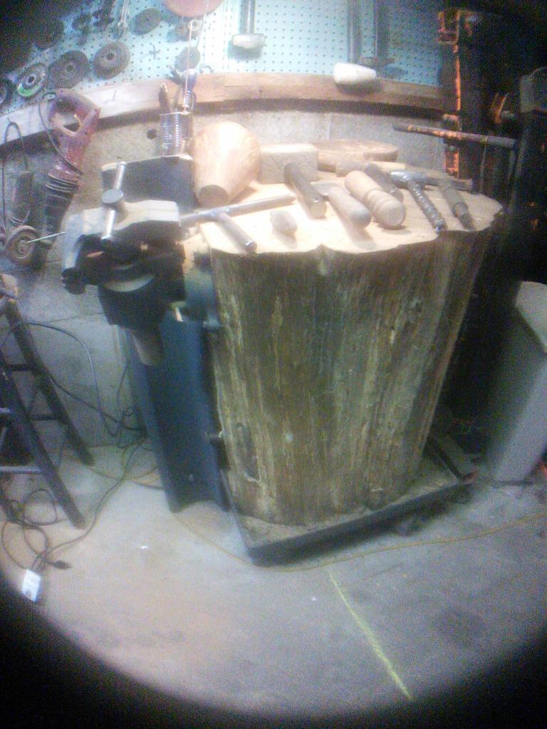

    Not exactly a tool, but a tree stump table for sheet metal forming, and general purpose, with a rail road track "anvil" and a junky rotatory head vise. It is too heavy to lift to move around so it is on a dolly made from angle iron and dumpster castors

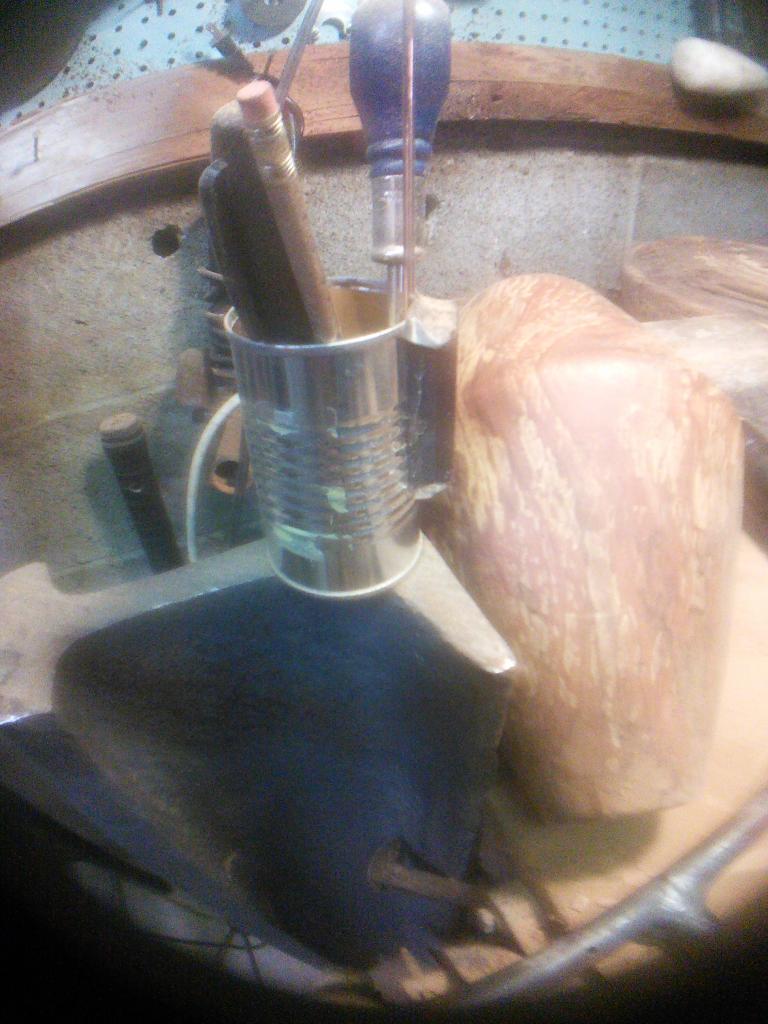

    These were in the other photos also, this is if not obvious a pencil/nuts and bolts holder. Very simple and cheap, but pretty handy, HF magnet glued to a can.
