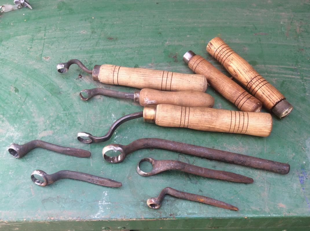

Scorps are wood-carving gouges, operated by pulling, as can be imagined. These have been forged from old ring spanners (not plated). Two have been finished satisfactorily, to me at least. The others depicted have all been ground, although not honed, and await handles. I do not think I would bother to do these in an open fire: having a gas forge means I can line them up without the metal spoiling, since one, or at most, two strikes on the drift, and the colour has gone completely. You may still see some of the striations from their previous existence.Attachment 24454
Very clever repurposing indeed. An offset box wrench (what your "ring spanner" is termed over here) has almost the perfect shape and is made of good steel.
I have a commercially made one left over from my woodcarving days. My wife was attempting to hollow out a watermelon half to use as a center piece for a garden party. She was chipping away with a melon baller so I offered her the scorp. She was delighted. After washing, drying and oiling, the tool awaits the next fruit carving.
Thank you, Marv. I am not sure of their utility for carving wood, they may well be more use in the kitchen!
All I remember is that, on the few occasions I used one, I decided that a small hand adz with a blade curved like a carving gouge was faster and more effective.
