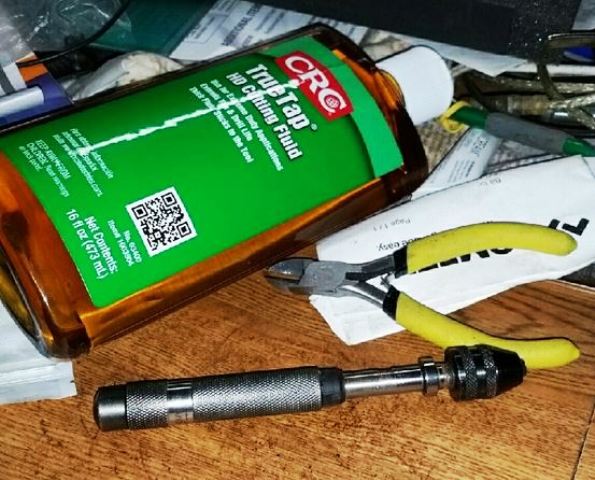

That's a nice handy tool. In a similar effort, here's a pin vise that I made from a dysfunctional auto punch and the motor shaft (with support bearing and chuck) from a POS rotary tool. I used to use it frequently for grinding TIG tips but I've since discovered that my screw gun does a better job faster so now it's got dedicated pin vise duty.
Attachment 35662
