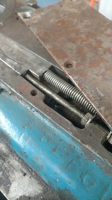

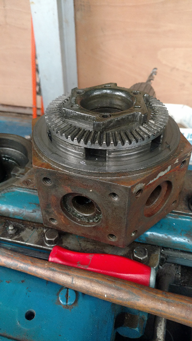

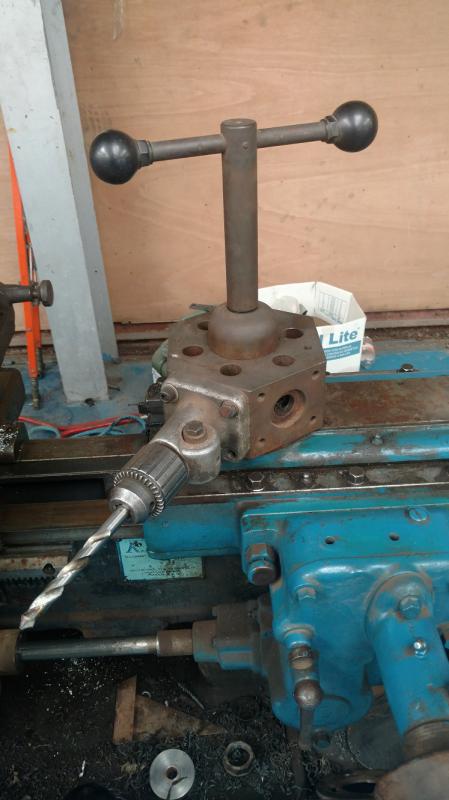

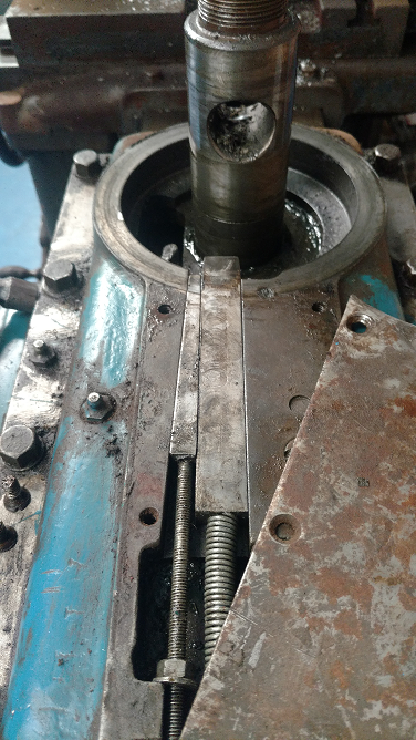

turret lathe does not index properly and the turret itself has excessive play rendering it pretty useless till this is rectified but i'm fairly sure i can do this without too much fuss despite the home made locking components.
