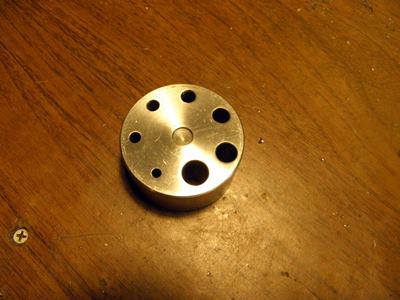

Self alining tap holder.
Made from CRS.

hey capainleeward, can I bother you to show how this works? can't seem to understand how it self-aligns.
Hi DIYer,
the picture does not show the depth which is 1 1/2 inch this allows the tap to stay in the vertical position during the tapping process.stops the wobble.

I see, thanks for the detail. Helped me visualize your tool better!
Simple and straightforward. I should make one of these.
Hi Altair, yea just get some solid round steel and drill away. Well mark and center punch it first. HE HE
