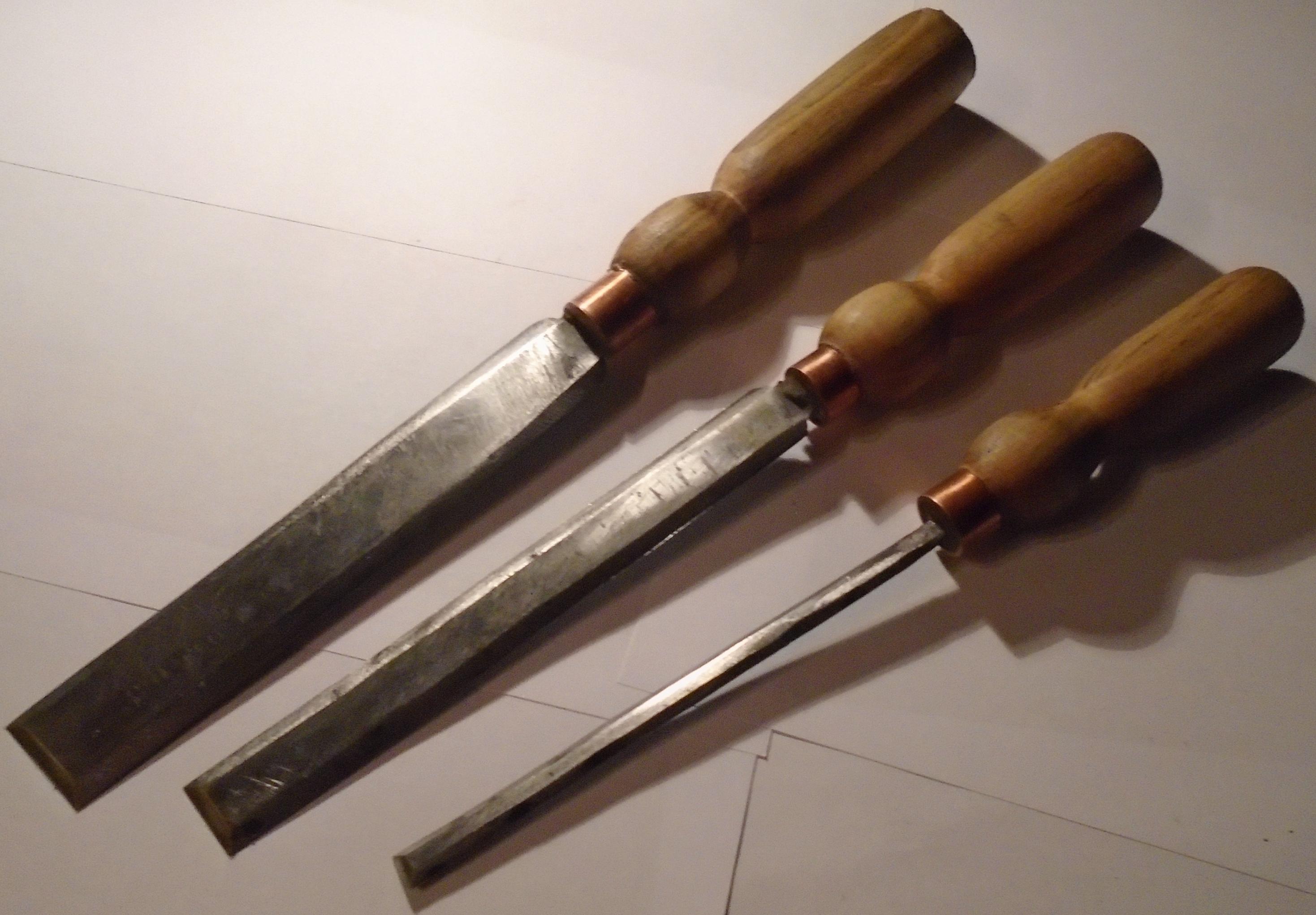

Set of paring chisels
https://www.youtube.com/watch?v=_dSnvpidm_E
In this video I make a set of paring chisels form an old circular saw blade. I made a 10,20 and a 30 mm chisel. Once again I didn't harden nor temper the steel as I don't want them to be brittle but to be able to flex a little. To make the bevels I used my homemade disk sander with a piece of angle iron double stick taped to a bed on a 30 degree angle. Hop you like it.
Attachment 3957
