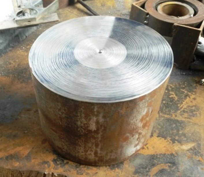

MY first thought was a section of 6 to 8" thick wall pipe. I have both but no short pieces then I spied a 6" diameter solid cylinder about 5 " long. Perfect just chuck it up in the lathe and face it off on both ends
Attachment 19270
leaving a very slight concavity to both faces It is plenty heavy enough to be a stable stand off and I can use the 1 heavy machinist jack to support the opposite end of where I will be boring.

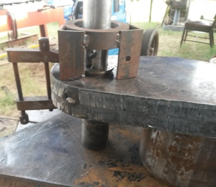

After machining the faces I laid the plates on top to check my clearances. In doing so I decided to just square up and tack the stabilizer bearings in place now that I have the boring bar and bearings perpendicular to the work piece surface all I have to do is transfer everything from the 1" thick steel table to the mill clamp things down do a little fine truing then bore out the holes like I started doing with the boring head several days ago
I know I could have been finished by now using just the boring head especially after I had managed to add a bolt in the center of the head to assist in securing it or I could have used my long boring bar and don this in the lathe like I did the excavator thumb part. What would be the fun in that ?

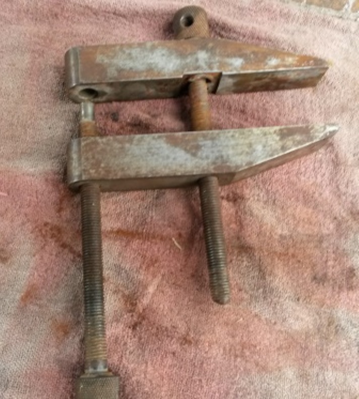

You may note my machinist clamp holding the cones in place
I made that in High school while more or less teaching the shop class for the coach my younger sister had kept them all through the years

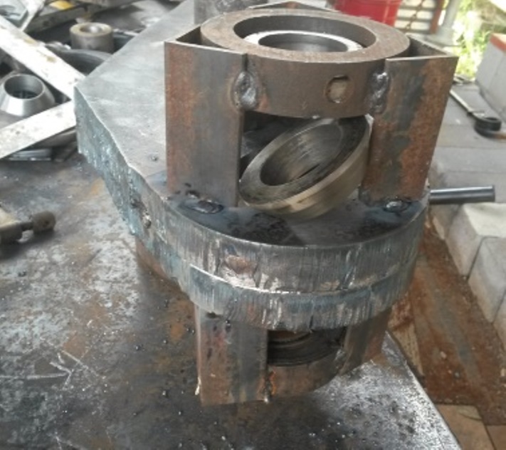

There is just barely enough room to remove the alignment cone

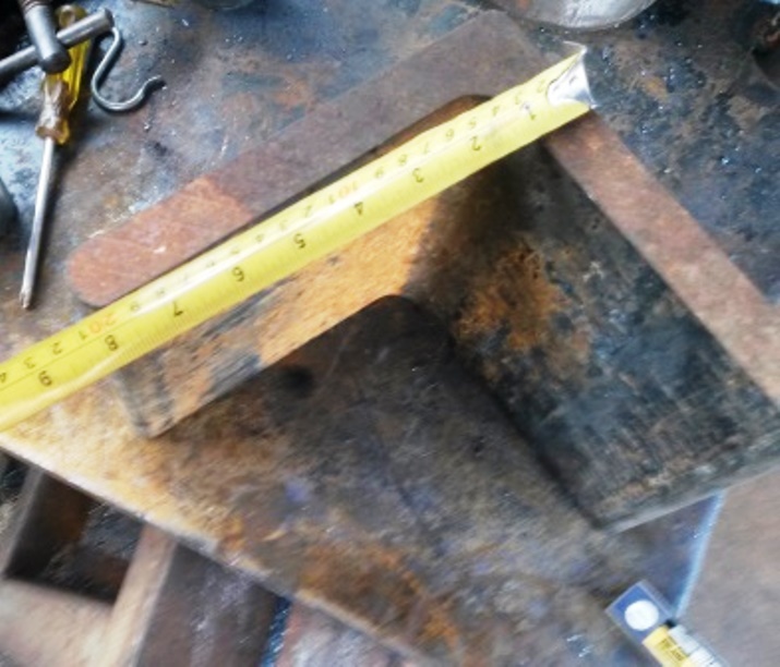

A future project, the making of a square angle block
Attachment 19273
the question is, do I want to make square on square on square by adding another right angle piece for the handle OR do I want to make square on square on 45° by adding a 2 or 3" wide 1" thick piece so I will have an angle block? Either way I plan on drilling and cross drilling holes on 1" centers on all faces then taping them to 1/2-13
