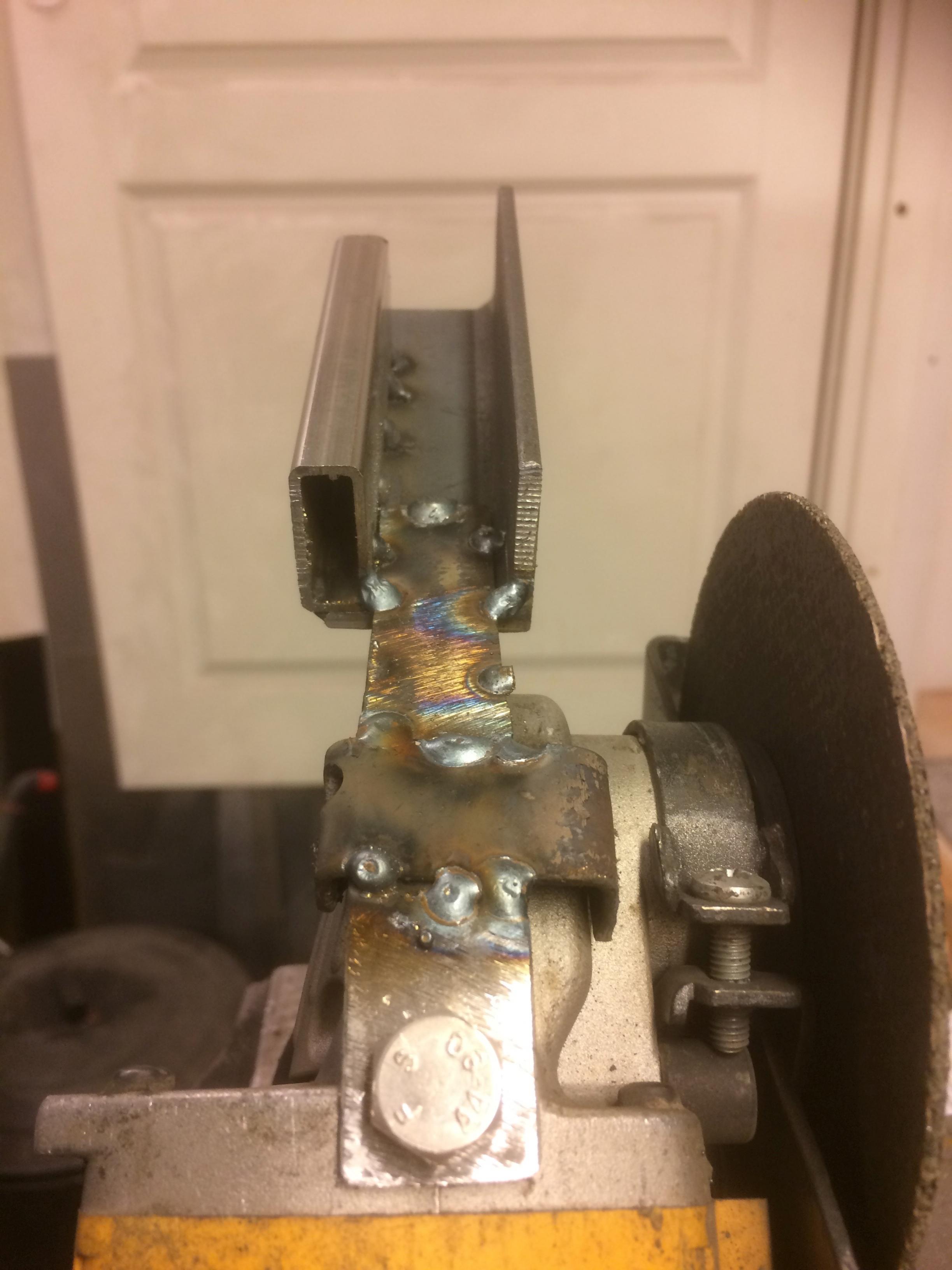

What I did was a U-shaped slider that I fixed to the free handle thread of the angle grinder.
Attachment 20734

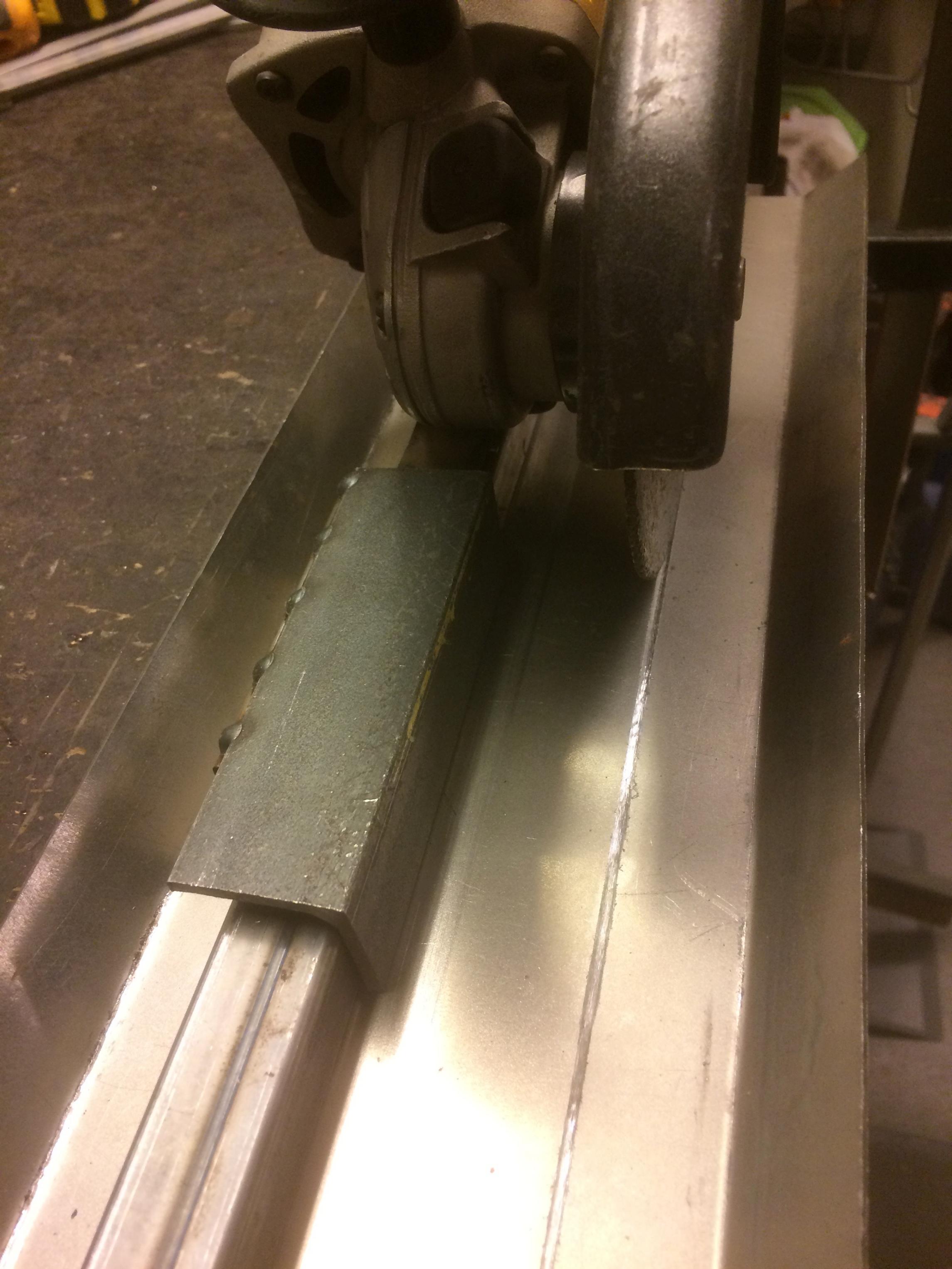

This U-shaped slider runs on a 20 x 20 mm square tube that is clamped down on the sheet metal piece at a distance 38 mm + the intended sheet metal flange in my case.
Attachment 20735

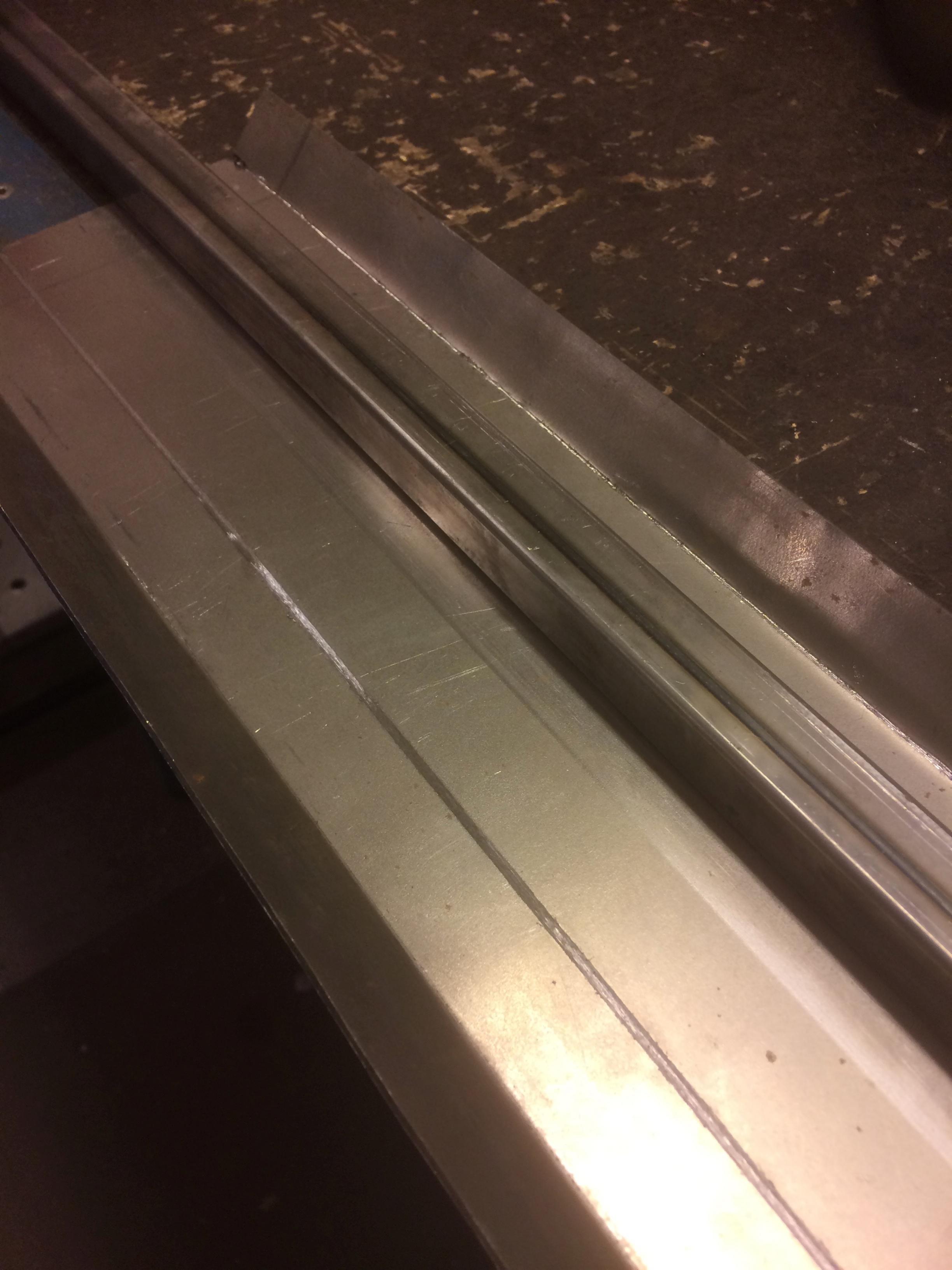

As the angle grinder now slides on the pipe the only thing you have to do is to monitor the depth of the score that should be about half of the sheet thickness in this case.
Attachment 20736

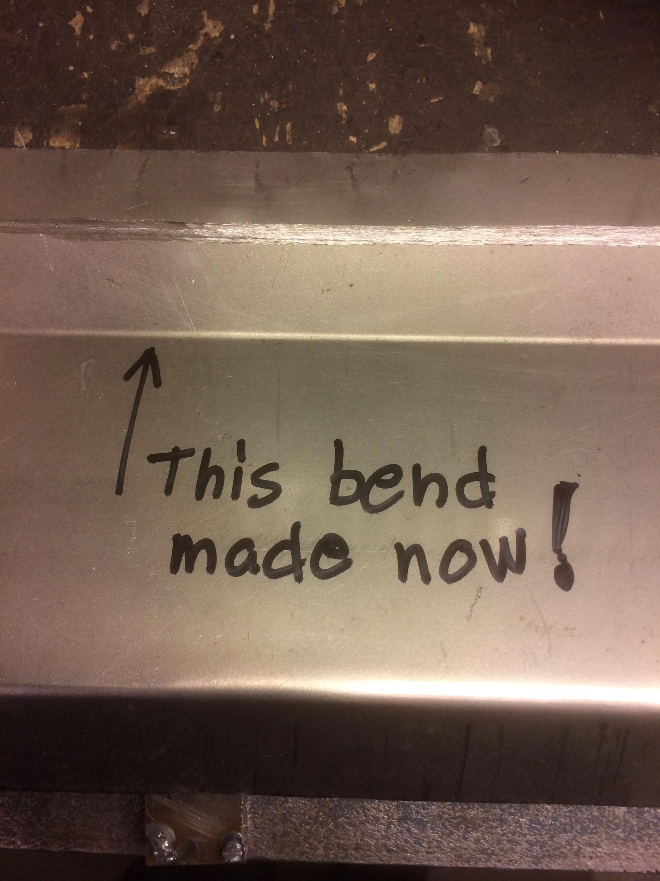

When the workpiece is scored it is quite easy to bend the flange using suitable iron bars. Here is a trial 45 degree bend made on a 1,5 mm scrap piece.
Attachment 20737
