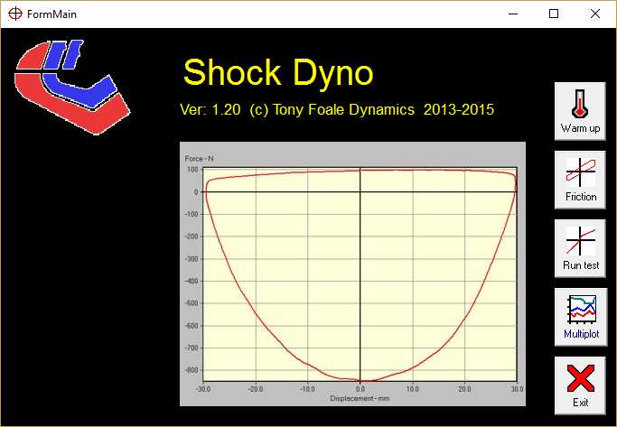

Hydraulic and electric are typically hi-tech and very expensive, controlled by computer they can driven to provide different wave shape displacements and can even be fed with real road data to simulate real life loading on the shock.
Mechanical versions are the traditional and most numerous. A crank mechanism is used to convert rotary motion from an electric motor to linear motion to drive the shock. Modern machines use a VFD (variable frequency drive) to alter stroke velocity, and the crank radius is usually adjustable (either in steps or continuously) to alter the maximum displacement.

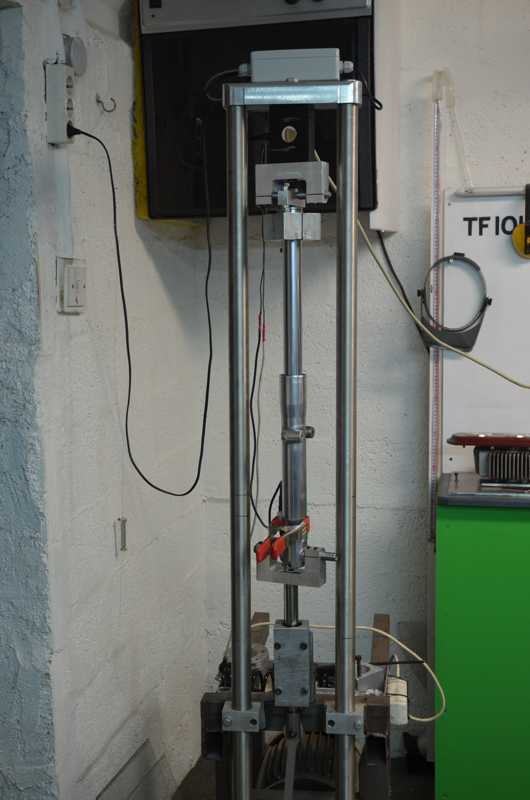

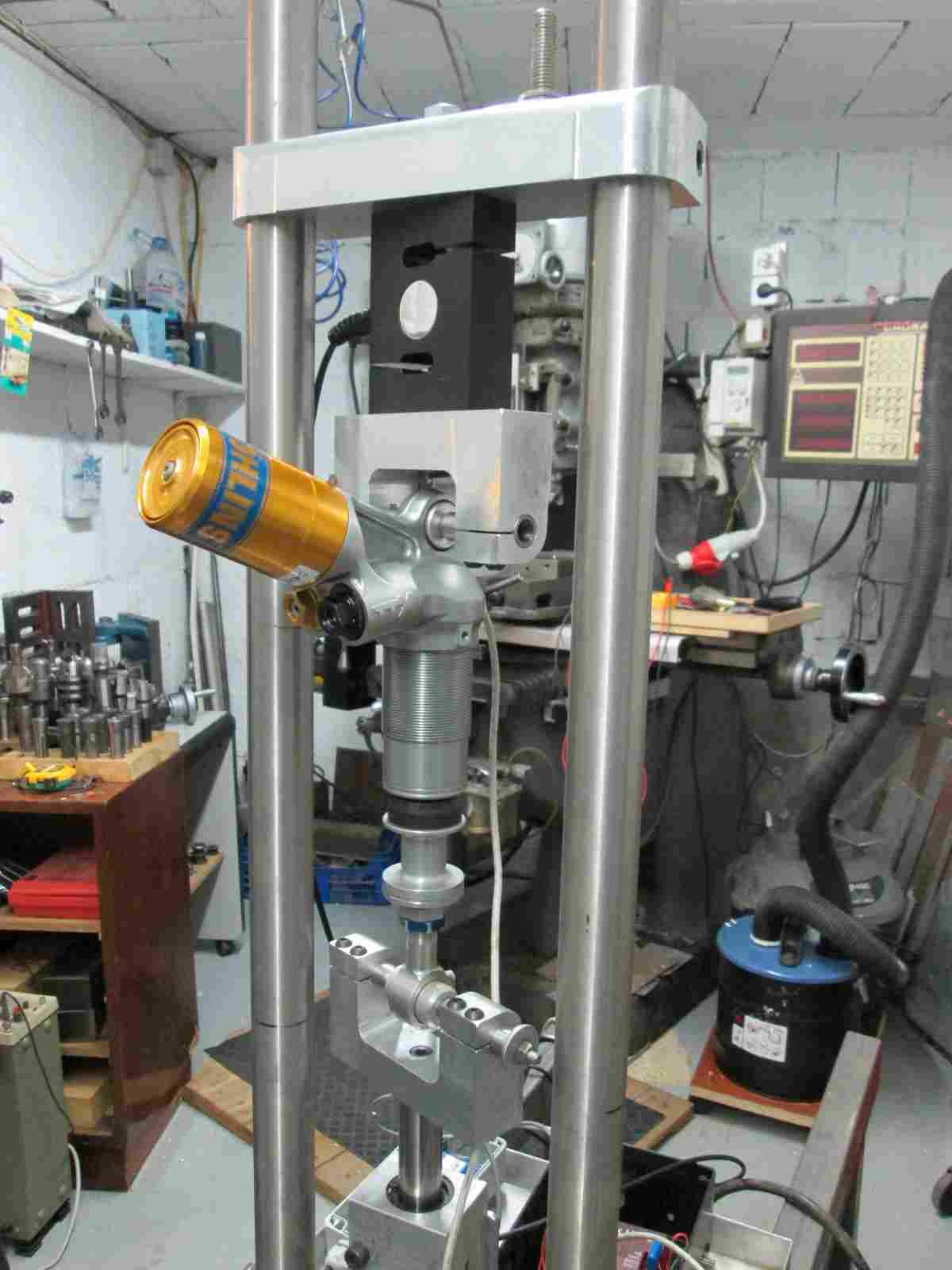

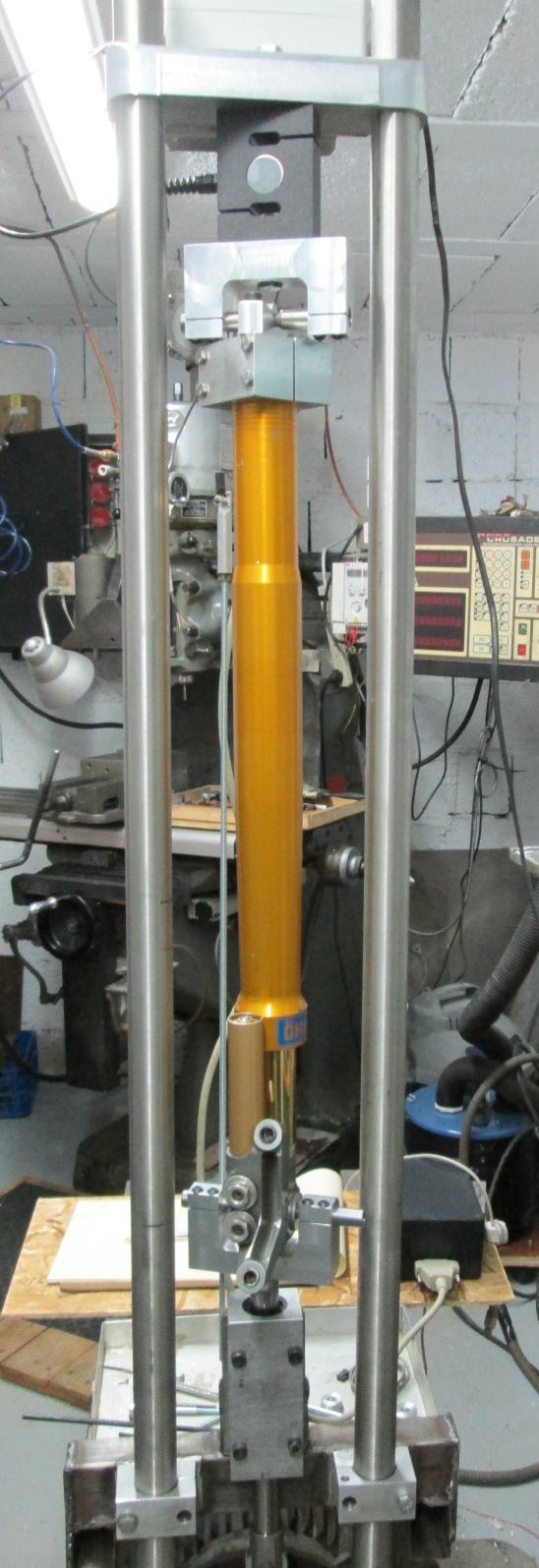

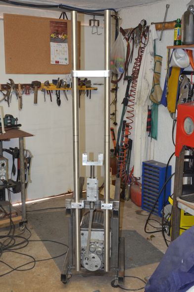

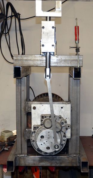

My need is to develop rear shocks and front forks for classic racing motorcycles and my budget does not run to an hydraulic or electric device so I decided to build my own take on the mechanical type. The following shows the completed tool with an Ohlins shock mounted.
Attachment 15970 Click thumbnails for full size.

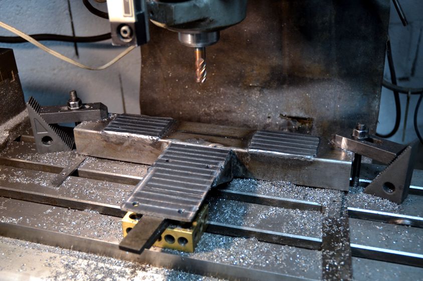

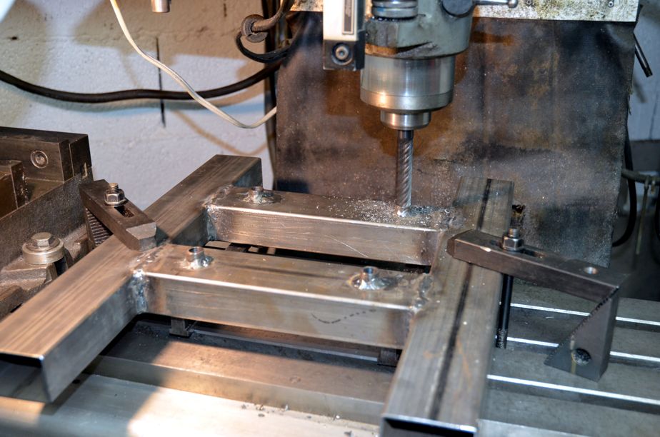

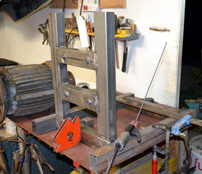

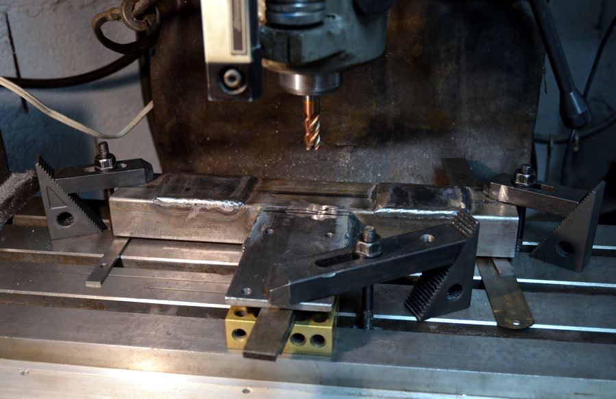

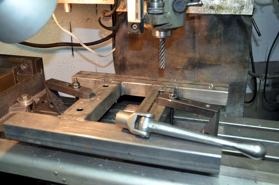

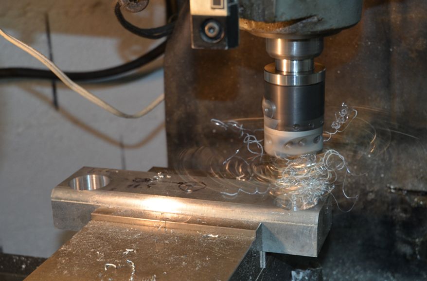

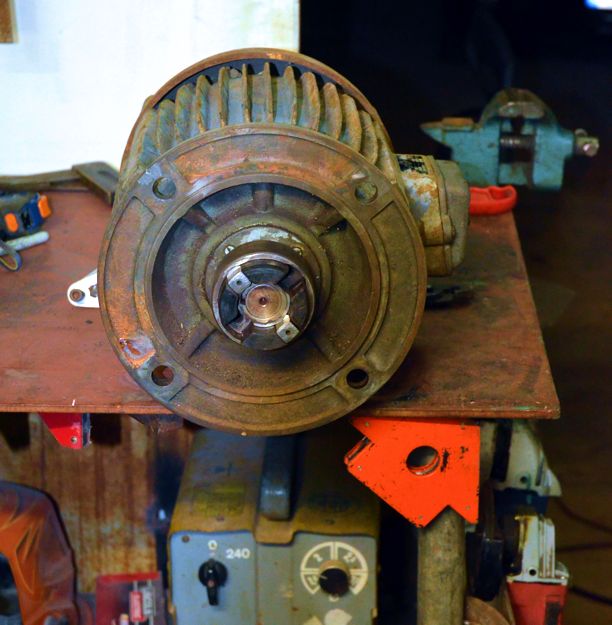

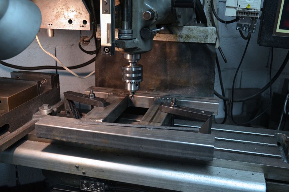

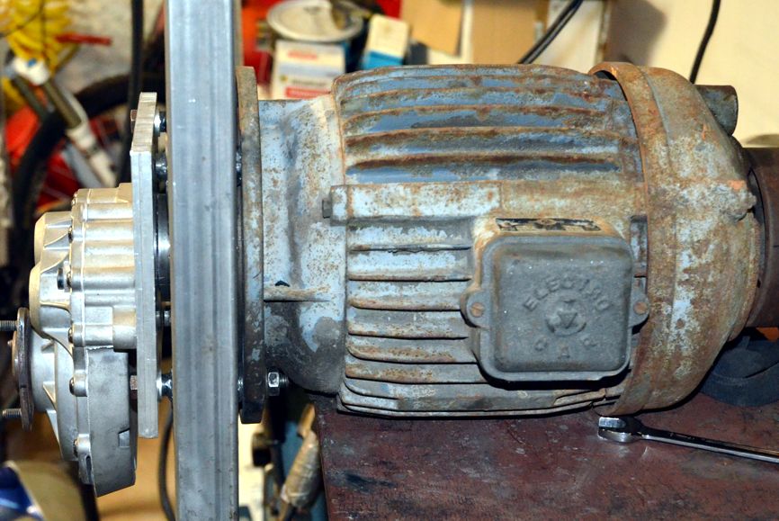

On the left is a 5 hp 3 ph motor which I kept from an old lathe which I had earmarked to power the machine. It was a flange mounting motor, I'd have preferred a base mounted type for ease of fitting. The start of the motor mounting is shown on the right being setup for making the holes for the mounting bosses.

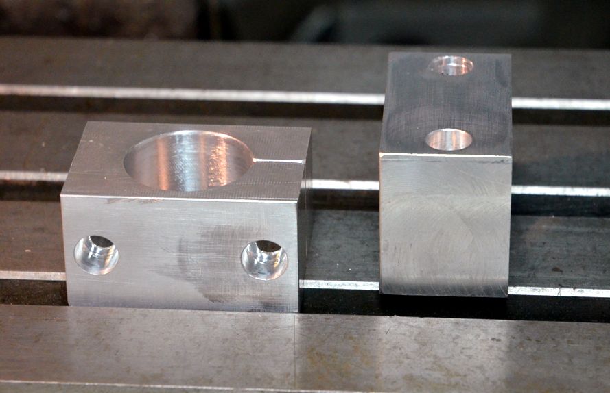

Attachment 15973 Attachment 15974
Preparing holes for the mounting bosses and then machining the bosses level.
Attachment 15979 Attachment 15980

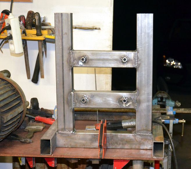

Attaching the motor mounting sub-frame to the base frame.

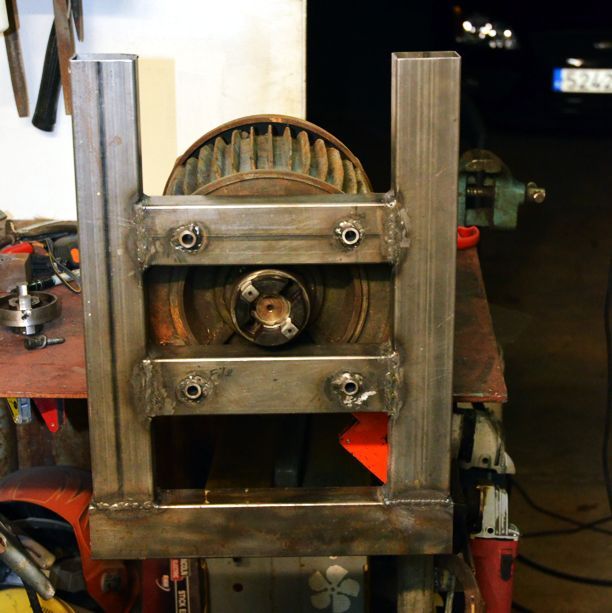

Attachment 15975 Attachment 15976

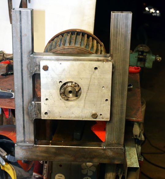

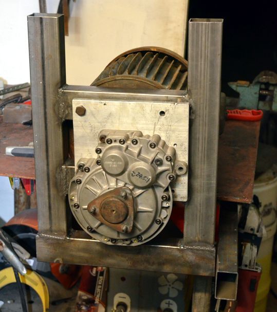

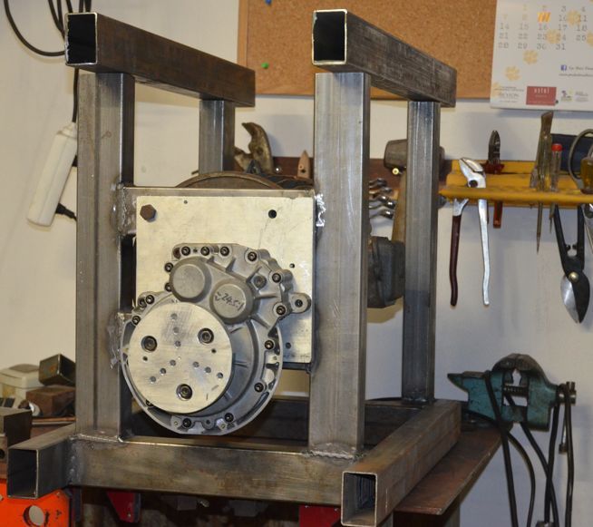

Here we have the motor mounting frame welded to the base, and also the mounting plate for a reduction gearbox.
Attachment 15977 Attachment 15978
Showing both motor and 25:1 reduction gearbox mounted to the part completed frame.

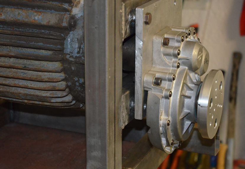

Attachment 15981 Attachment 15982
A couple of views showing the crank plate fitted to the gearbox output shaft. The tapped holes allow different maximum strokes of the shock.

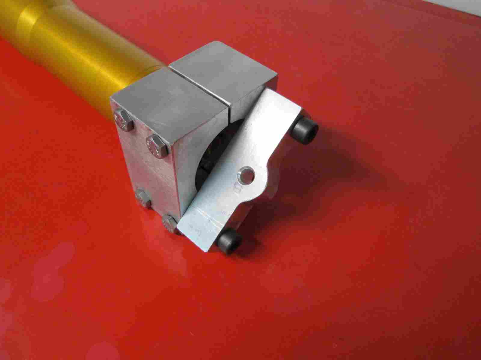

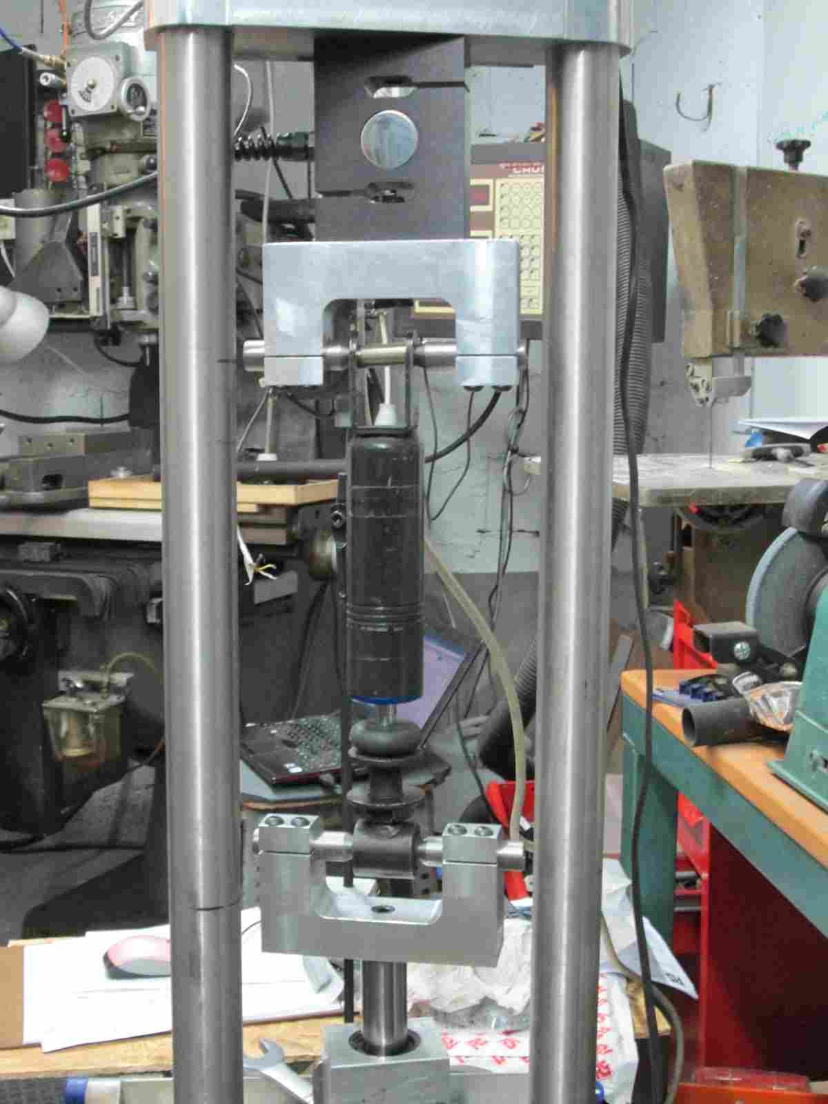

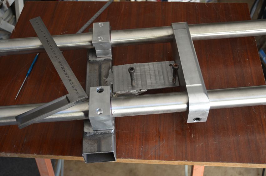

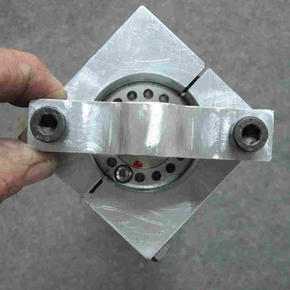

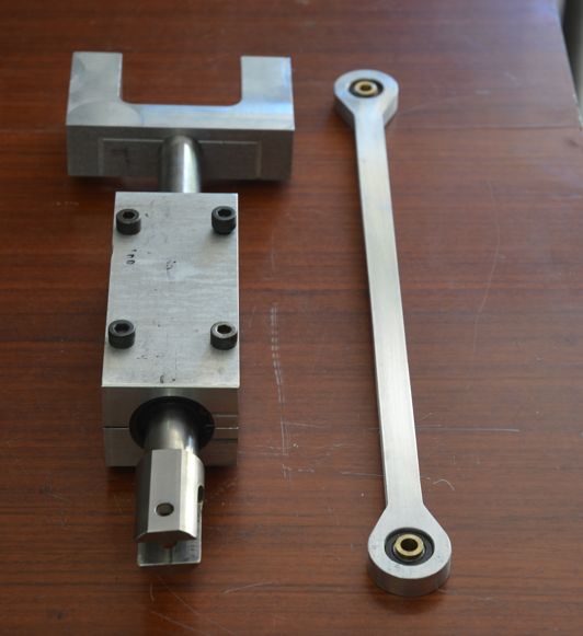

On the left is the slider block and conrod. I had some 1" ID linear ball races so I got a length of 1" Thompson shaft and made an aluminium housings for the bearings. The shaft moves very smoothly with a high degree of rigidity. The yoke at the top is for mounting a shock or fork slider. The second photo shows a trial mockup of the assembly.
Attachment 15985 Attachment 15986 Attachment 15987

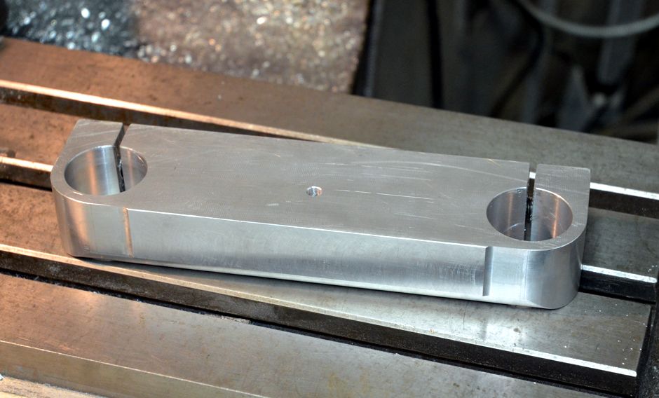

Making the top support bracket for the two uprights. Below are the two fixed lower mountings.
Attachment 15988 Attachment 15989
The sub assembly for mounting the bearing block and mountings for the uprights.
