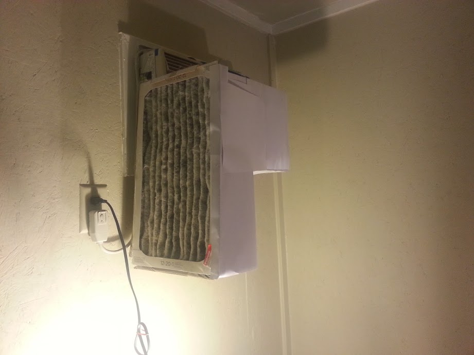

1 Attachment(s)
That's badass, puts my ghetto fabu-cation to shame but wouldn't them bening in a shared chamber make the fans kinda fight each other decreasing efficiency and increasing motor heat? I was going to make one out of bounce house fan (from the trash) but that thing is louder then a vacuum and in the barn i live in there is only a limited amount of electricity and it took too much of it
Attachment 18102
Nice build mr95gst.Looks great.
Nice Job! Do you think that a furnace squirrel cage blower would have the pressure to get the cfm thru the filters? I have scavenged several and the cfm is high and they are quiet. Thank you.
