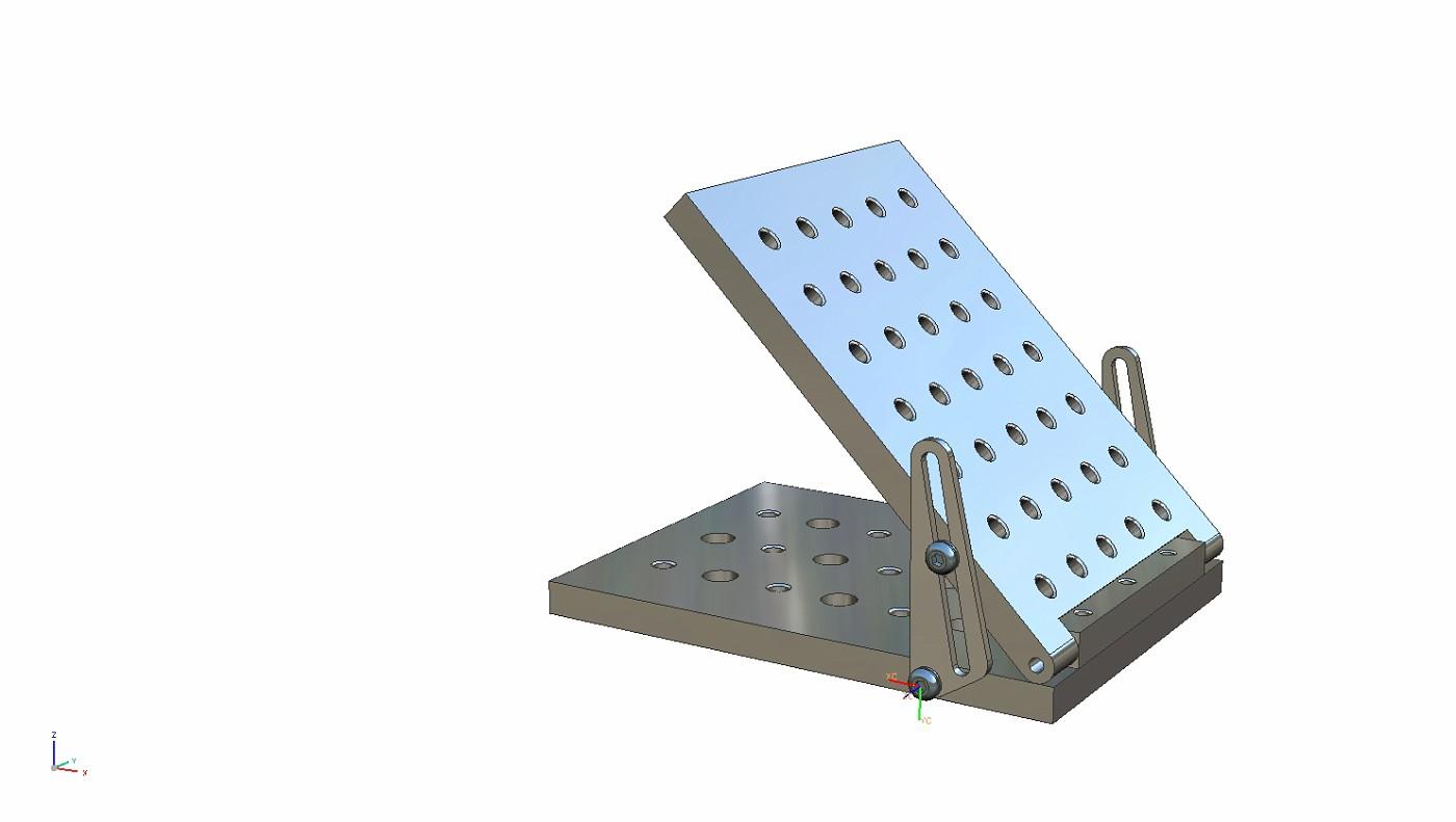

Here are some screen shots of my version of Fred Giesler's design that was in the Dec. '95 PIM. I made it a bit bigger and went with 1/2" plate instead of his 3/8th's but it is essentially his design.
My plates are 6 x 8 and I designed the side guides to allow the table to go to 90* verticle also.

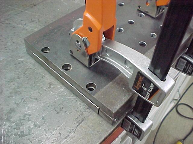

Doing a trial fit. Everything looks pretty good.
http://images60.fotki.com/v662/photo...MVC017F-vi.jpg
It opens up just as planned! Now to get the side plates made.

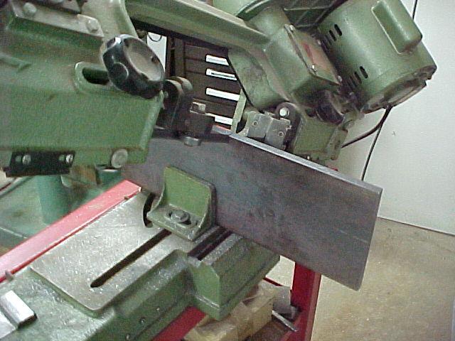

I got out in the shop this morning and knocked out the side plates. I used a piece of 1/8th in strapping I dug out of the scrab bin.
Laying out the pattern on one of them.
http://images58.fotki.com/v511/photo...MVC001F-vi.jpg
i cut the plate in half with my bench shear. Easy.
