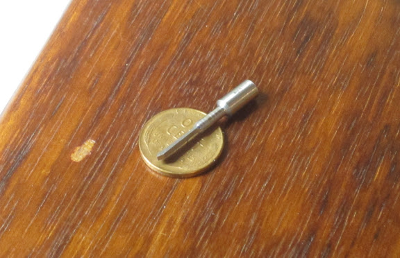

Shop made drill bit
I mentioned my use of a shop made drill bit in another post, in fact I have a dozen or so drills and cutters that I've made as needs arose. Before I bought a set of screw machine length number drills, I found myself making the occasional drill to get me through a project. This type of drill I'm showing here is what's known as a spade drill, and is commonly used in watchmaking. Many of the watch repair and watchmaking books give instruction for making these. I have made them as large as 0.333" and as small as 0.75mm. You can shape the tip to center cut, but for most of mine I didn't bother with that, and I just drill a pilot hole first. They leave very nicely finished holes this way.
The one I show being made here is the 3.3mm bit I used as a tap drill for M4 threads. There is a bit of simple lathe work, then the rest is filing, heat treating, and stoning.

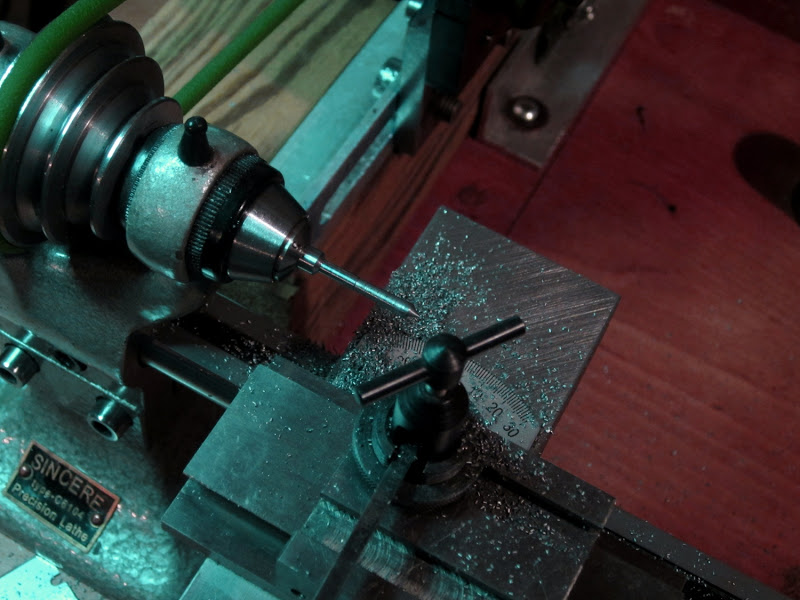

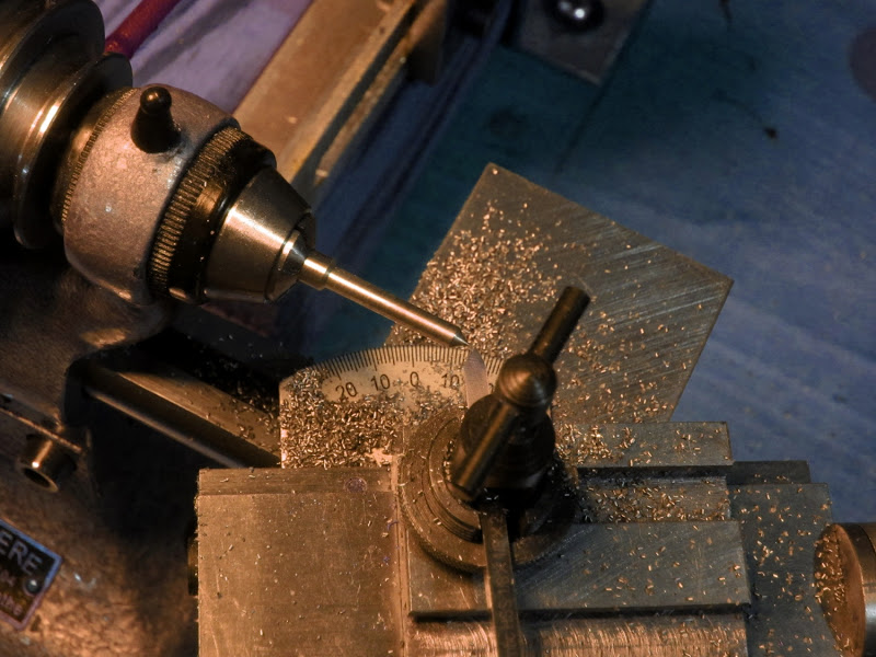

I like working with O1 and W1 tool steel, but any good tool steel or high carbon steel that you can heat treat yourself will work just fine. Here, I'm starting with some O1 drill rod chucked into the tiny lathe:
Attachment 4808
I start by turning the major diameter and the point taper. The angle of the point taper is completely up to you, the wider the angle, the less cutting force should be required but on the other hand they would have more of a tendency to wander. I tend to make my points a pretty narrow angle, as you can see here, and haven't had issues with chatter or breakage:
Attachment 4809

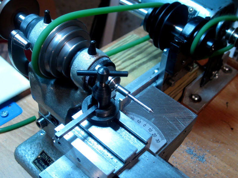

Now, a relief taper is turned behind the point, just a degree or two is plenty:
Attachment 4810

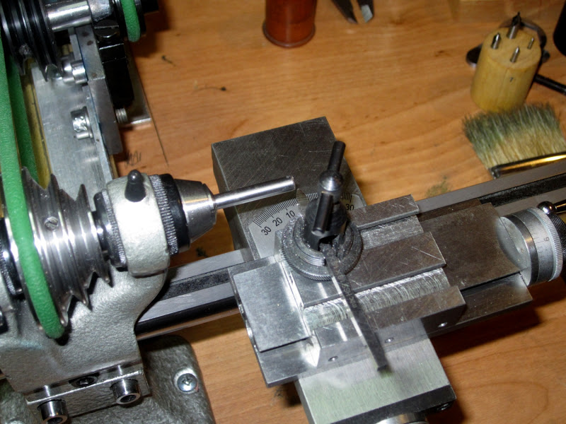

For this particular bit, I knew I'd need it to have more reach than usual, so instead of parting it off at that small diameter shank behind the taper, I parted it off at the full stock diameter, well behind that shank. I sized it so that the narrow shank behind the relief angle would get me just enough reach through the part I needed to drill. Here it is, being parted off:
Attachment 4811

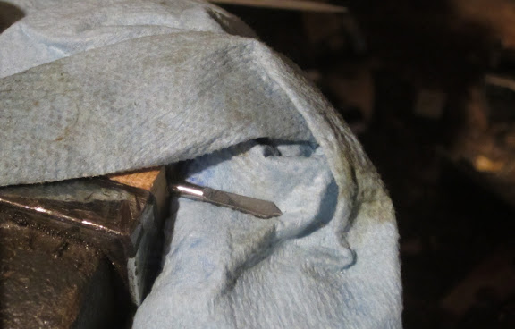

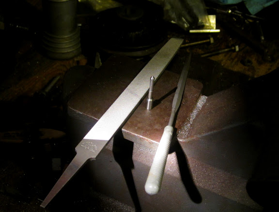

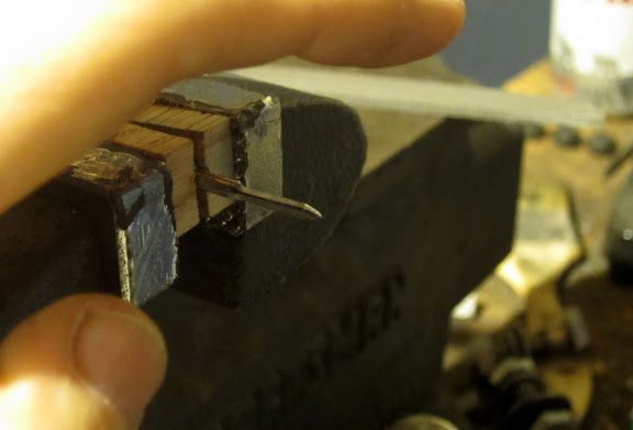

Now, the filing begins.
Attachment 4812
I start by filing a pair of opposite flats:
Attachment 4813
Attachment 4814

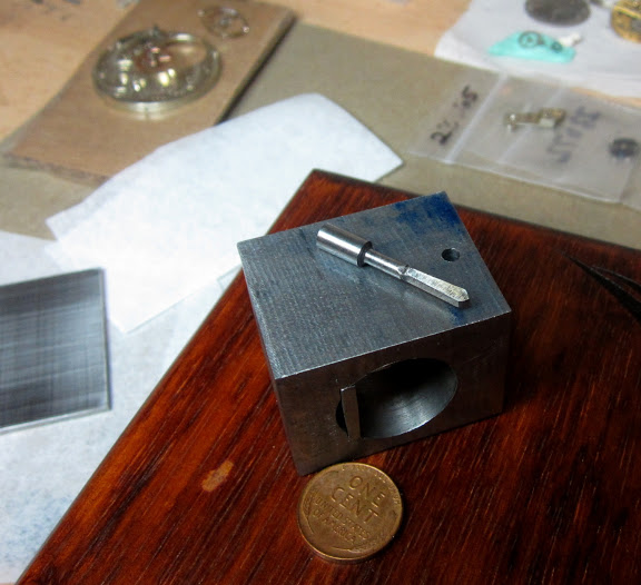

The remainder of the outer edge is coated in layout blue (or, in my case, blue marker), to use as a guide:
Attachment 4815

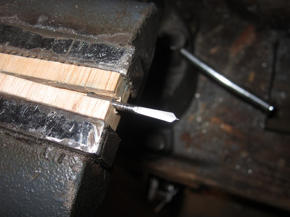

The important edge to be formed is the one at the point taper on the end of the drill, this is really where the cutting will be happening. As long as you are careful to bring the cutting edge all the way to the full diameter, there is no need to continue the edge up the relief taper, as I do here. In this pic, you can see the angle being filed down through the blue. Make sure you pay attention to whether you want to have a left or right hand cutting bit here.
Attachment 4816

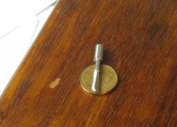

File until there is just the faintest trace of the blue guide left:
Attachment 4818
Attachment 4819
Even for fairly large size bits, there is such a small amount of metal to be removed, that the filing really does go quickly.

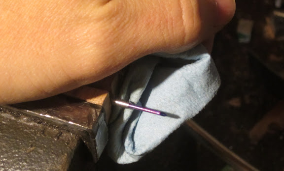

I won't get into specifics of hardening and tempering here, as much of it depends on exactly the steel you are using, but I will offer some general helpful hints. When in doubt of the appropriate quenching medium, all but the most exotic tool steels I'm aware of will still harden up just fine in warm water (the hard layer created won't necessarily penetrate as deep, and there is more risk of warping and cracking, but depth of hardness probably won't matter much in the home shop, warping can be managed, and I've yet to have an issue with cracking). Speaking of warping, plunging the work perfectly perpendicular when quenching will help a great deal. Rapidly move the part vertically in the quench, to avoid gas pockets forming around the part (those gas pockets can lead to soft spots and greater stresses). For very tiny drills, making two or three parts to flank the delicate portion (or even the entire part) during heating and quenching can make all the difference in the world if you're having difficulties with warping. Bind the flank pieces to the part tightly with steel wire, and heat/quench the entire thing.
The file test will confirm whether you've had a good harden. After that, polish up the surfaces and gently temper it. I recommend a pale straw temper, unless you know you'll only ever use the bit on soft metals, in which case a wine or dark purple temper would be acceptable. After tempering, just use a small bench stone or stone slip to sharpen up the cutting edges.

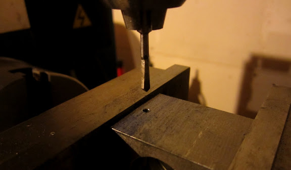

Here is my completed bit, about to start opening up a pilot hole:
Attachment 4820

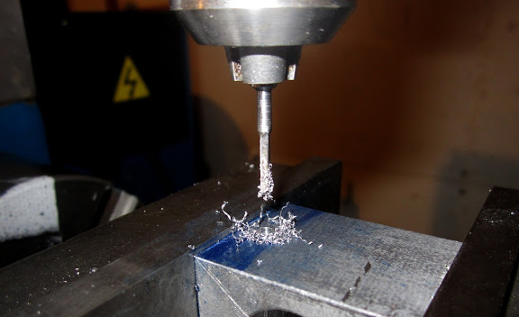

And here is the result:
Attachment 4821
Attachment 4822
As you can see, it makes a nice tidy hole.
