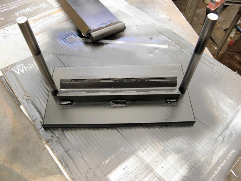

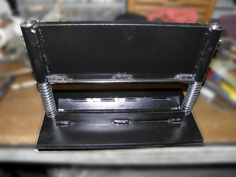

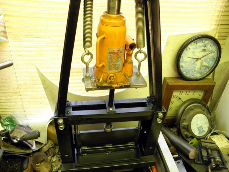

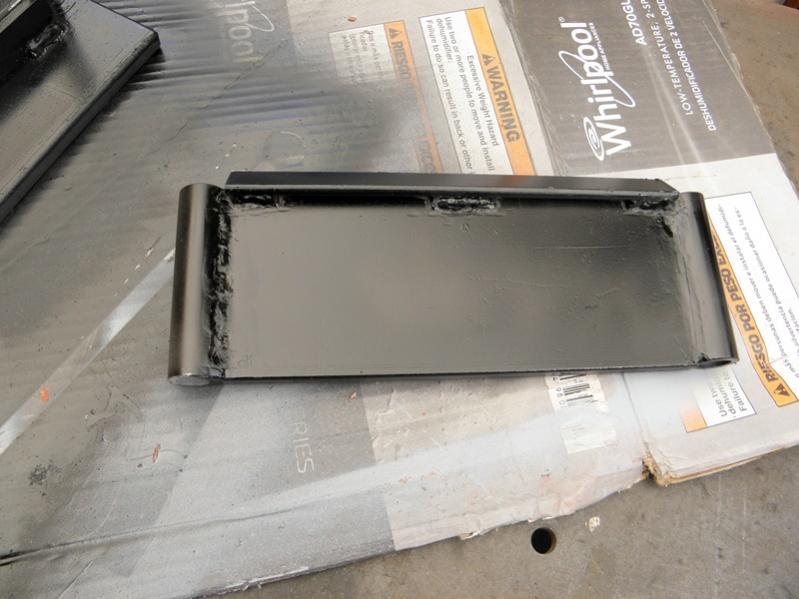

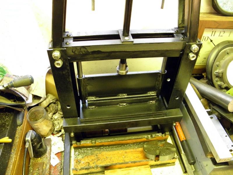

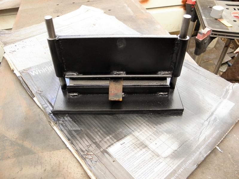

Shop Press Metal Bender. Made from 1/2 " steel plate 1x 1/4 " angle steel, 1" x 1/4" bar steel and 5/8 solid rod.

Nice work as usual, capainleeward. I've seen similar versions before, where the jack pushes down. Any reasons for this besides packaging?
I guess I just like things right side up and level ---0--- :lol: Hi DIYer......:)
