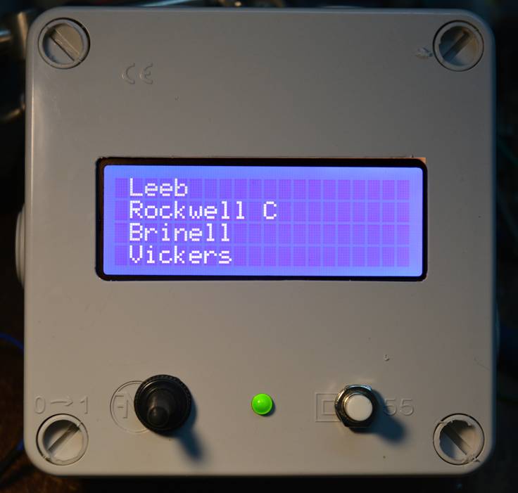

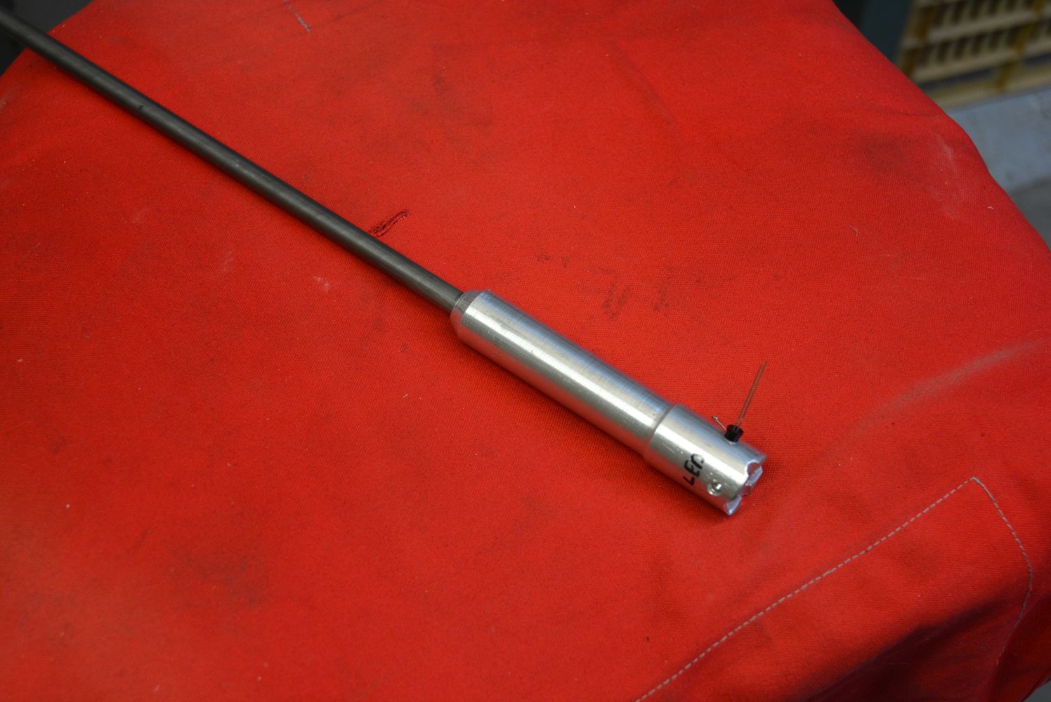

    If you continue with your own made indenters there is a simple way to do better than using STEEL ball bearings. If get an old or broken carbide milling cutter of the right diameter you can grind a hemisphere on one end and use that. The carbide is harder than steel balls.
    I found out recently that you can buy carbide balls, they are not expensive. I got a packet of 6 mm diameter for my drop test device.
    BTW as I mentioned I did get around to making an electronic version of the drop tester.
    Shop Press Brinell test-hardnessthingy03.jpg Shop Press Brinell test-hardnessthingy11.jpg Click for full size
    I'll make a post with full details sometime soon.

    Cascao,
    It has been some time now since you last posted anything on this. How have things progressed?
    BTW my electronic version of the drop tester works very well and there have been a few people who have copied it.
