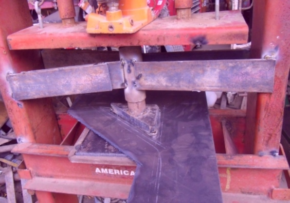

After searching for a year for a suitable replacement cross member for my Chevy truck rebuild I decided to make my own
My shop press has been the platform tool for many projects I actually bought it at a scrap metal salvage yard for $20.00 then added my air over hydraulic 12 ton jack

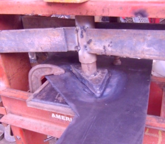

this project deals with a punch and die to form the dimples in a sheet of 3/16 plate
Attachment 5139

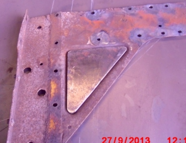

The punch was cut and shaped to fit in the dimple
Attachment 5140

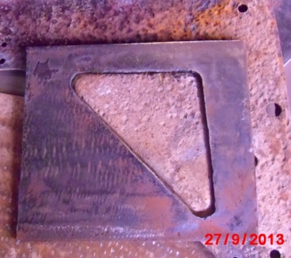

then I did the same with the die
Attachment 5141

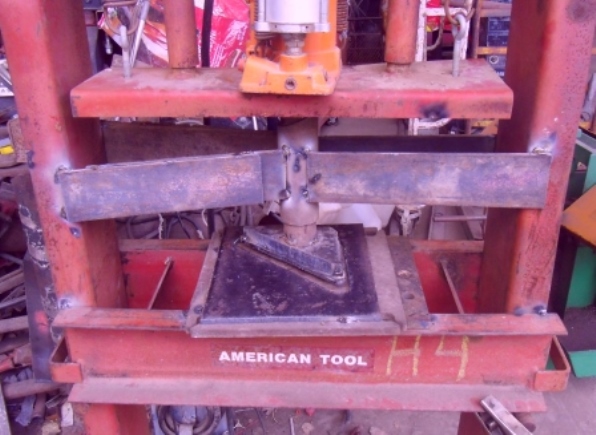

the lay out done and positioned ready for forming
Attachment 5142
pressure and a judicial amount of heat with some massaging with a hammer
Attachment 5143

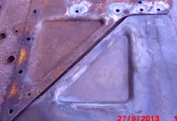

The end results are worth the effort
Attachment 5144

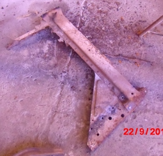

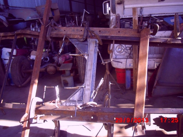

What I started our with
Attachment 5145
What I ended up with
