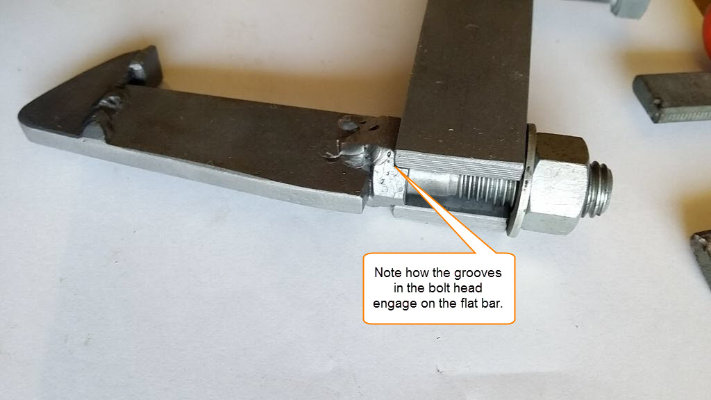

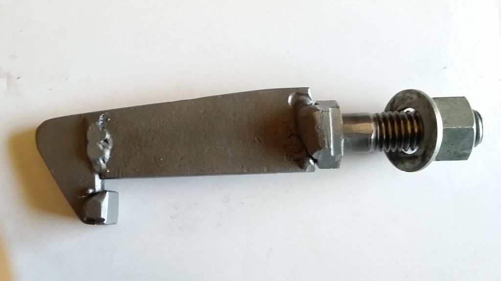

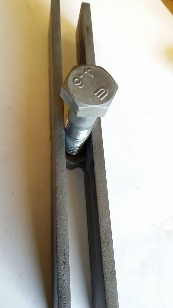

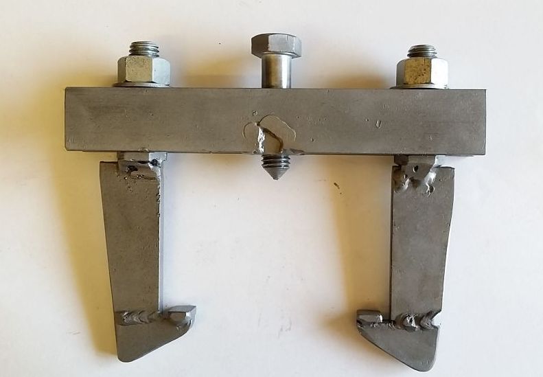

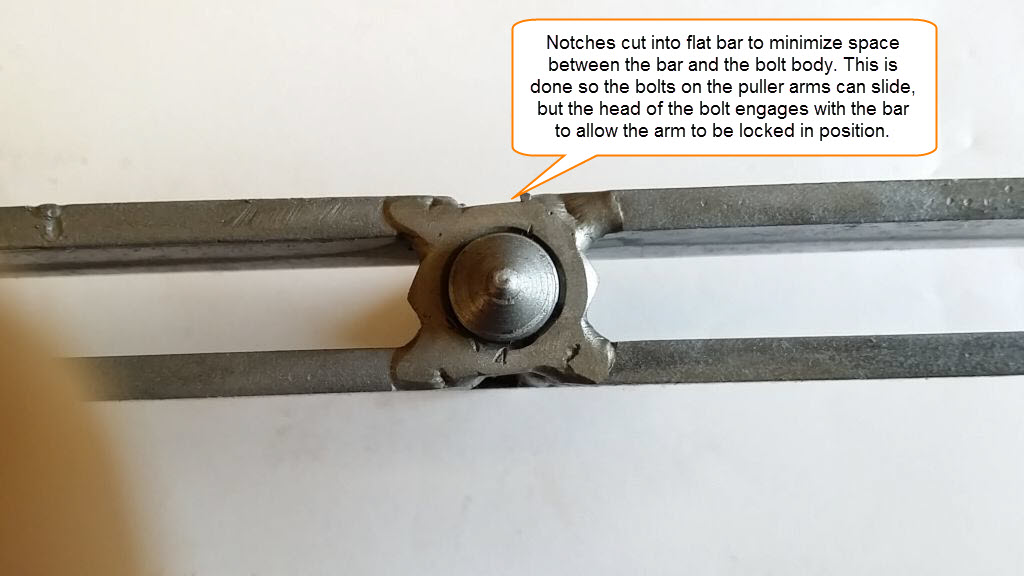

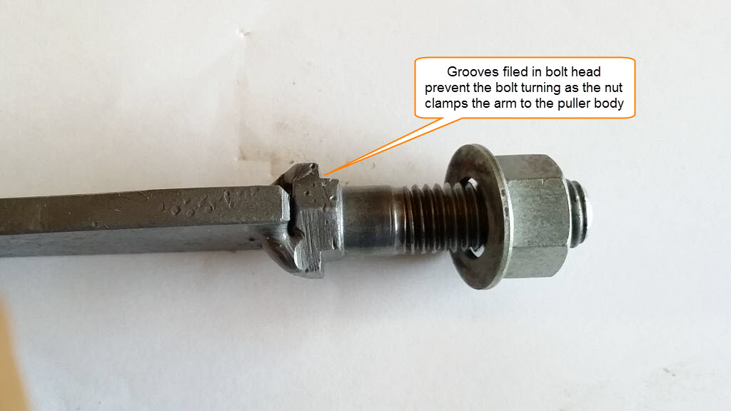

While helping a friend with a squeaky (automotive) air conditioner pulley, I had to remove the pulley and its bearing (the noise problem). This had to be done without removing the ac compressor or any associated fittings. So the job had to be done in situ.
Obviously I needed a puller to remove the pulley and bearing, but with only a couple of inches between the pulley and the radiator, none of my pullers would fit.
So, back to my workshop and about an hour with a hacksaw and welder I came up with this “short” puller. The overall depth is approximately 4” and about 6” wide. The puller uses only a short piece of 1” x ¼ flat bar, three 10mm bolts, three nuts and two washers.
I think the images convey the rest of the details.
Kind regards
Peter
Attachment 8684 Attachment 8685 Attachment 8686
Attachment 8687 Attachment 8688 Attachment 8689
Hi Peter,
Very good job,
only a small suggestion to increase the performance and the life of tool
the use of a fine thread bold and a long nut is a better choice.
Regards
Bill
