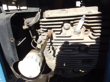

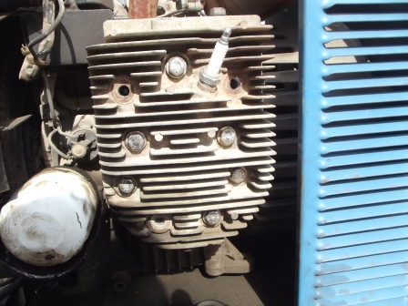

I bought a Miller Bobcat welder for real cheap at an auction because it had 3 broken head bolts and several other missing parts.

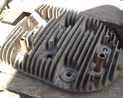

To repair the broken bolts I first removed the head to have a look at possibly simply welding a washer and a nut on the to remove them. No such luck this meant I would have to drill them out.

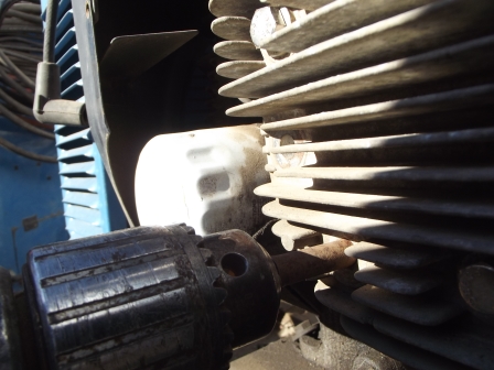

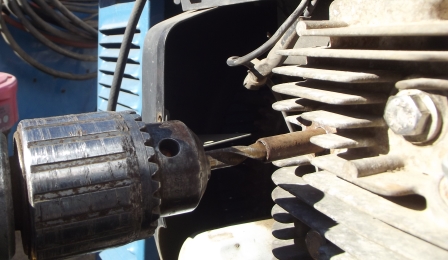

So I found a piece to steel tubing that fit very tightly in the holes of the head Actually it was tight enough to require tapping in place with a hammer the inside diameter was small enough that the drill bit I needed to use would almost drill out the entire body of the bolts leaving a thin shell and the threads.
after drilling out the bolts all I had to do was use a small seal pick to break the remaining thread piece out
the Guide served to hold the bit centered as well as a depth gauge for my drill Attachment 9639 Attachment 9640 Attachment 9641 Attachment 9642 Attachment 9643

This looks like a winner. I will try this technique next time when drilling free hand or on the drill press. Thank you,
Paul
Good one Frank, you don need no stinking EDM!
Helps to have all kinds of scrap laying around, never know when it's going to save your bacon.
