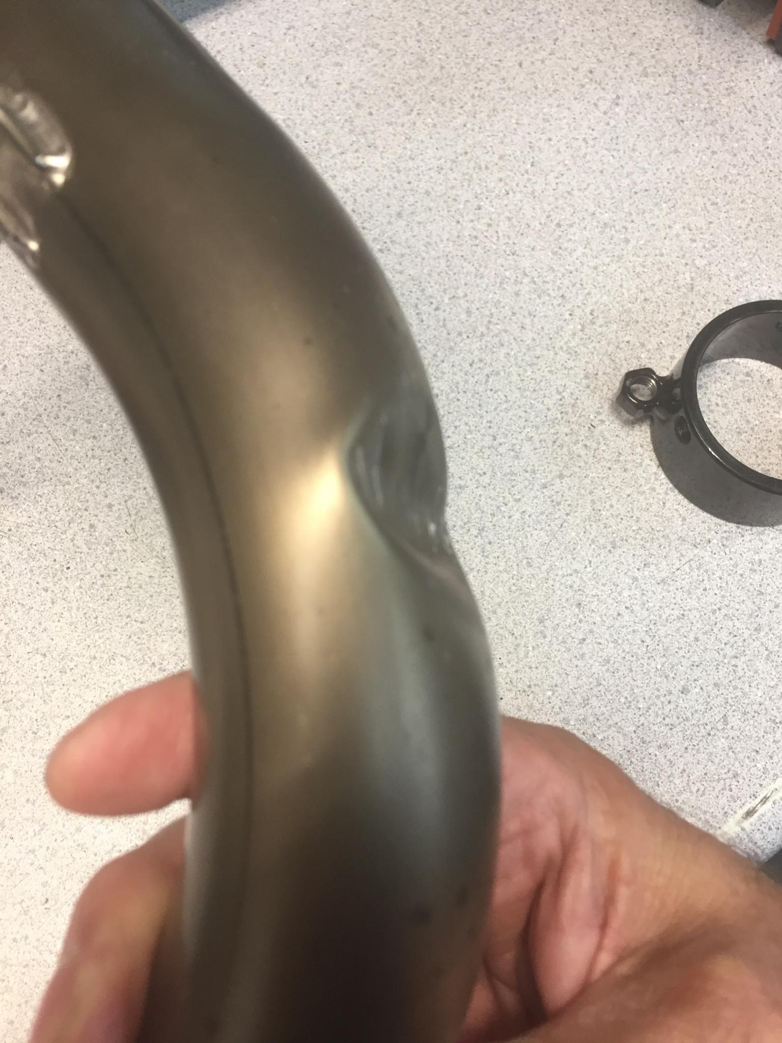

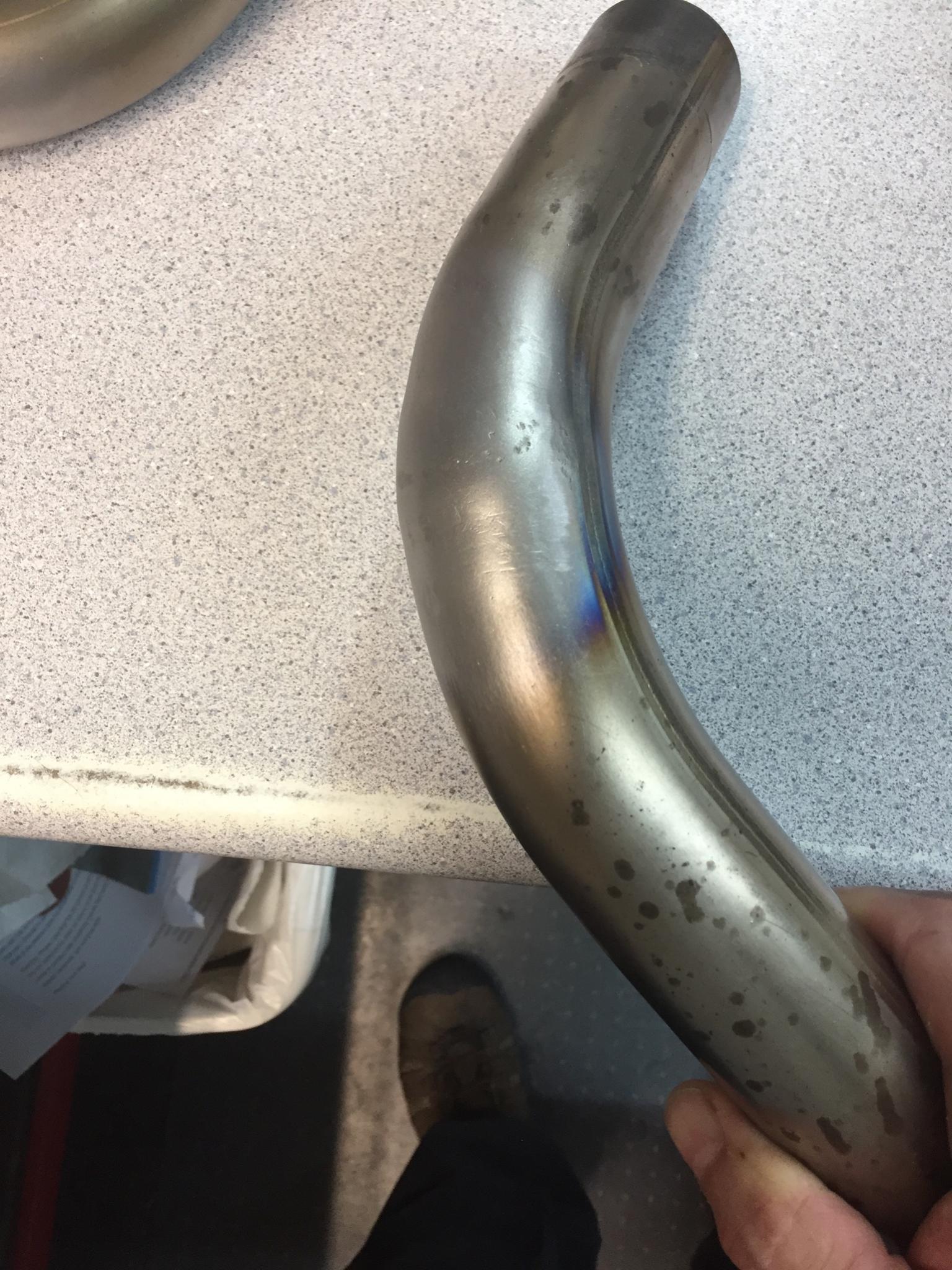

I just finished taking this dent out of a Titanium motorcycle exhaust.
Interesting tricks in that video!! Just ordered the sander....THANK YOU!!
Attachment 18619Attachment 18620
