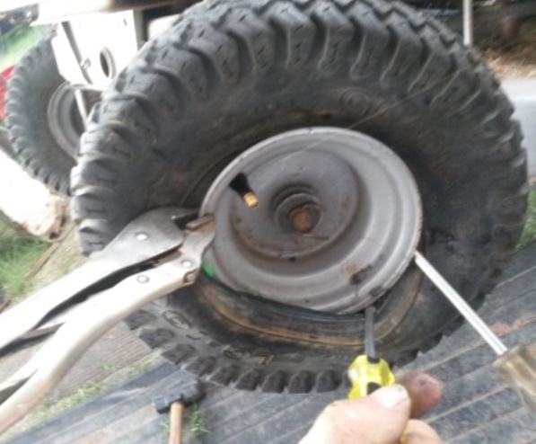

after the bead is broke loose from the rim it is time to remove the tire, since these tire are too small to use my regular tire irons on I again have a couple of old flat tipped screwdrivers to serve as my tire irons the blades on them are dull and rounded so they don't cut into the rubber
To remove the bead you first have to figure out how to secure the assembly since they are small usually placing a foot on one side of the tire forcing it down while inserting both screwdrivers between the tire and rim a few inches apart opposite of you foot then gently prying them over until the bead begins to rise above the rim the work one screwdriver around a few inches more and prying again repeat this until the bead has been completely removed from the rim. Repeat the process for the second bead repair or replace the tire then when it is time to reinstall getting the tire back on the rim is harder than removing it as it is free to move around and you must first get the bead started over the rim and somehow keep it in place while you work your way around, the first Bead is usually pretty easy as you can slam the tire down at an angle forcing about half the bead on in 1 push then finish with the screwdrivers the second bead you do not have that advantage so you must some how repeat the process without the advantage of being able to slam it on

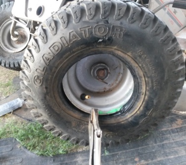

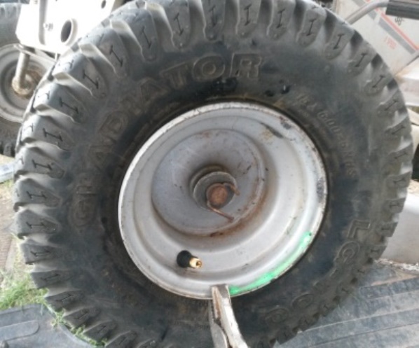

Here's what I do I will hold part of the bead down below the edge of the rim while I snap a pair of locking pliers(vice-grips) or a very small C clamp to the rim This will serve as a holding point while I work the remainder of the bead around the rim with teh screwdrivers.

Attachment 17144 Attachment 17145 Attachment 17146
It only takes me about 5 to 6 minutes to be back mowing But today I had decided that I was fed up with patching the tubes 1 of them has 8 patches on it, so I pulled the tubes then installed stems and poured a quart of black tar slime in the tire then just put the bead back on and aired it up
