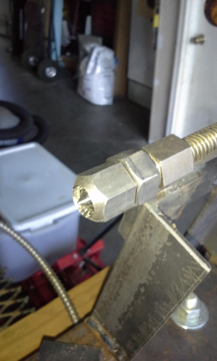

Some additions/modifications...
Attachment 1852
...a cup drive. Somewhere I read that this is safer than a drive with prongs, as bad things aren't as likely to happen in the event of a 'catch' (i.e., drive spins, but work gets caught by the tool...). I have yet to try it, but seems reasonable. Time will tell... It is a bit on the homely side, but I ended up making the drive using what I had on hand. I may decide to machine a proper looking one, but for now this is it.

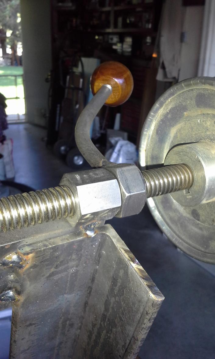

I also needed a way to lock the tailstock spindle in place. An easy way (I thought) was just to use a jam nut. The wooden ball handle makes it easy to actuate.
Attachment 1853

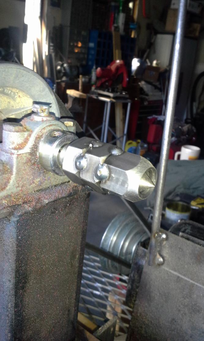

Attachment 1854
...cup for the tailstock.
Aside from perhaps a coat of paint, that's about all I can think of for now. I know there will be other attachments, etc., but this should complete the 'basic' wood lathe...right?
