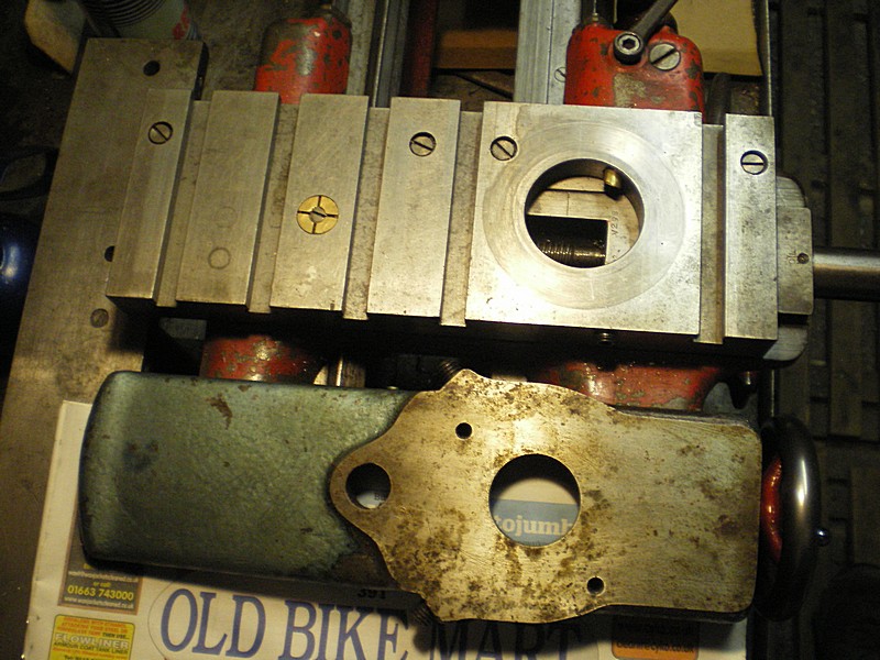

Looks good but not every one has a cross slide like you on the lathe. I bean thinking of building one like you have. There was a seller of castings for that table. Do you know hew that was.

I’m not sure if you have followed any of my other posts but I am bit of a skip diver/dumpster diver depending on which side of the pond you are. This was another one of those scrap yard finds, a nice piece of ground plate which I then machined to suit the Colchester cross-slide and then drilled and tapped the M12 fixings holes.

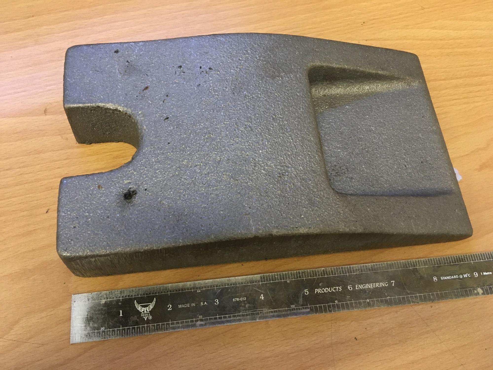

On finding items. This was in a skip yesterday a nice piece of cast iron. It’s from a desk lamp base, all I had to do was remove the plastic case which was only clipped together. Again, a very usable piece of stock I can cut pieces out of.
