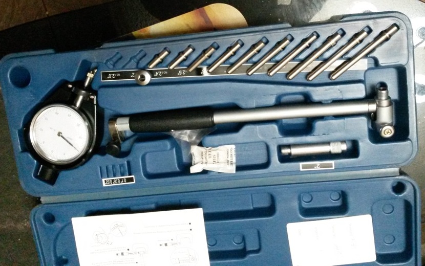

* There are other tools for the job which I won't spend time on here. Inside micrometers, while accurate, require some operator finesse to use properly and can't reach deep into a bore. Bore gauges are super accurate and can reach deeply but are super expensive and usually well beyond the home shop budget.
