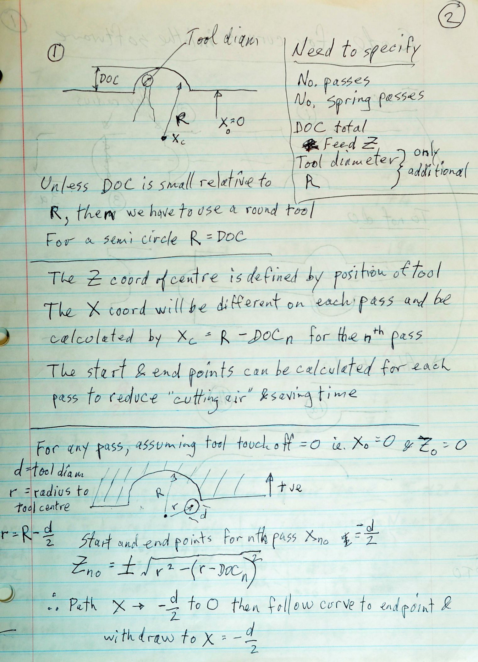

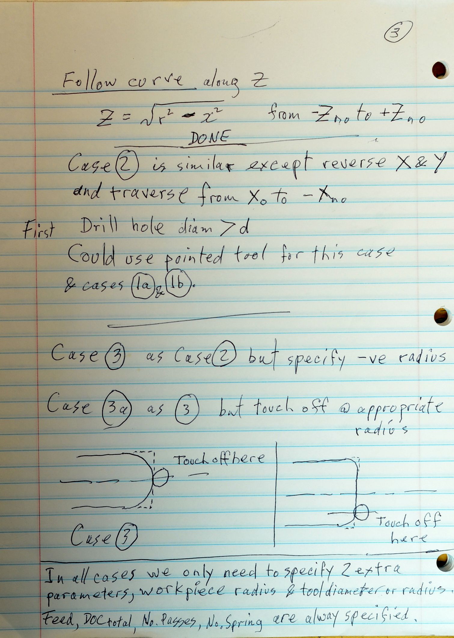

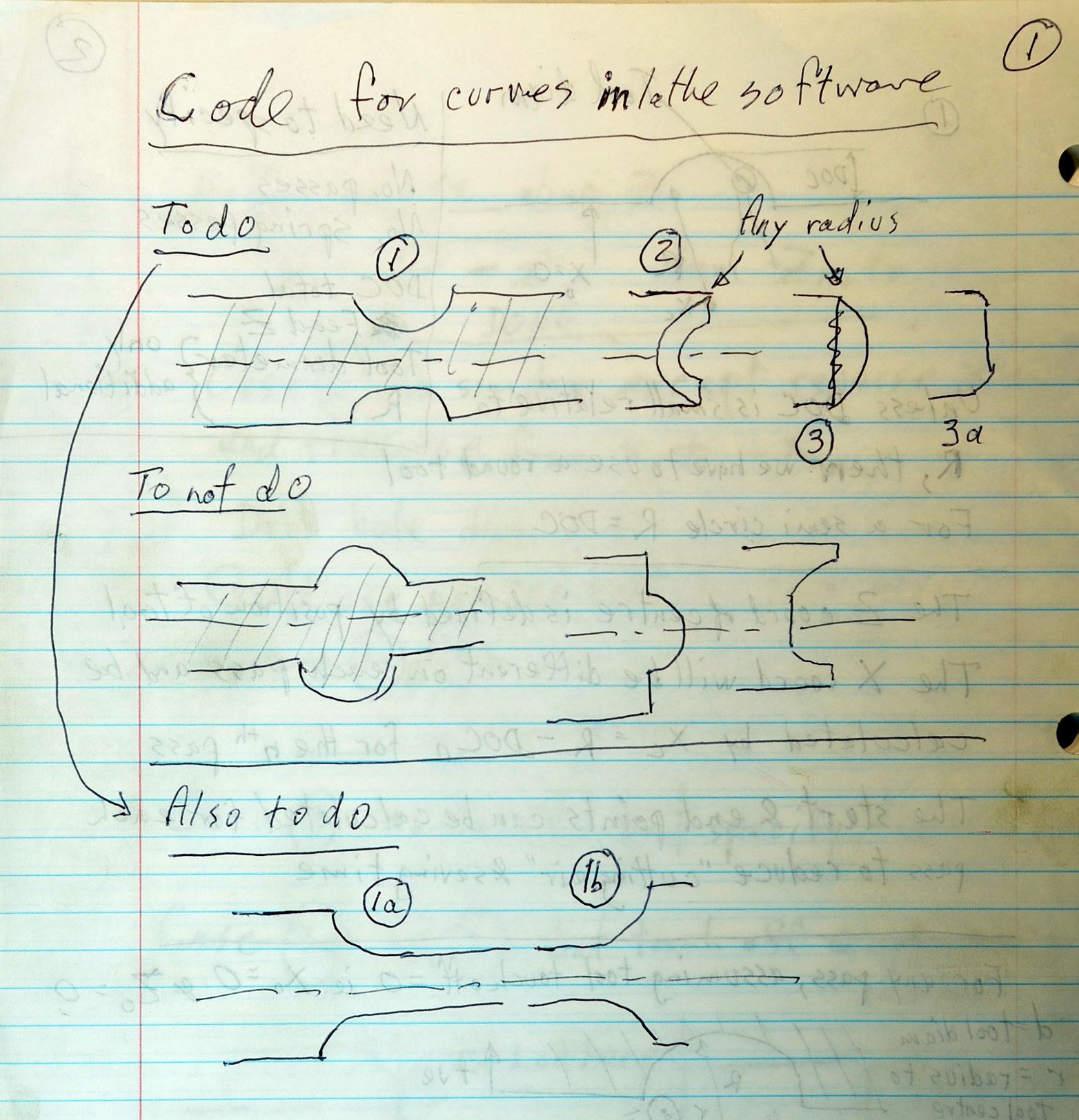

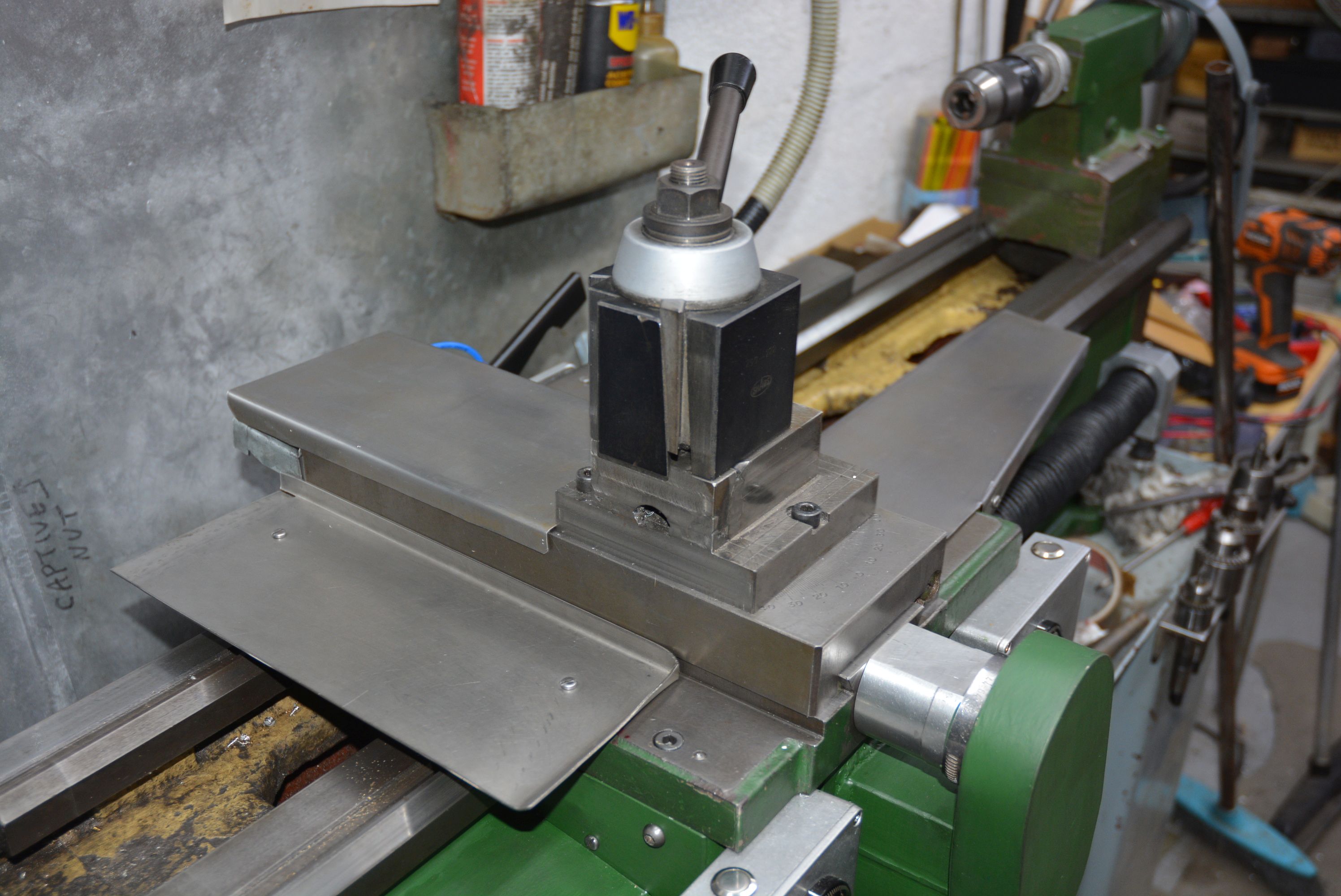

I no longer have the ability to use this ball turner, since I electrocuted my lathe I have no need for taper or ball mechanical turning devices. My electronic control and software takes care of it all for me. What am I talking about? Look here
https://www.homemadetools.net/forum/...662#post182609
So I now use a solid toolpost support without a compound.
Attachment 46798
For the electrocuted lathe
Attachment 46799 Attachment 46800 Attachment 46801

No you are wrong, it doesn't take the fun out of it. It is much more fun using the lathe now.
