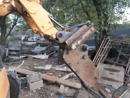

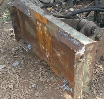

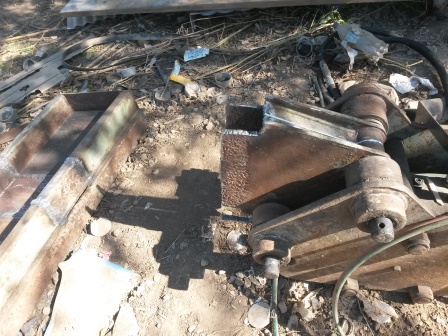

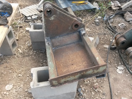

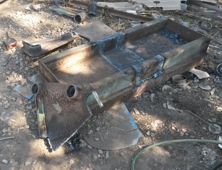

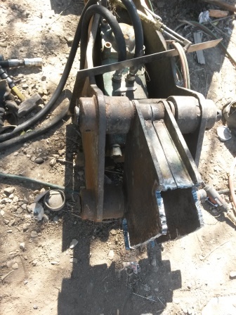

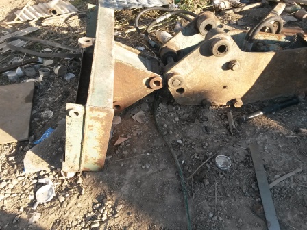

When you have a skid steer that needs a hammer you must also have a mounting frame that fits the hammer and the skid steer machine
One of my oldest customers had a problem he had a small 1000 lb hammer that he couldn't use because it fits one of his machines that is currently not operational He also had a mount for a different hammer that would not fit the hammer of the skid steer. So I cut up the mount to make a new one for him
Attachment 14619 Attachment 14620 Attachment 14621 Attachment 14622 Attachment 14623
The mount is finished except for the final fitting of 2 parts for the skid steer but I need the machine to do that
