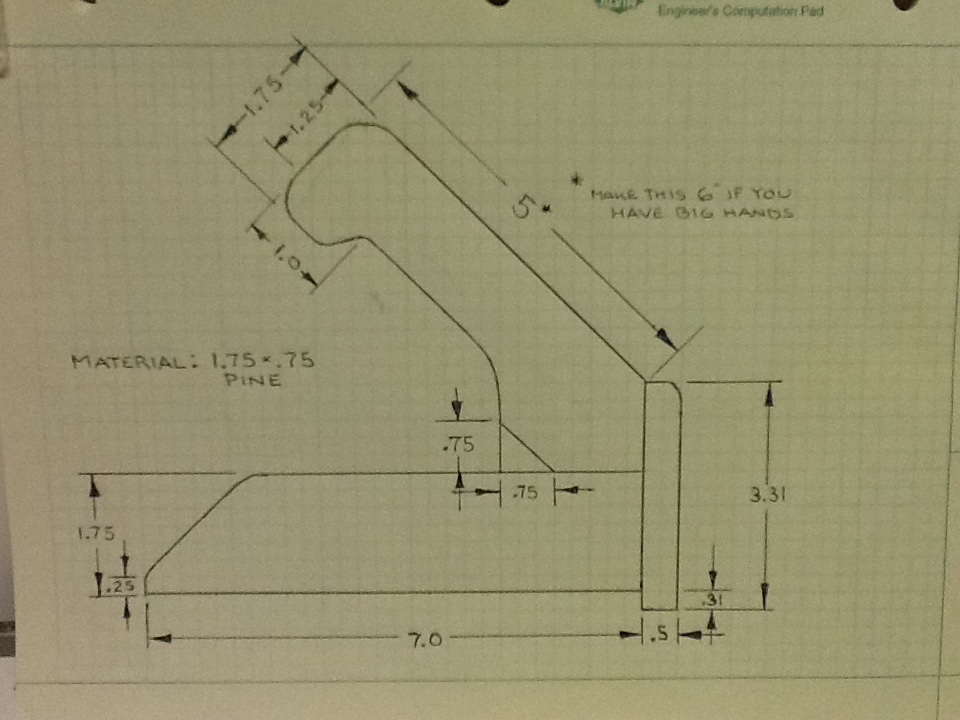

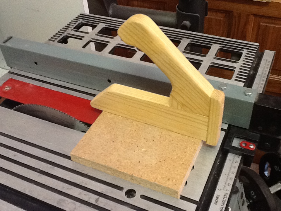

Slick Push Stick
Here is a great push stick that I made to use on my table saw. I love this thing because I can apply a lot of downward pressure on the workpiece, which is hard to do with a straight stick. I used 1.75" x .75" pine and needed less than 16" of material. Like The Donald, I have small hands (size 7.5 gloves). If you have big hands, you might want to add an inch to the handle piece.
Attachment 10644 Attachment 10645
