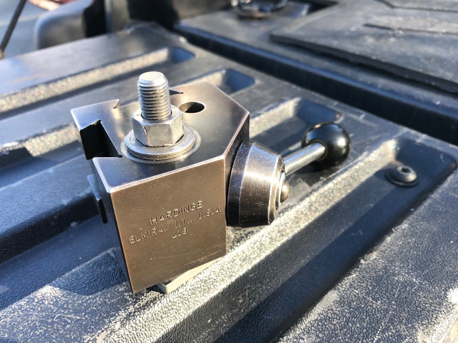

i love the idea of original hardinge L18 QCTP.
Hardinge L18 QCTP the brand new cost US$4000. crazy. not sure their size dimension,
but for sherline-taig-unimat world this size is quite nice.
Attachment 24021
alihureiby,
I agree, the price of a Hardinge QC tool post is way too much money at $4000 a copy. It is a very good design though. The original Hardinge is way too large for the little Unimat DB200. My design is much smaller and you can build other attachments to use with it such as boring bar holders, V-block for cross drilling, vertical slide for milling, etc. Your imagination is the only limit to what can be added to it.
