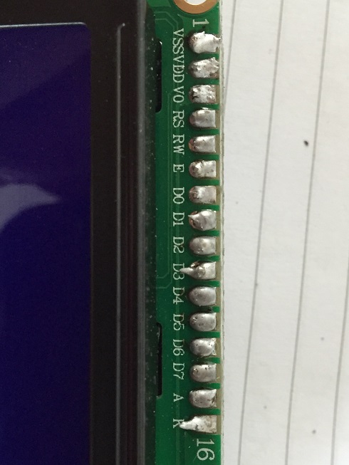

New parcel from AE has just arrived after 6 months. 2 x 16 LCD display. Need to do some very fine soldering (16 Pins) to connect a I2C module to it. This reduces the 16 input pins to 4 input pins bla bla bla..

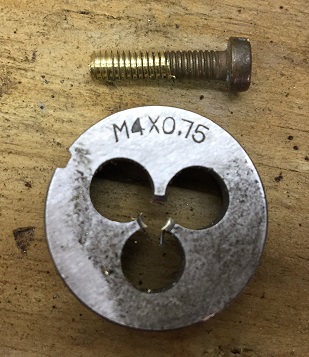

1) It turned out to be a M4 x 0.75 tread. standard M4 is usually 0.7mm pitch.
Attachment 26970
fortunately I have one of those very cheep set of tap and dies, but with all the sizes.
Attachment 26971

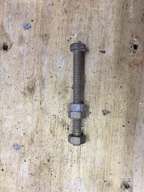

Good enough to recut brass screw, but not all the way....:headscratch:
Attachment 26972

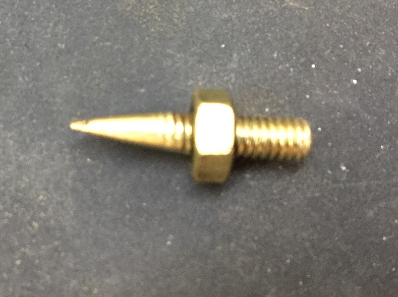

Left a few 0,7 treads so I can screw the nut back on again, in order to be used when ever you want to remove the tip again. Will solder to tip the first time I use it. Once cold this will be fixed so can use a spanner to remove.
Attachment 26973
Done...:rocker:

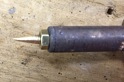

2 Attachment(s)
It actually works quite well. will make one even sharper.
Attachment 26974

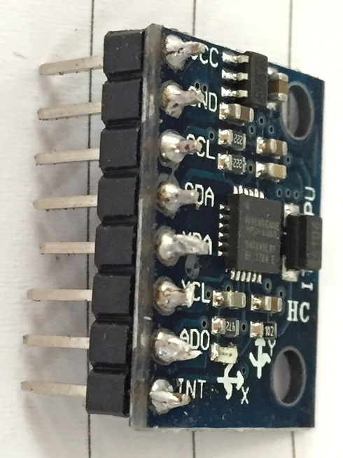

and forgot I had this little 3 axis gyro that needed header pins soldered on.
Attachment 26975
that little board is only 21mm x 15mm and 8 pins. :beer:
