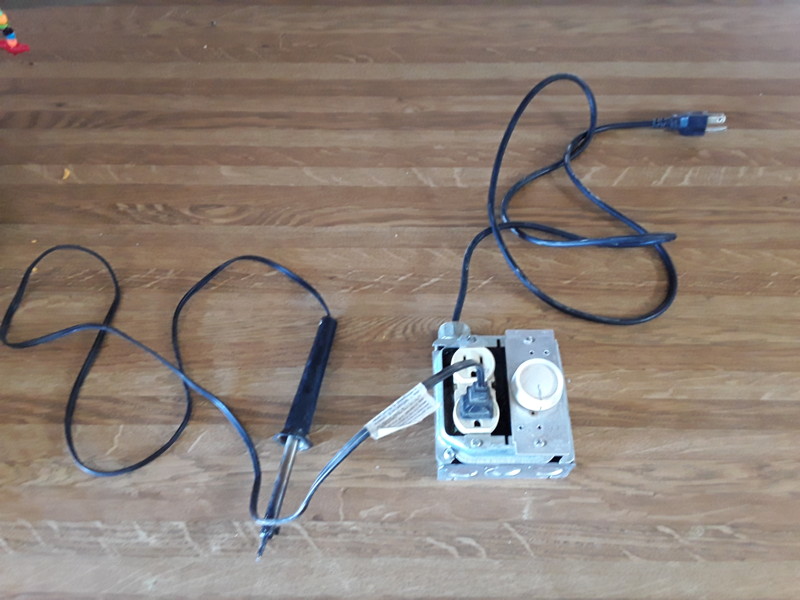

Here is a tool that I use quite often and is easily made. I use it to control the temperature of my $5 soldering iron so I can solder wire or circuit boards easily. I also use it to weld plastics and even run a transformer for my foam cutter.

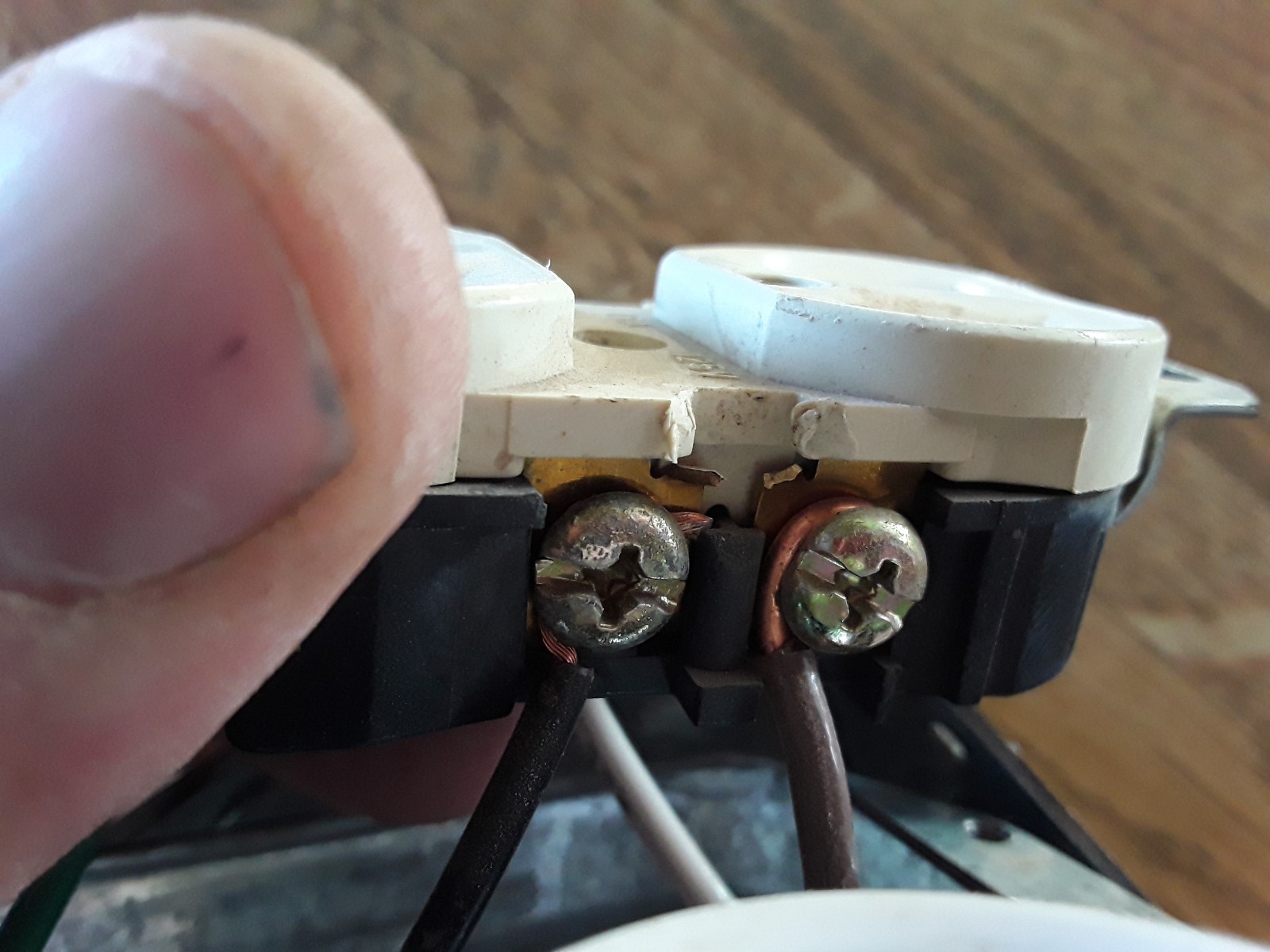

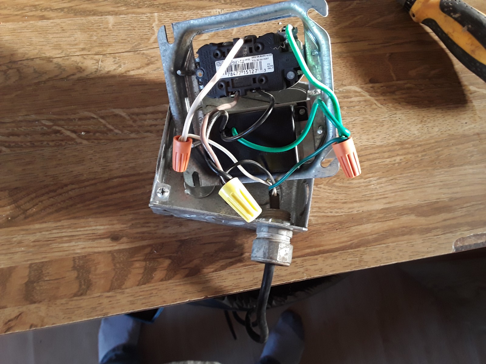

It is constructed with a standard receptacle and a light dimmer. The top half is straight 120v for a dremel, light or similar tool. The bottom half is regulated voltage that I plug the soldering iron or transformer in to. The receptacle is split by breaking the tab in the middle that connects the top and bottom halves on the hot side.
Attachment 26343
