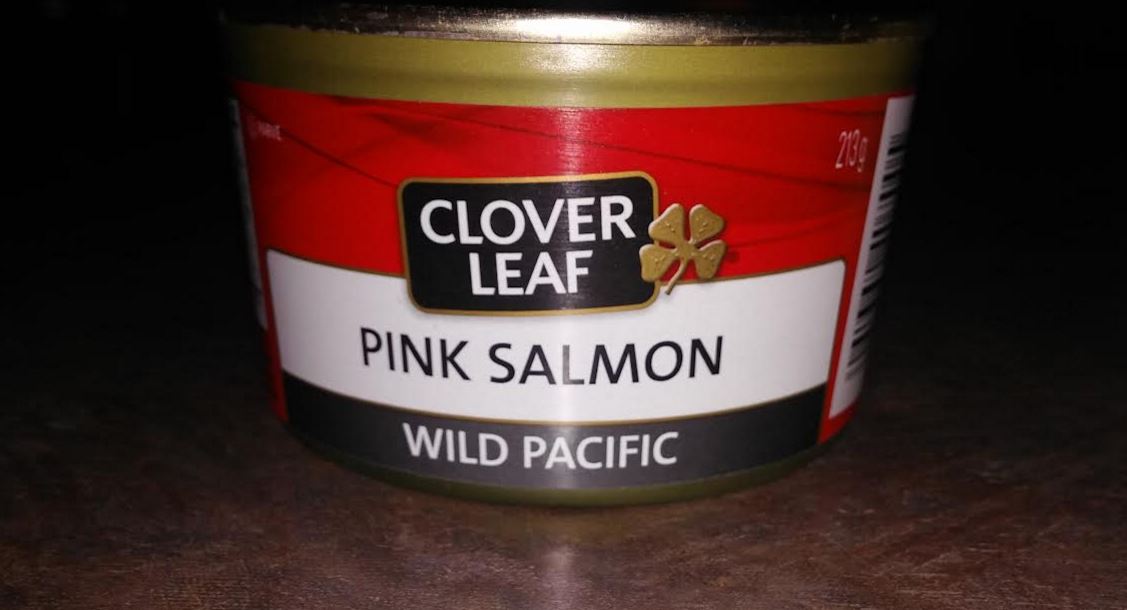

Here are a few pictures of a spill free container
that I build for my shop . I forgot to take a picture before
soldering everything but there is a rare earth
magnet in the container. It stay on my lathe tail stock with cutting
fluid in it Enjoy:lol::lol:
I like this size container
Attachment 7859

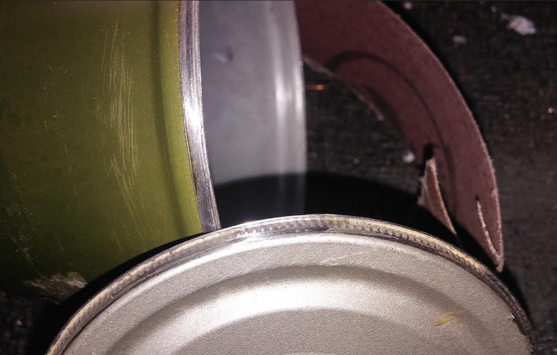

once empty and clean you must sand the edge before soldering

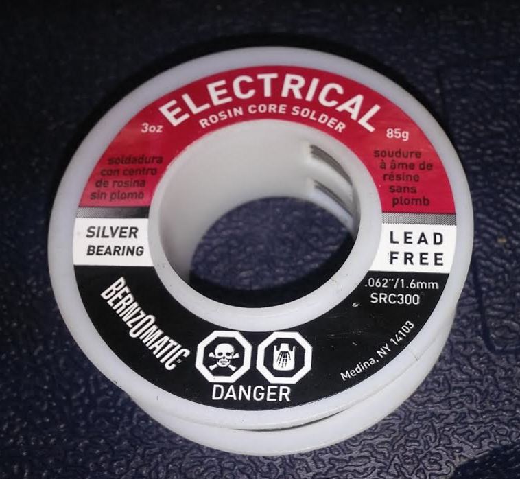

I used .062 solder make the job easier

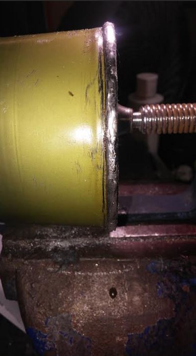

I then hold everything rite with a C clamp and solder the joint

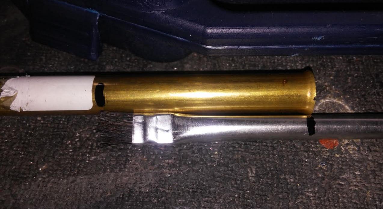

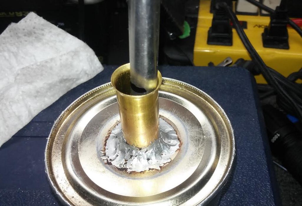

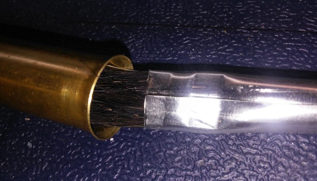

then I find a small brass tubing to fit my brush
Attachment 7863

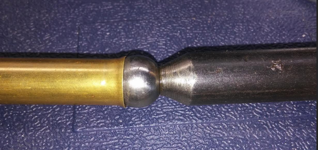

I use a damping punch to make a nice flare
stop my brush from shredding
Attachment 7864

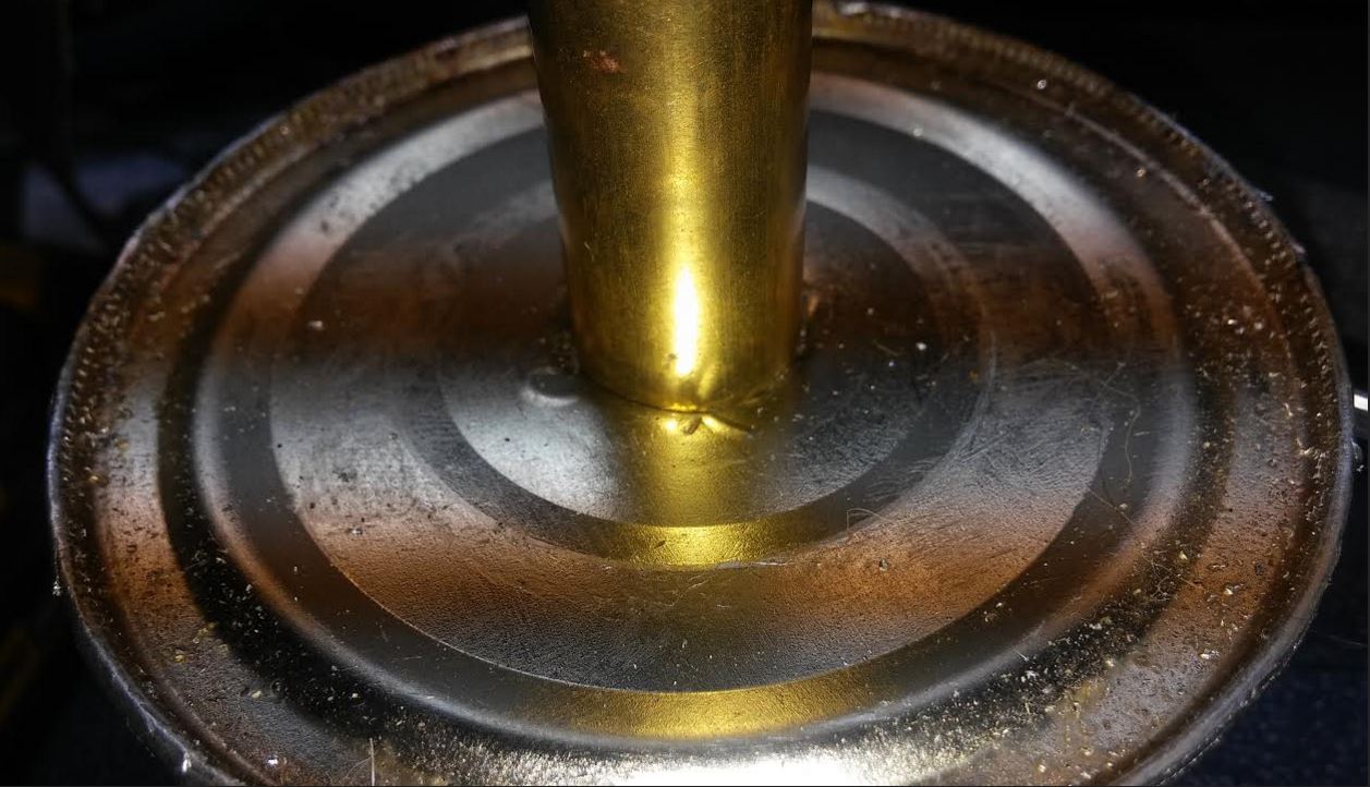

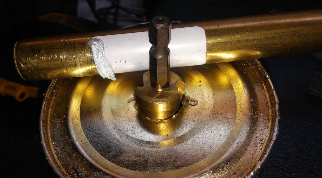

then I make a hole as close fit as possible
Attachment 7866
Attachment 7867
I then mark how long I need to cut the pipe, it's push all the way to the bottom.
Attachment 7869

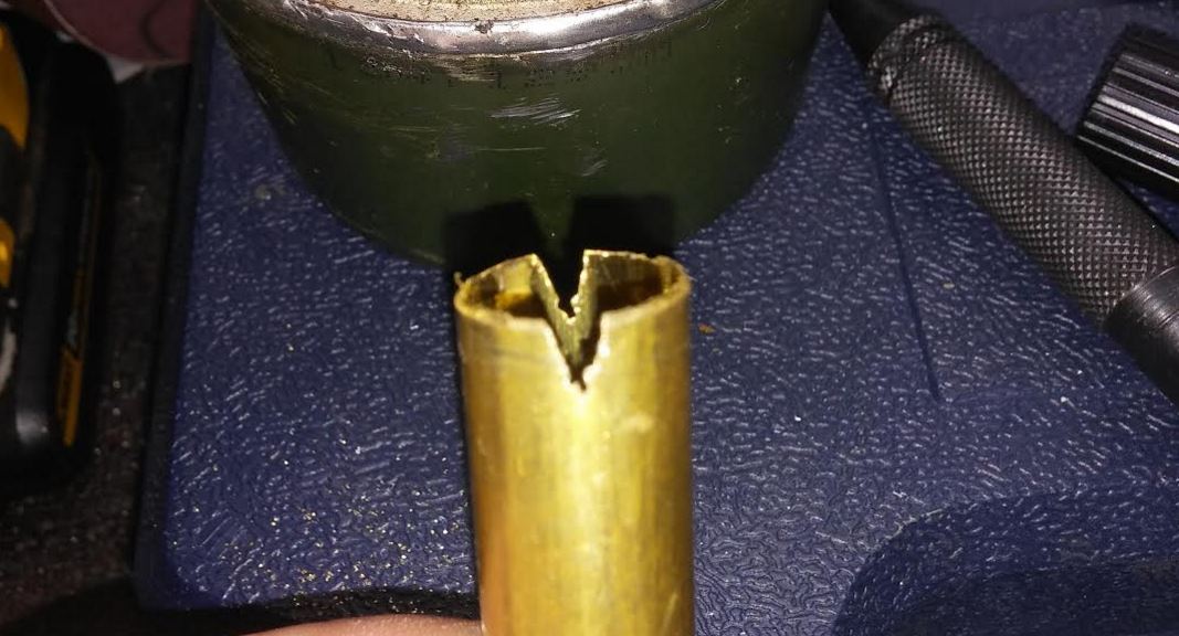

on the other end I make a small V with a file
Attachment 7868

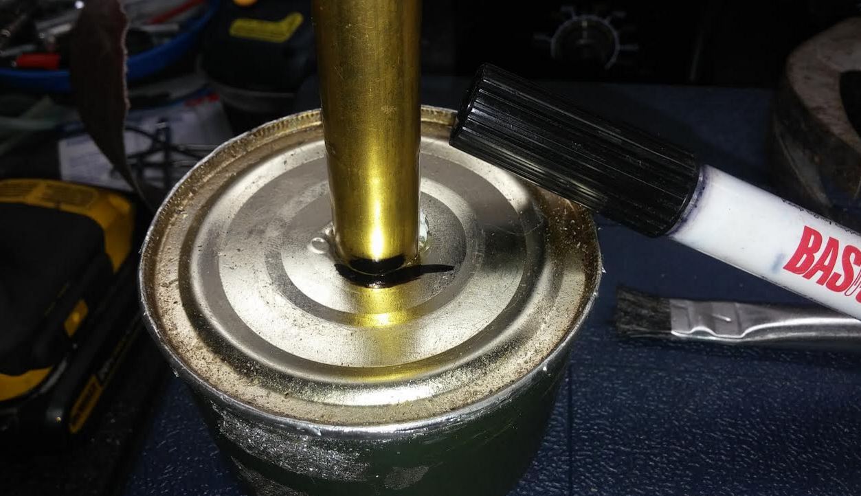

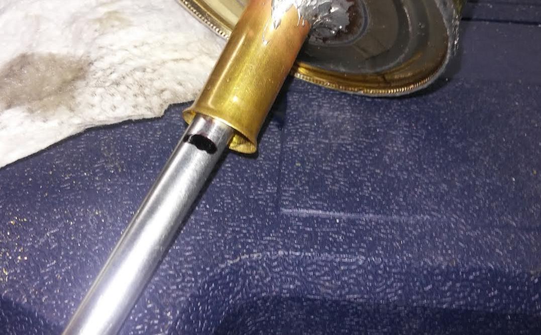

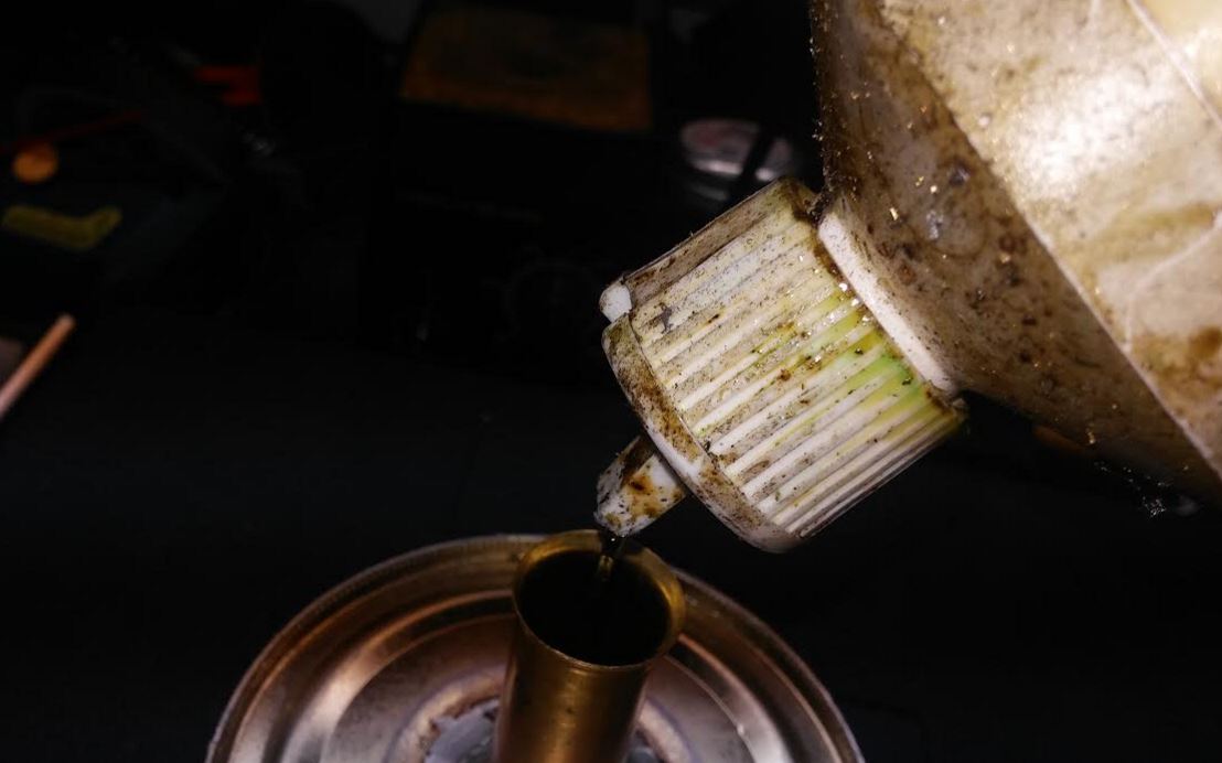

then I solder my pipe as straight as possible and fill it to about half
Attachment 7870
Attachment 7871
and Voila you can flip this upside down if you wish and nothing will come out:hattip:
Attachment 7872
enjoy
