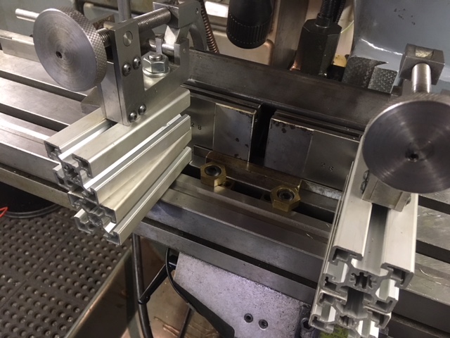

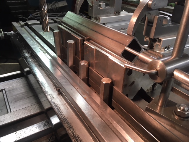

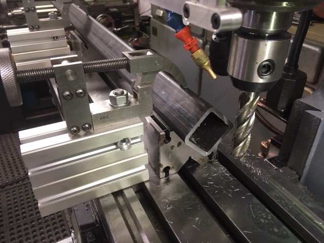

Hi All
I was making a toe lift from some square box section today and wanted the ends to be machined This was to aid the welding in getting everything upright and square.
I did a sort video on the technique I use and hope some will find it useful for their own future projects.
https://youtu.be/e-DEWS1hdiQ
Milling box section direct in vee blocks, for alignment of vee blocks please see:http://www.homemadetools.net/forum/m...make-use-67263
Attachment 23080
Attachment 23079
Attachment 23081
Using a machine stop to cut several piece to the same length
