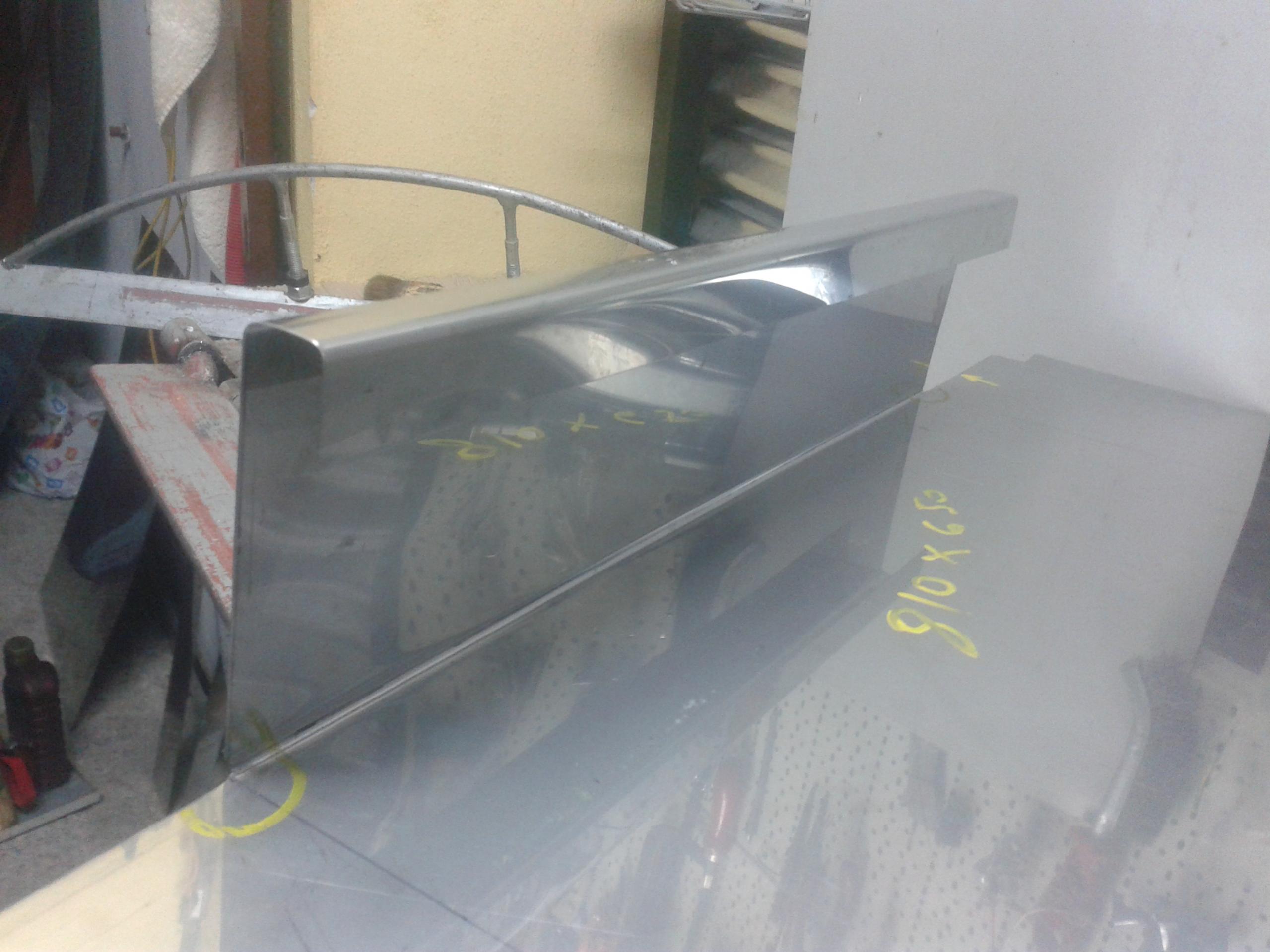

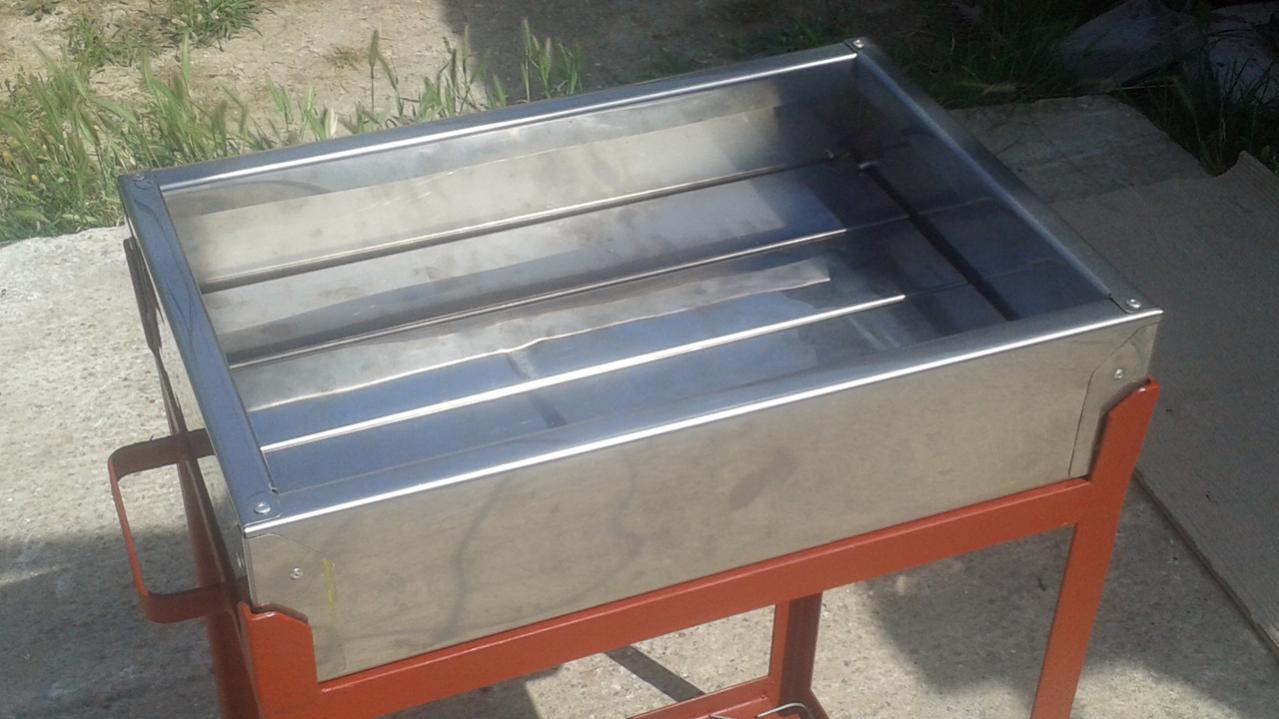

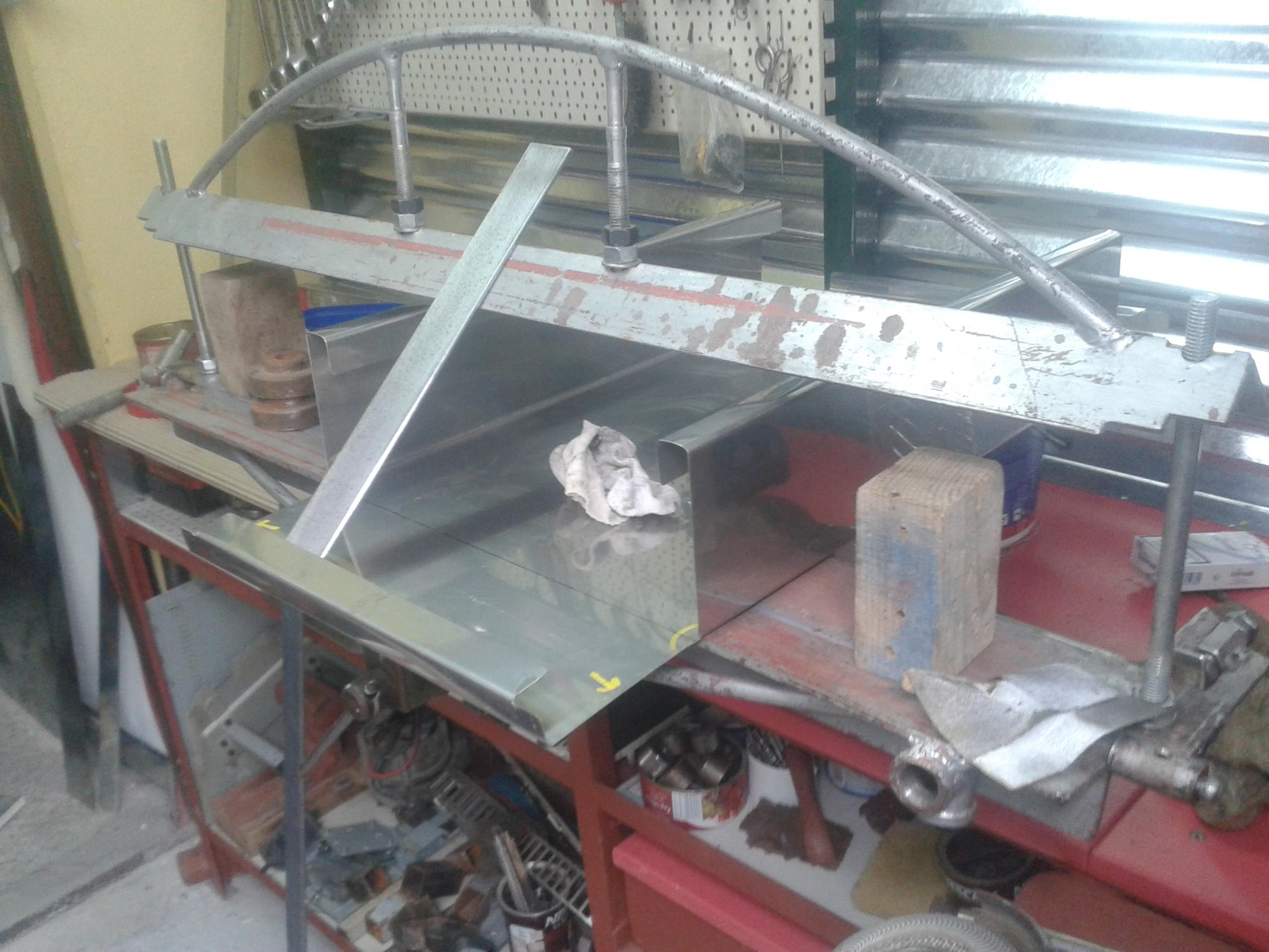

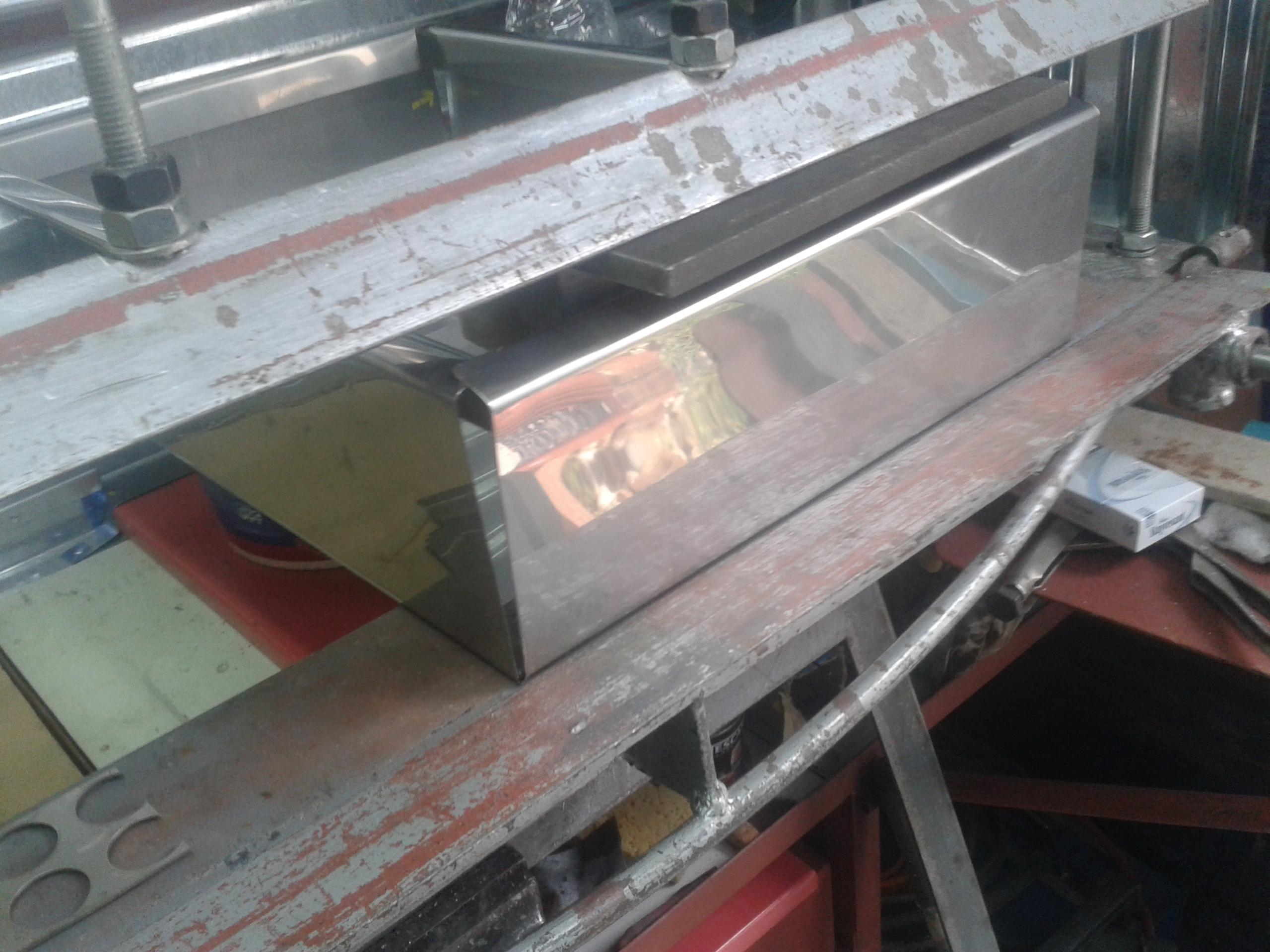

Stainless Steel Barbecue with double layer bottom
340x500mm Stainless steel (AISI 304) BBQ with double layer bottom.

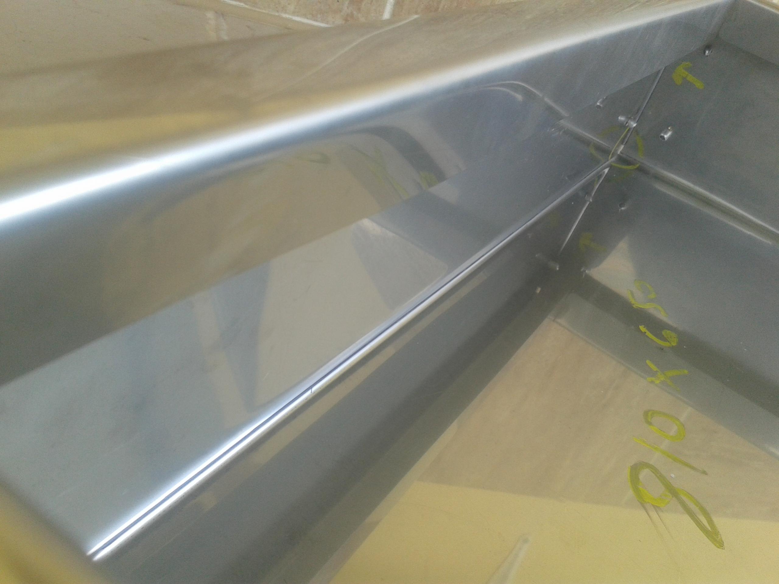

The second layer protects the bottom from
overheating, dilation, deformation,
and reduces the loss of the heat.
materials for BBQ

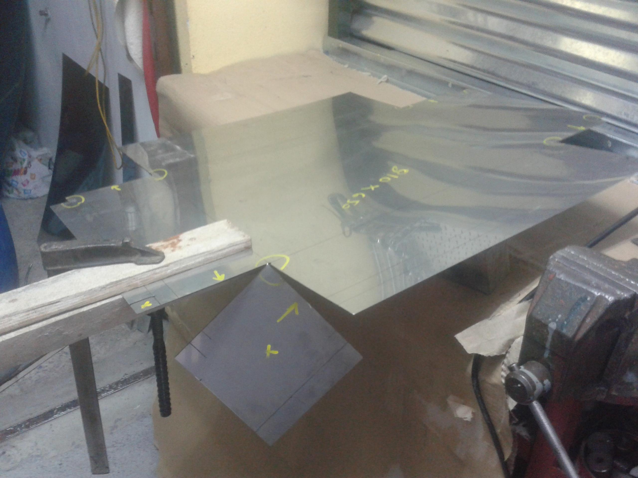

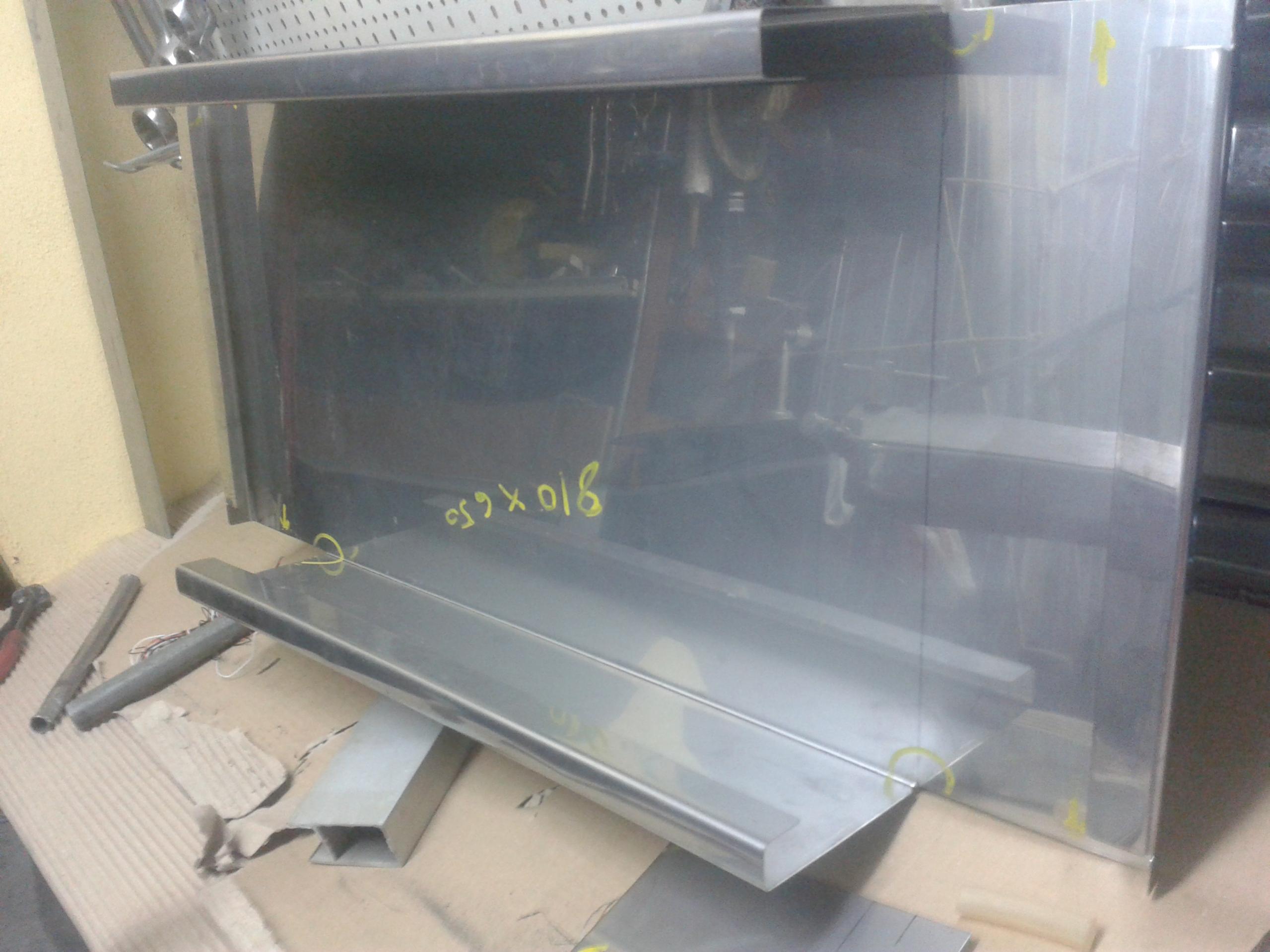

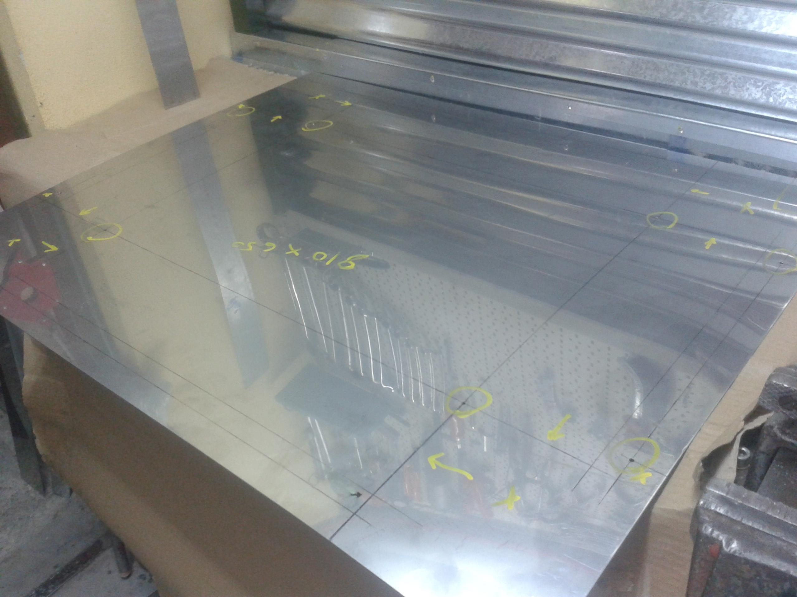

Sheet metal AISI 304
1pcs 810X650mm thick 0.7mm
4pcs 490x140mm thick 0.6mm
The thickness of the material that I have use, isn't one way root,
you can use thinner or thicker materials as you like.
20pcs Rivets 4mm
materials for stand
Angle iron 30x3mm about 6m
2pcs 508mm
2pcs 348mm
4pcs 600mm
4pcs 60mm
2pcs 448mm
2pcs 288mm
Flat bar 20x3mm
2pcs 250mm
Attachment 11347 Attachment 11348 Attachment 11349Attachment 11350 Attachment 11351 Attachment 11352Attachment 11353 Attachment 11354
