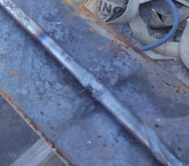

Sometimes I need a longer brill bit

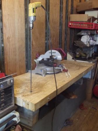

Today was one of those times. I needed to frill through a 2x4 laminated table plus 2 6x6 s and 1/8" steel to mount the table in my machine shop van

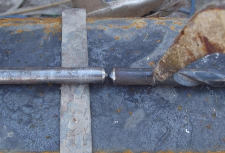

I torch welded a 36" piece of 3/8" 1018 round rod to a 13/32" bit
I only needed a bit about 18" long but if anything is worth doing it is worth over doing, besides I can always cut it off later.
After grinding both pieces to a point
Attachment 8781
I welded them together with a torch with a slightly carbonizing flame IE a long center feather instead of a shorter oxidizing flame
the filler was a 1/8" 7018 rod with the flux removed

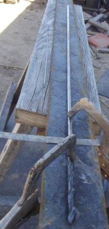

Attachment 8782
I kept the torch on the weld area slowly allowing the weld to cool as I moved the torch farther away
Attachment 8783
As you can see the bit is plenty long
Attachment 8784

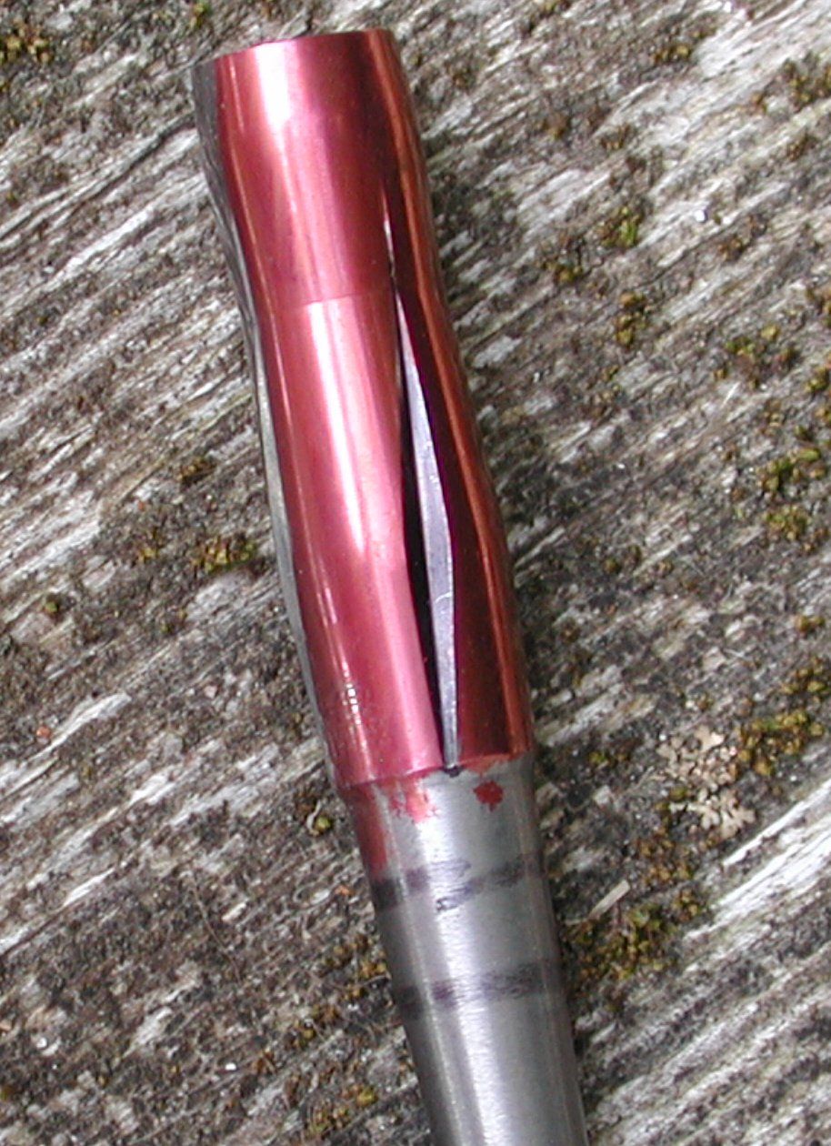

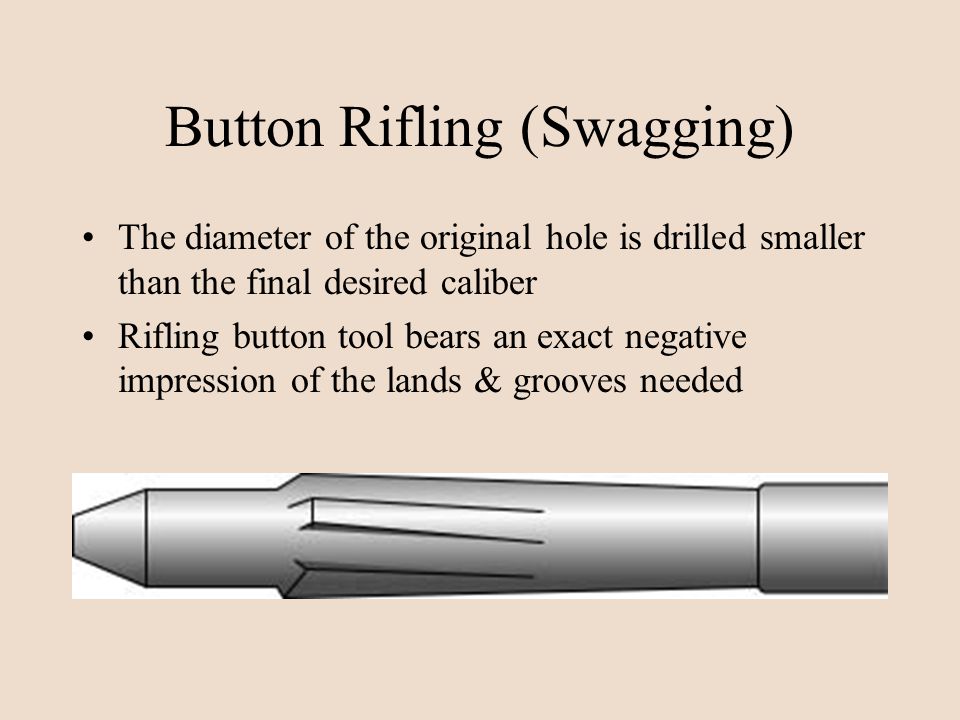

Attachment 9903Attachment 9904Attachment 9905Attachment 9906love it I will need to make one for my rifling button project could use some help on it you game
Not to dissuade you, but button rifling is a bit more complicated. 1st; you asked about a broach. For this type of cut, it is a cutter with multiple radial teeth. They each 'scrape' a small bit of material, with an increase in tenths [.0001] from the starting end. It requires accurately sized and straight bore. It would take a 'set' of them, each with an un-toothed section to engage the previous cut and rate of twist. 2nd; A button is carbide, which requires specialized grinding equipment. Neither a practical project.
Best solution is a hook tool. They go back centuries and certain 'cut-rifling' barrel makers still use them. The bore-riding portion has a slot and adjustment for the cutter. It carries the cutter as being pulled through bore. Twist is regulated by the rifling bench. A pass is made in the first groove, rotated around to each groove one cut at a time. It has a wedge to increase the depth for each cut. .003 depth per side would need about 30+ minimum passes in each groove. The best barrel makers including Colt, Pope and others could control size so well the result was a very small taper - larger at breech than muzzle - to compress a lead projectile gently for the greatest accuracy. The debate goes on which method produces the best barrel. Cut rifling has the sharpest grooves and lands. Button barrels have the smoothest surfaces, burnished by the button, and easier to clean. Cut is great for lead, button barrels are good for jacketed bullets.

I have not commented on the rifling button Idea because I feel that anyone attempting to make a button is first going to have to create a very special tool grinding fixture as well as have a very high precision grinder and the skill set to create these buttons.
in general rifling buttons don't actually do much in the way of cutting the groves in the barrel as much as they do more to finish the bore to a smoother rifled state after the groves have been cut. Using the button alone to rifle a barrel method works better in the shorter barrels of handguns.
