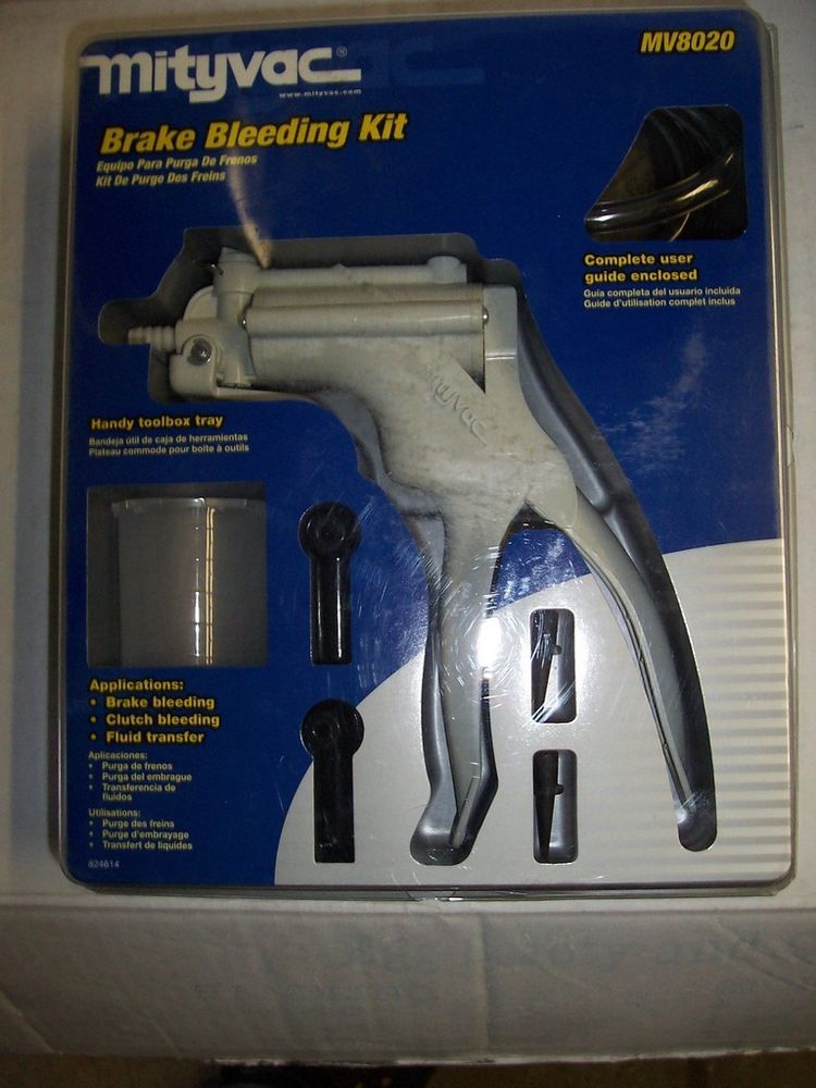

I have one of those pistol vacuum bleeders that works so-so on some systems. for bleeding the brakes on say a 3 axle trailer it works great. I just start at the farthest eel cylinder away from the master cylinder then work my way forward. One tip though is I found it helps to completely remove the bleed valve then coat it in bearing grease then screw it most of the way in the grease helps to pull a cleaner vacuum.

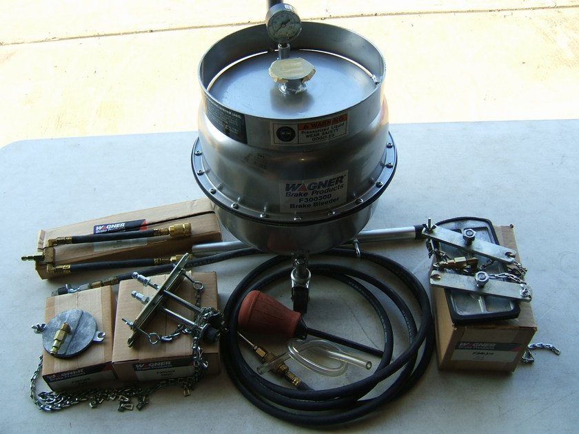

On cars with drum rear and disk front with the older pop out proportioning valve I've never had any problems bleeding those brakes. newer vehicles with ABS I have used a "T" and connected both rear bleeders at the same time cars old enough to have single master cylinders I just open all 4 bleeders and attach a hose at each one and let them drain into a bottle for several minutes to half an hour letting gravity do the job, keeping the master cylinder full. My preferred method is to use a positive pressure bleeder strapped to the fill hole/s' of the master and at the same time use a pistol vacuum when necessary.
New vehicles with 4 wheel anti lock disk and those with electronic automatic braking are just about impossible for an individual to properly bleed 1 valve at a time.
This is similar to my pistol unit
Attachment 22971
I think mine is an Ammco and I need a new bladder for mine that is if I still have it
Attachment 22972
