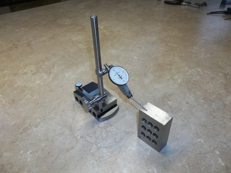

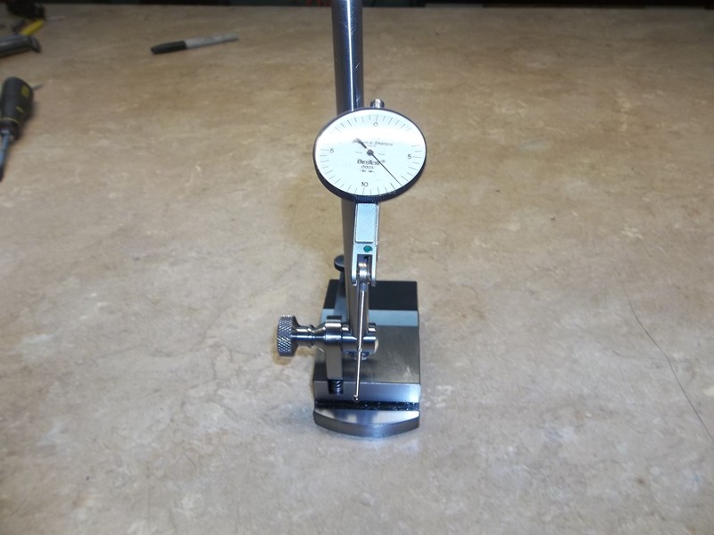

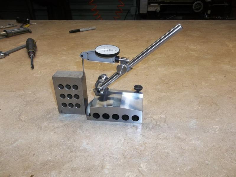

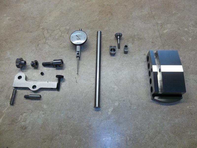

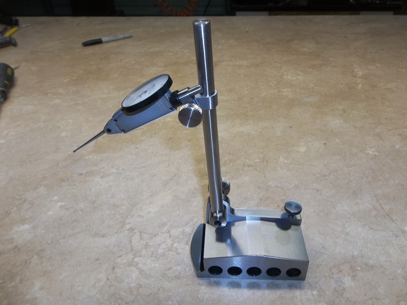

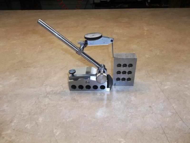

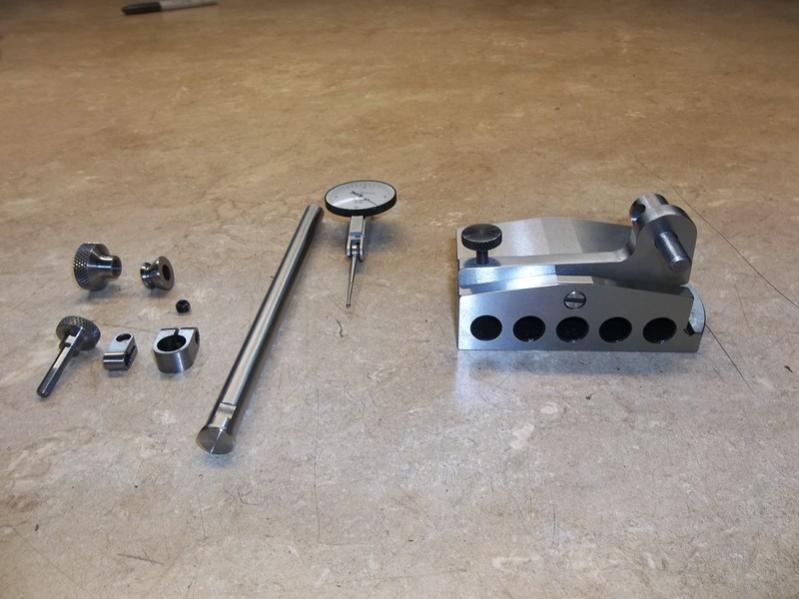

I built this gage to use as a primary height and square gage, not as a surface gage, I have dedicated surface gages but I wanted to have a dedicated gage just for checking square and height.
There is a radius machined on the front of the base just for checking square, some people machine a slot in an old surface gage, Install a piece of steel in that slot then hand grind a radius on the piece. I chose to incorporate that as part of the tool.
The spring under the pivoting arm was made from a piece of .055" music wire wound on the lathe at 12 coils per inch. The only thing I didn't make was a 1/4-20 set screw which secures the 7" stem to the pivoting arm.
The entire gage was made from O-1 tool steel, except for the 7" long stem which was made from 316 stainless steel. All parts that were flat was hardened and ground, all parts that were round was hardened and polished.
Below are some photos
Thanks for looking and happy machining
Doug
Attachment 1997
Photo before assembly
Attachment 1998
Another view before assembly
Attachment 2000
Assembled
Attachment 1999
Another view after assembly

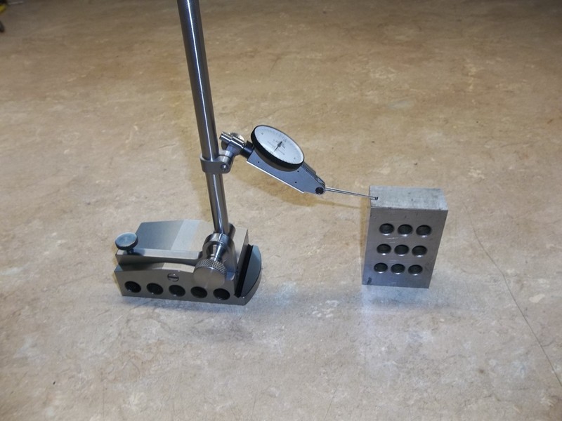

Attachment 2005
Using it for checking square
Attachment 2006
Another view of checking square
Attachment 2007
Using it as a height comparator
Attachment 2008
Another view of height comparator

can you take a regular surface gage and put it on a rotary table and put a radius on on it, and what radius did you use?
I don't see why you can't, the radius I used was 1/2 the width of the surface gage
